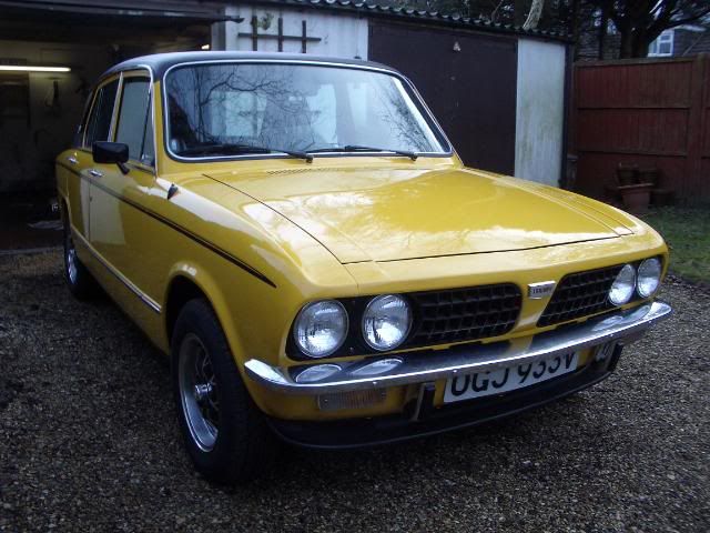

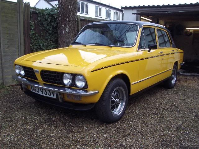

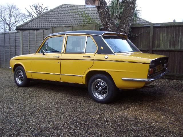

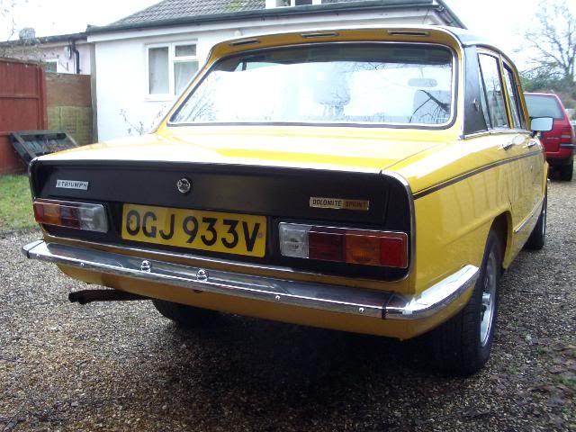

All done..I think! :) Only taken me a year.. :roll: Just the final hurdle of the MOT, which I hope will go smoothly with not too many nasty surprises.
A few before and after photo's..
Looking at the rear pic's, I might well of put the rear bumper irons the wrong way up..do they angle up or down? :? Easy to rectify if I've got it wrong.. :)
Very 'appy with it.. 8)
