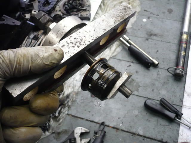

The cage got left behind when I extracted the water pump so fashioned together an extractor. Worked a treat. Rebuilt the waterpump with all new parts. Now in place with cover fitted.

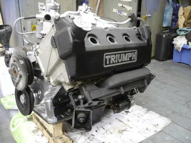

Block now painted and assembled with new core plugs, all new bearings and thrust washers. Honed the bores as well. New rear crank oil seal, backplate repainted and put on and new seal in front cover. Flywheel also now on.

The engine is now done bar some new plug tubes and engine mounts which will be ordered for this coming week. The O/D box has been cleaned up, new thrust bearing fitted ready to be mated to the engine tomorrow. If it wasn't for the mounts it would have all been in the car tomorrow.

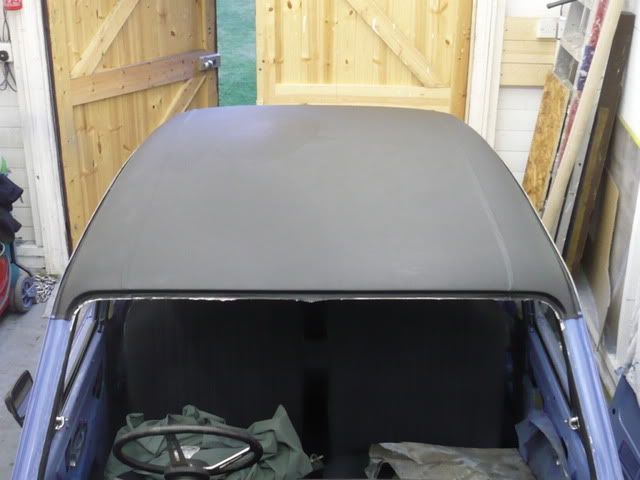

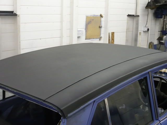

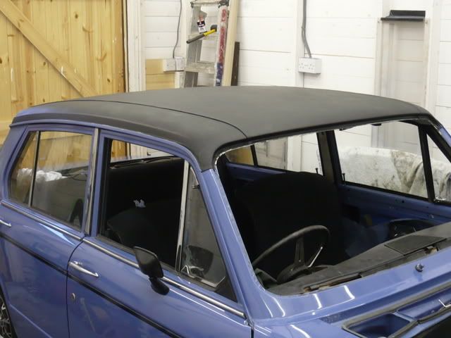

Now I didn't mean to do this tonight, in fact was going to sub it out, but started cleaning the roof in preparation of giving a go tomorrow night, and got carried away but I'm so glad it's done. Had been dreading it. Lets hope it still looks as good tomorrow.

Roof looks great Derek, really nice job.. I like French Blue more every time I see new pics of this.

You've done a brilliant job of the roof Derek. Did you have any help?

On my todd Mart. Bit scary, but looks to have turned out kind of OK. Time will tell I guess. Not a job I'd rush to do again in a hurray.

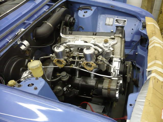

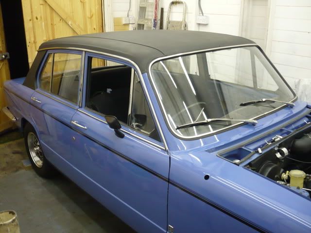

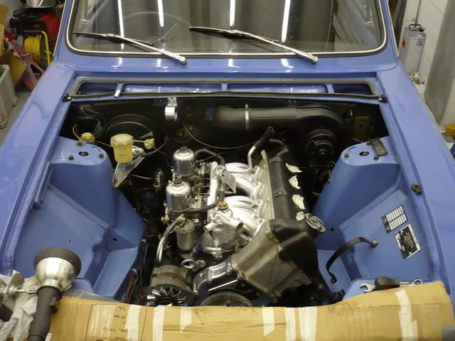

Got a bit more done over the last couple of evenings. C pillar vinyls now on, gutter trims, both screens now in and wipers on. Just waiting for some new chrome trim clips for the rear roof chrome and the back end is finished.
New crossmember and engine mount bushes arrived so I also got the engine and gearbox (exhaust bracket fitted, thanks Rich) in tonight. Starting to look like a real car now.
