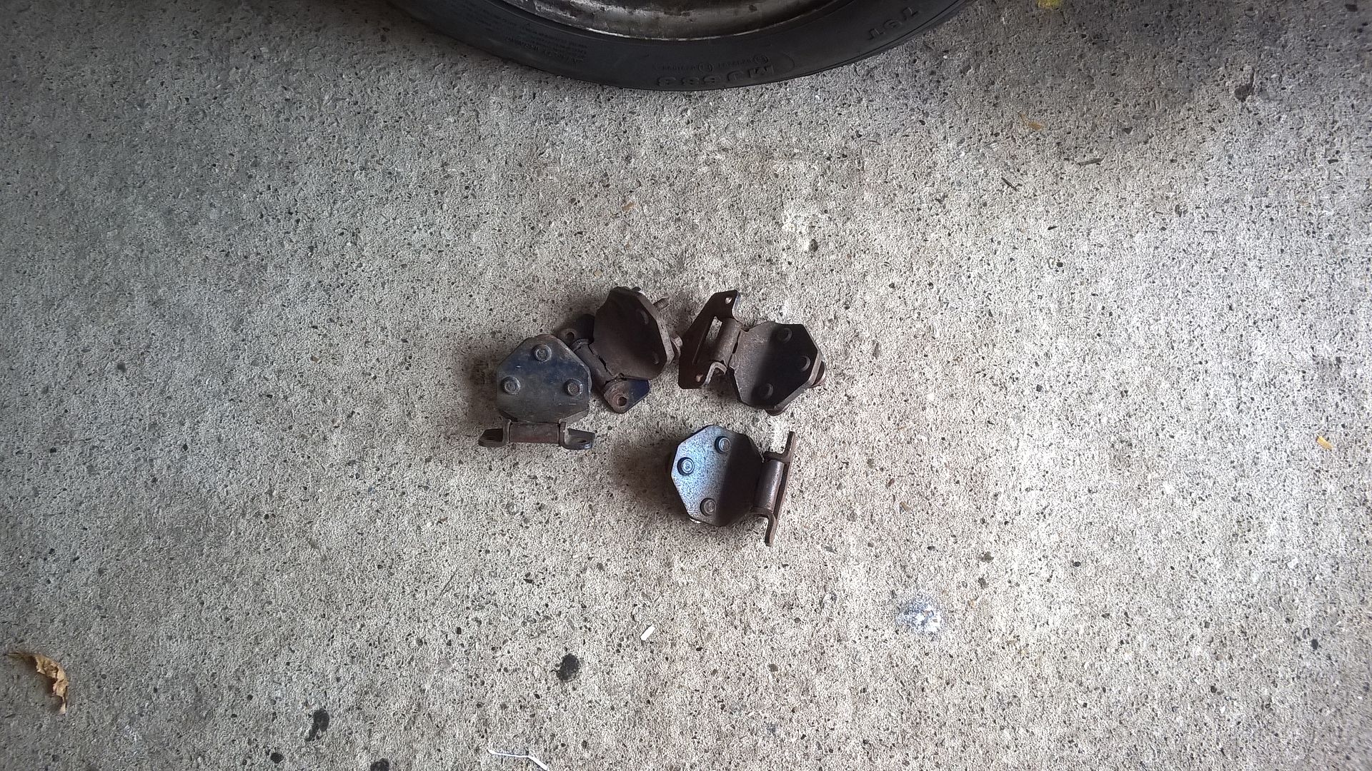

I went up into the loft and I dug out my front door hinges.
All these came off my Sapphire 1500fwd (GGN 573J) so they're suitable for what I need. I need to free them off so I can see if they can be used. I just hope that I can remove the old hinge with the door in situ. I'd rather not take the door off if I don't have to.

I got the hinge fitted but it was a pig of a job.
I gave the hinges I dug out a soak in PlusGas. I tried to take out the parcel shelf to get to the A post panel and had most of the bolts out before I realized that I could get to the nuts for the body side of the top hinge once I'd removed the ducting for the offside fresh air vent. I dropped a few things during removal down the inside of the A post but I was able to retrieve them from the bottom. I had to loosen the bolts on the bottom hinge to get myself a bit more room to get the top hinge out. Once I'd got the hinge in the door needed adjusting and I've got it as good as it can be. At least the door doesn't drop down when I open it and it closes better than before so that's one job crossed off the list. One advantage of trying to remove the parcel shelf was that I was able to have a sort through the junk that had accumulated over the years and it is looking tidier now.
