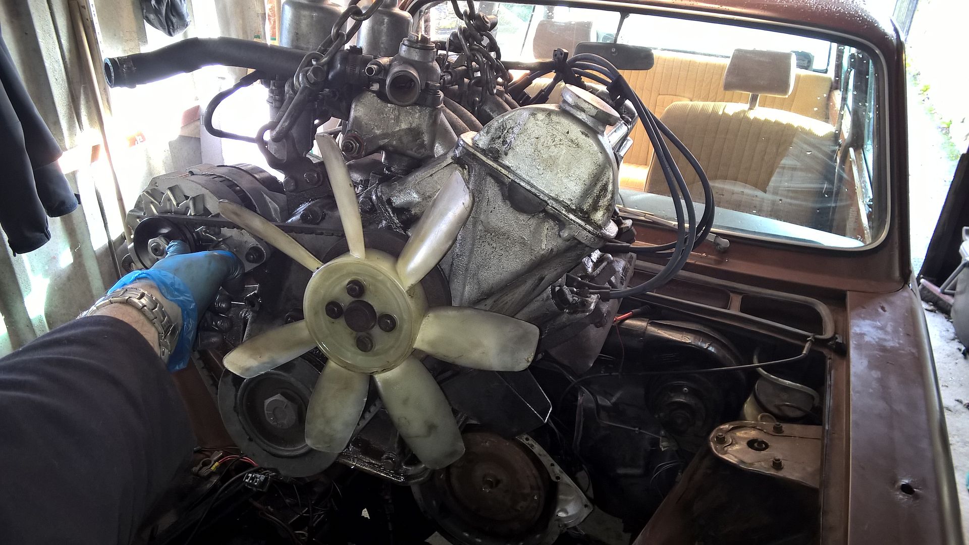

Why did you pull the converter out with the engine Dave? Besides the fact that it makes the engine longer and heavier, it means you will have to realign and refit it in the trans, not to mention the possible damage from misalignment on removal! Its only 4 bolts FFS!
Re: NYE 751L - 1972 1850 auto
Carledo wrote:Why did you pull the converter out with the engine Dave? Besides the fact that it makes the engine longer and heavier, it means you will have to realign and refit it in the trans, not to mention the possible damage from misalignment on removal! Its only 4 bolts FFS!
I thought that too. That is never the way to pull an engine from an auto. Box and converter stay together at all times unless the box is being stripped!. I dont expect the front seal in the box to be any good now looking at that angle on the crane.
Not to mention the loss of fluid...

With a decent crane like that I would swing engine and box together and separate them when out of the car.

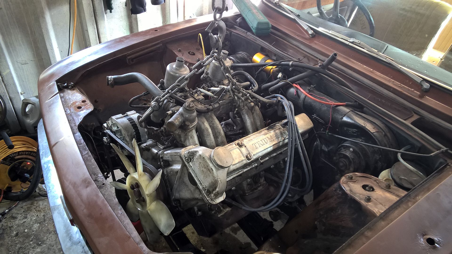

Don't worry! I didn't strain the input shaft. As soon as the engine was totally free, it tilted back which is why it was at an angle when I was lifting it out. I did lose a bit of transmission fluid. I'll be checking the level once it is up and running again. I fitted the torque converter on to the input shaft as soon as I'd unbolted it from the driveplate.

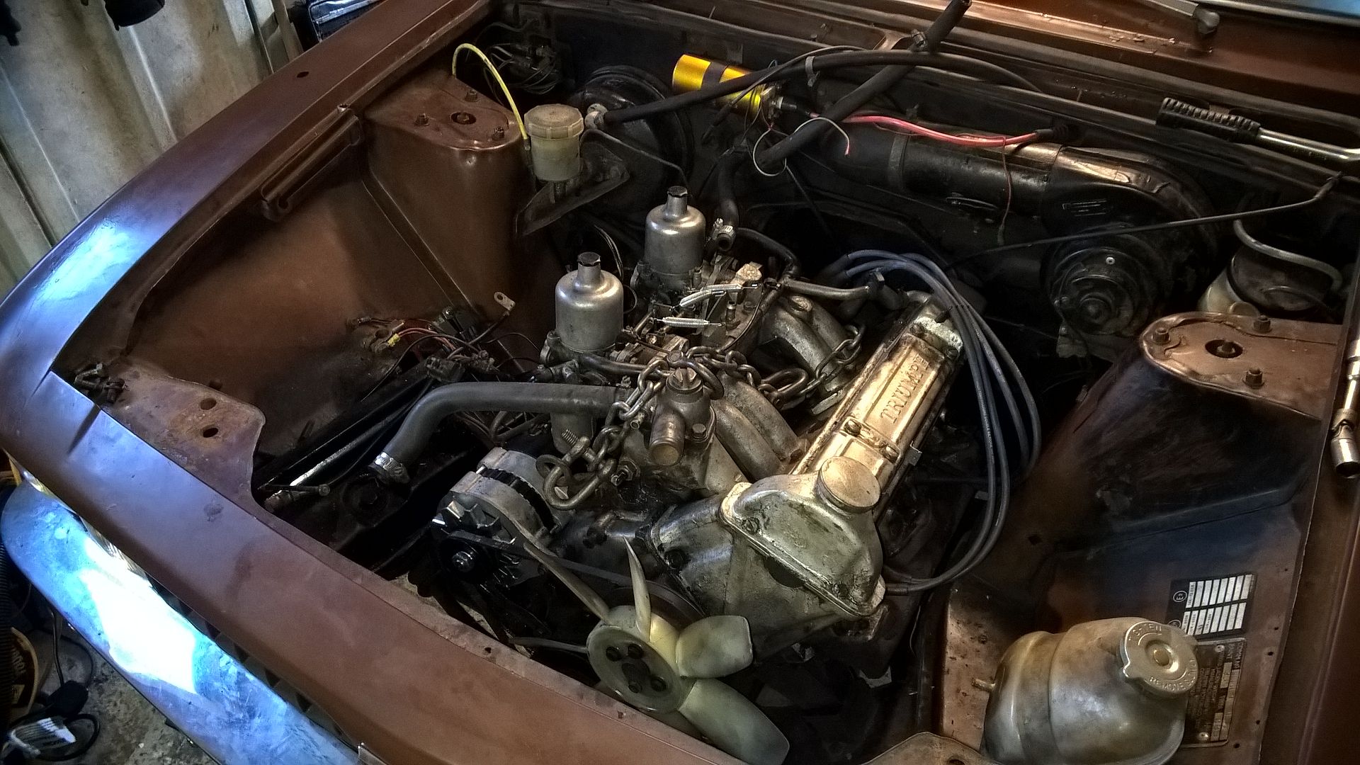

Today I torqued up the bolts for the drive plate (45 lb/ft, the same as for the flywheel) and then the engine went back in. I managed to get it level going back in and with a trolley jack under the transmission I was able to reunite the engine and transmission without too much trouble.
I've got a couple of bellhousing bolts in to keep the engine and transmission together, I've connected the throttle & downshift cables, I've refitted the radiator, fitted the hoses (I replaced the clips for the top hose), filled the cooling system, connected the oil pressure sender, connected the electronic ignition, connected the multiplug for the inhibitor switch, connected the coolant temperature sender and connected the alternator multiplug.

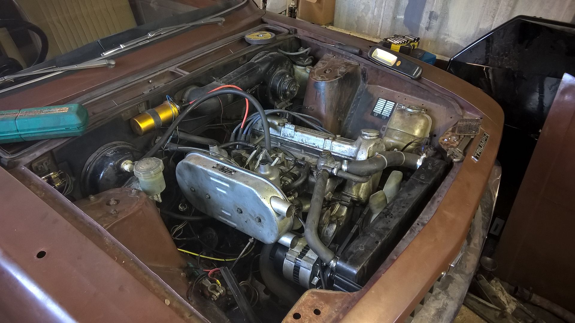

I got everything connected back up and when I first started it up there was a horrible noise coming from the torque converter. I checked the bolts and they needed tightening up a bit more and it has cured the problem. The starter seems to be struggling so I'm wondering if I've not tightened something up fully. The top bolt was an absolute pig of a job. The only way I could do it was to put the bolt in from the front. The car is driving fine but there's a knock from the exhaust so I'll need to check the bracket at the rear of the downpipe. It just needs a bit of adjustment to pull it away from the chassis leg. With the car out of the garage and back home, I decided to fit my speakers.

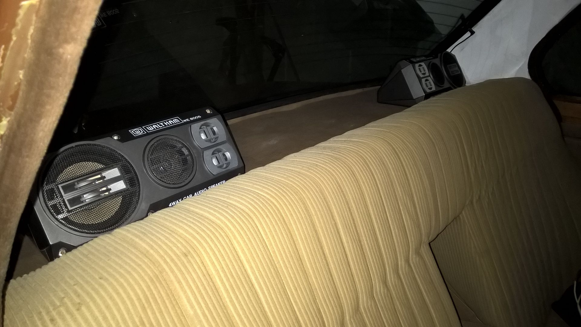

I got one of them working but I ran out of speaker wire so I'll have to get some more to finish off this job. I've spent the last 3 days working on this car so I might not bother doing anything tomorrow. I think I've earned a well deserved rest.
