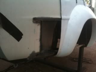

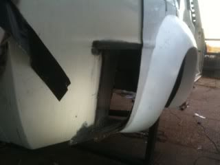

Re: My new track project
Rear brake cooling, or an aero tweak?
Hit it.
Hit it.
I was thinking rear brake cooling, looks awesome whatever it's for!

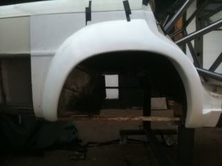

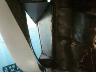

LOL Thought that would provoke some replies
The reason i have done this is when i got the thing up to quite a high 187 mph at bruntingthorpe
where i bottled out as it was becoming quite unstable ,
It seemed to me that the rear was starting to lift
Now i think this may have been quite a lot of air pressure in the axle and wheelarch area
So to alleviate some of this pressure i have cut these ,
From the side of the car its not too obtrusive to the eye but i suppose only paint will tell .
I have removed most of the boot floor for a diffuser ,the exhaust will be just below the boot lid ,
The underneath of the car will be plated with alum
I have also done the same sort of modification to the front wheel wells and will do something very simlar to the front wings ,I have some very nice vents for the wings taken off a car no longer in production and Very hard to get now and they look the dogs, but they do actually work
I really dont want a rear spoiler as it would have to be like the bunkas car to properly work,
The carbon roof has vortex generators along the rear edge to alleviate potential shock stall as the air leaves the roof as the rear widow doesn't help at all !!!! ,
Also which the picture doesn't show its a nice sweep to the panel where the air exits and not a square edge,
I will show all the carbon panels when i am happy with them and have completed them all,
