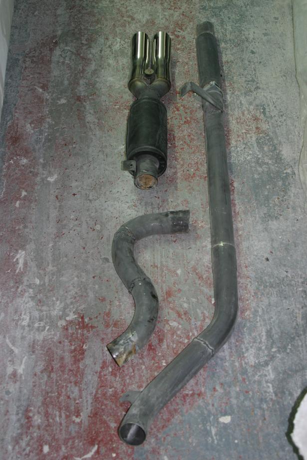

So, a quick question for everyone albeit a silly one: What do people think on side exits exhaust for the sprint?
Reason i ask is i bought a custom made system on ebay for the sprint but it seems that the previous maker of it cut the boot floor so that it could fit. This seems a bit mad to me as making an exhaust wouldnt it easier to cut the exhaust and weld shape etc. Anyway, with me being in a rush now i thought it would be alot quicker to fit it as a side exit. I would love the look of the big tailpipes coming out of the rear but do not have the time to remake it all up rather than cutting the boot floor.

Cheers guys, what about coming out of the side but more to the front, roughly at the end of the front door? Just a thought, i'm trying to do the quickest most simple thing possible at the moment...

Yeah that's what i had in mind, but passenger side maybe? Cool car, nice pics too.

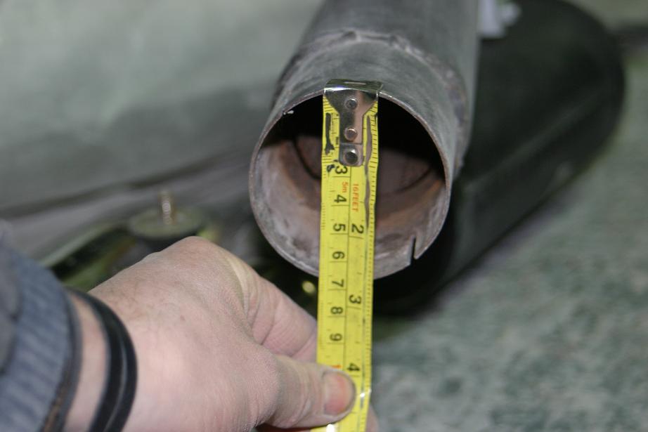

By the way, it's 2 1/2" using Jetex boxes. I originally had one silencer running at an angle under the driver's seat. LOUD! It passed the MoT, but was around 100dB at idle, and 114dB at 3500rpm. I now have 2 silencers. The pipe turns under the passenger seat then back 180deg before the sill. There is a medium silencer under the passenger seat, then straight into the large silencer under the driver's seat, before exiting under the driver's door. The sill was cut and shut (before I bought it) to make space for the exit pipe. A lot quieter with 2 silencers. 90dB at idle, just over 100dB at 3500rpm.

#149 Post by johnnyv1 »
This is the exhaust in question (minus the downpipe its on the car), its a 2, 1/2" aswell, it does have a second silencer although it looks minimal, the end tips look huge. I could put it either side i suppose, just worried about if it will bottom out on the road that much, thats not even thinking about all the speedhumps where i live. :(
