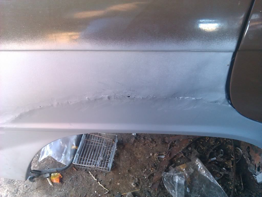

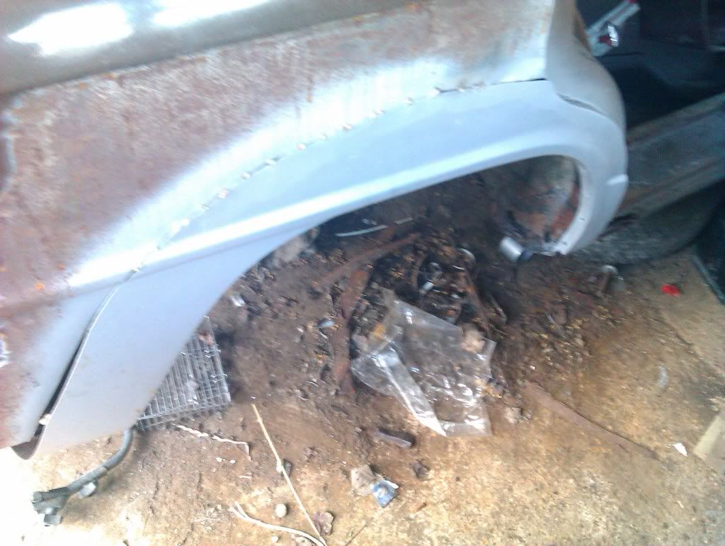

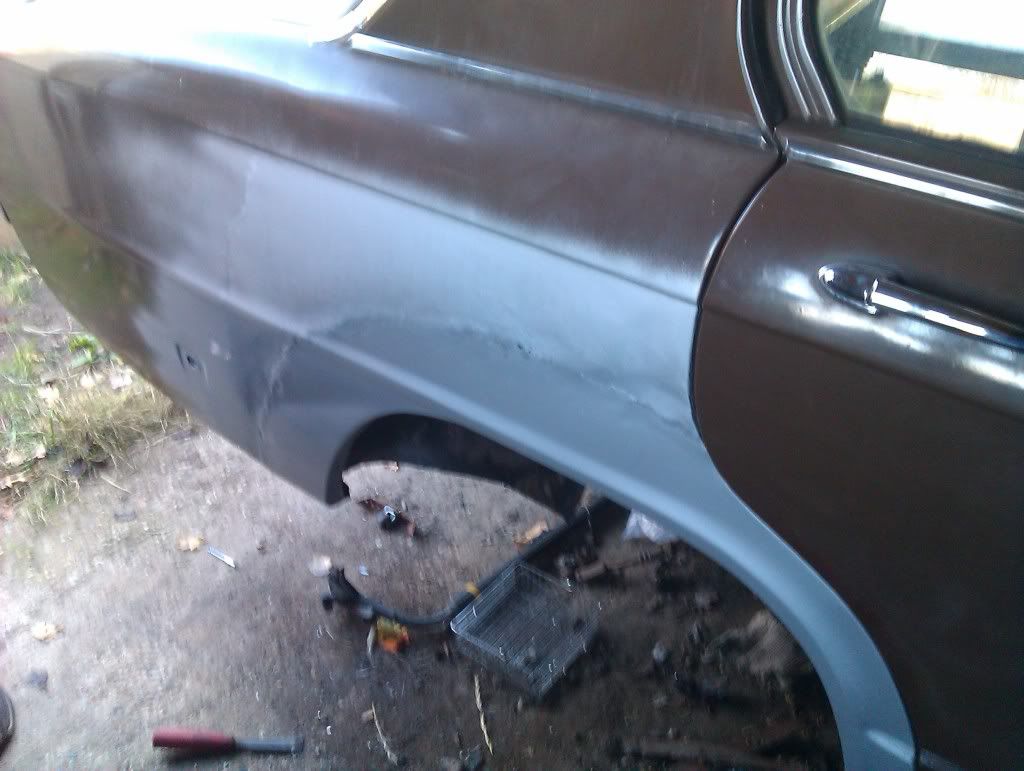

I thought it was about time I got off my lazy back side and get some work done, a guy that was helping me weld, I haven't seen since January. he started to repair the off side rear wing, with a repair panel.
Today I thought sod it, if I want to use my TC I need to learn to weld, he had shown me some bits, so off I went and started welding 2 pieces of metal together with my mig. After an hour, I thought lets have a go on the car so heres the pics the 1st one is how the arch repair panel was left.
The rest is what I have done today and i'm quite chuffed, and it's bloody strong too :lol:
Some nearside pics :oops:
And after 5 hours work today, this is how I have left it, til next weekend, I'm so glad I jumped in at the deep end, I had to for my own confidence.
Any thoughts or tips appreciated

I have to say that I admire you enormously for having the courage to pick up the welder and have a go. Something I could never do.
The results do look as though you need to grind those welds flat though. :wink:

:oops: I thought I would give it a blast Alan, I've got to weld new metal into the inner, this is why I thought I had to do the outer so I can match up with the lip.
Hopefully As I grow my technique, I can get some more confidence in the mig.
The welds have now been flattened, there's a few small holes to fill, but the pics don't really show it will only need a slither of filler to blend.
I'm more worried with the rot at the bottom of the rear "D" pillar on the off side, i've really got to step up to the plate and make a repair panel which i'm dreading.

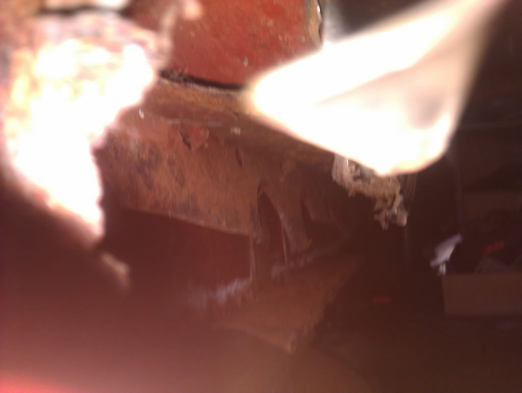

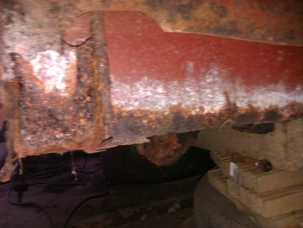

Started to take of the old underseal from where the rear axle goes, no welding needed at the moment from the off side to the centre, such a pain in the bum job.
It was going good until my heat gun decided to go on fire :oops: , after a lump of under seal went in.
Need to get a new wire brush for my grinder. That should soon get it off.

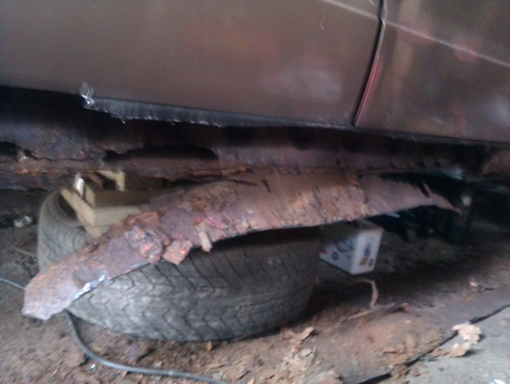

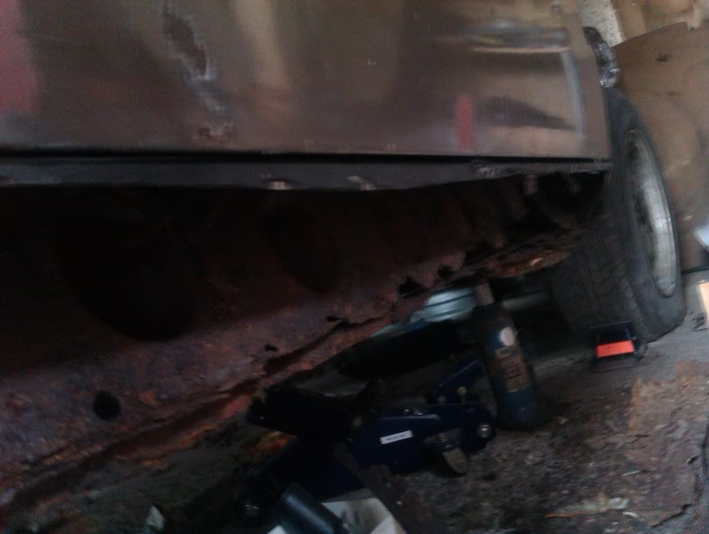

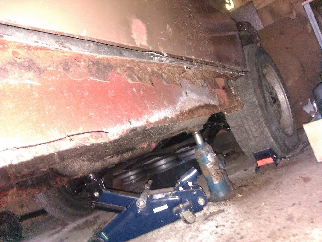

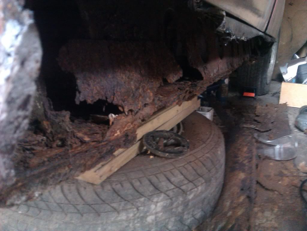

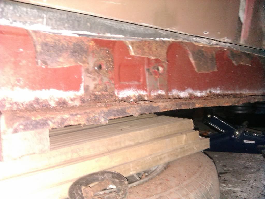

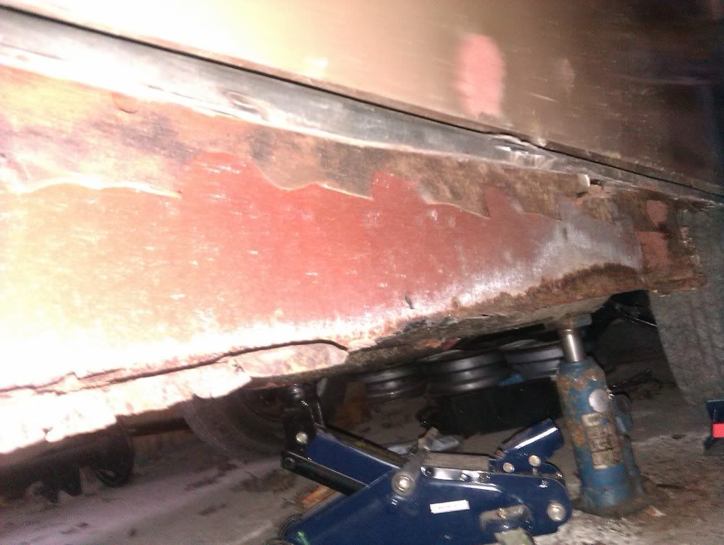

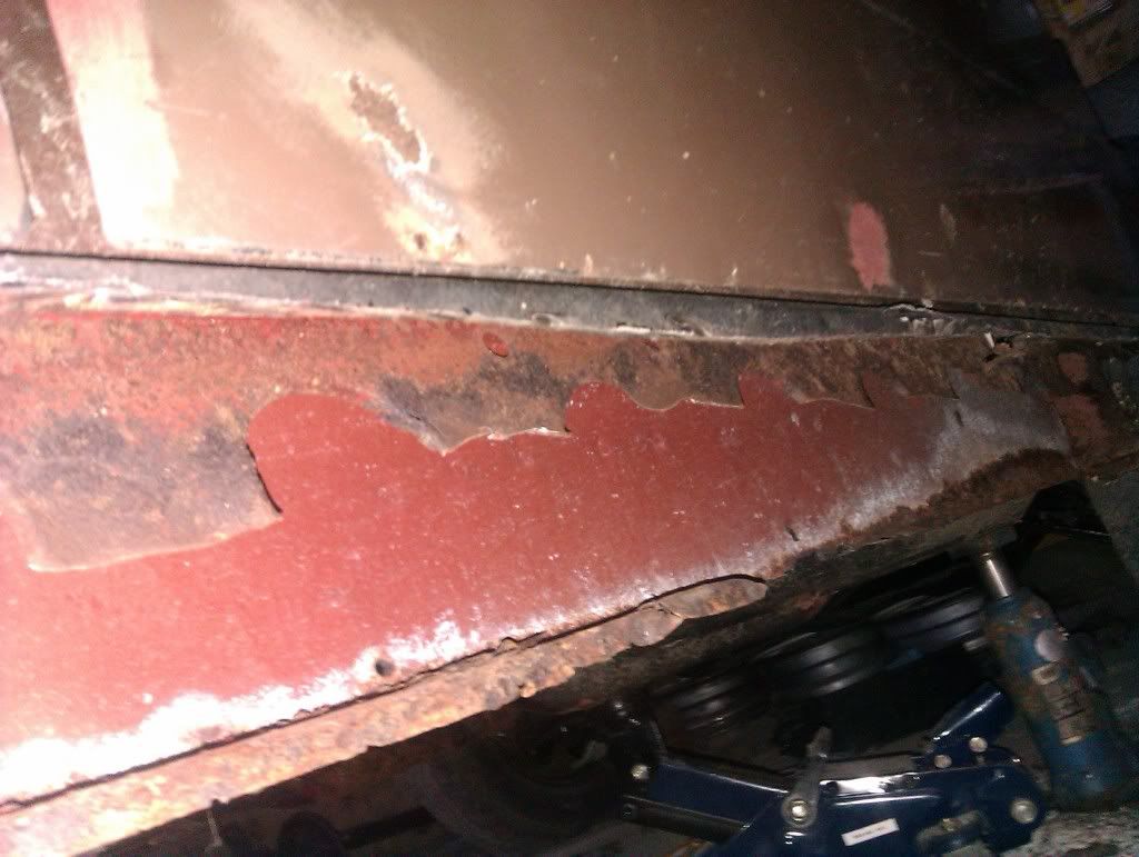

Started doing the sill on the drivers side today, started by cutting what was left of the sill off after i had supported the car with a couple of jacks.

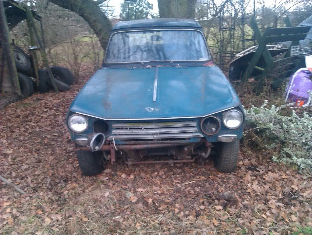

When I took the skin off the original was still underneath, so I now need a sill reinforcer. I need to get this done by Easter so I can take delivery of the next project. I will give a little teaser at the end.
Your comments and thoughts are always welcomed.
Many Thanks Too All That Enter Comments
Darren

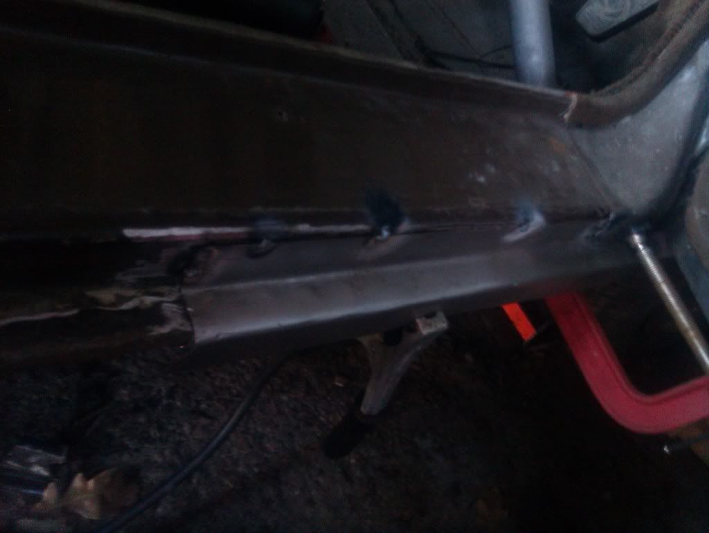

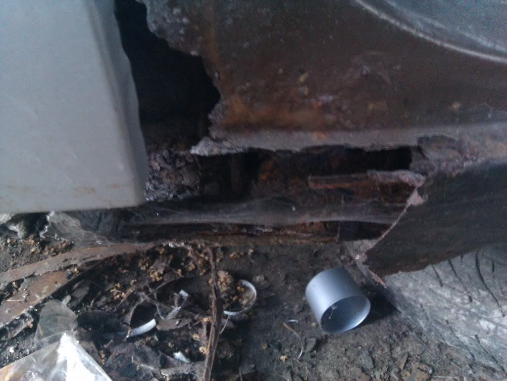

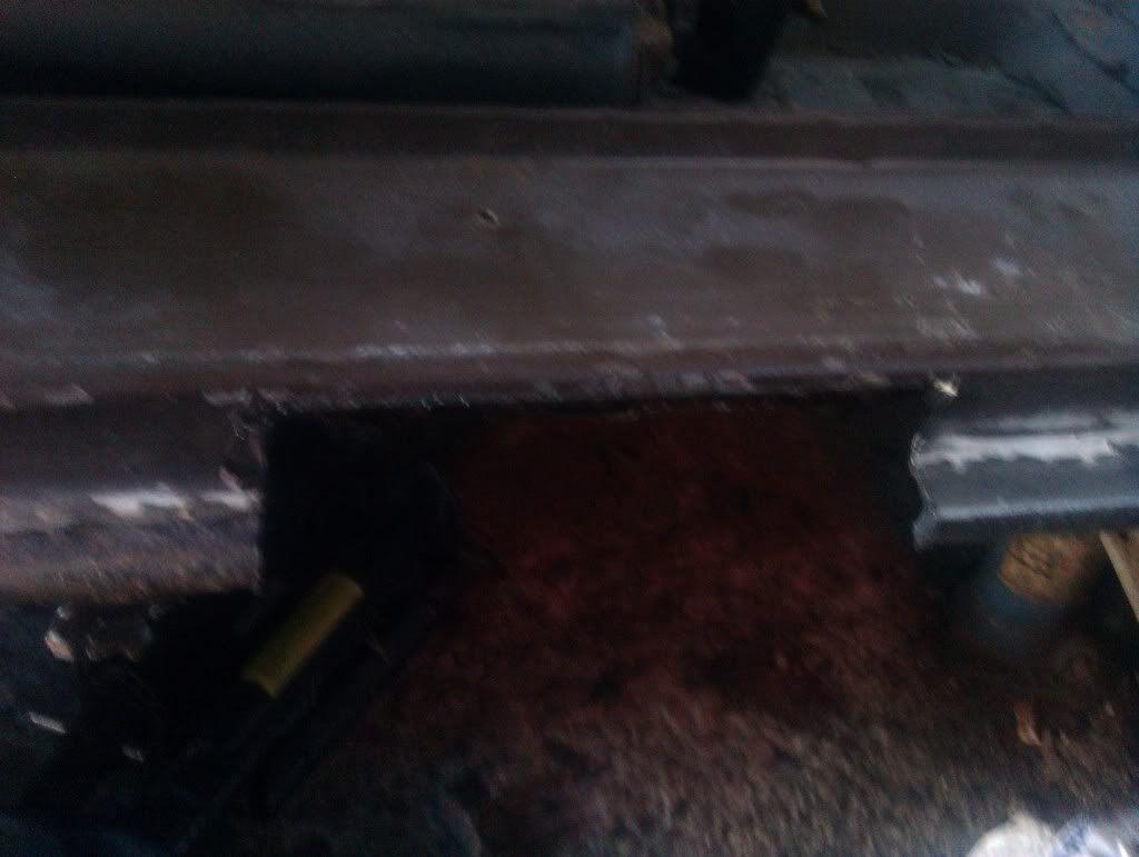

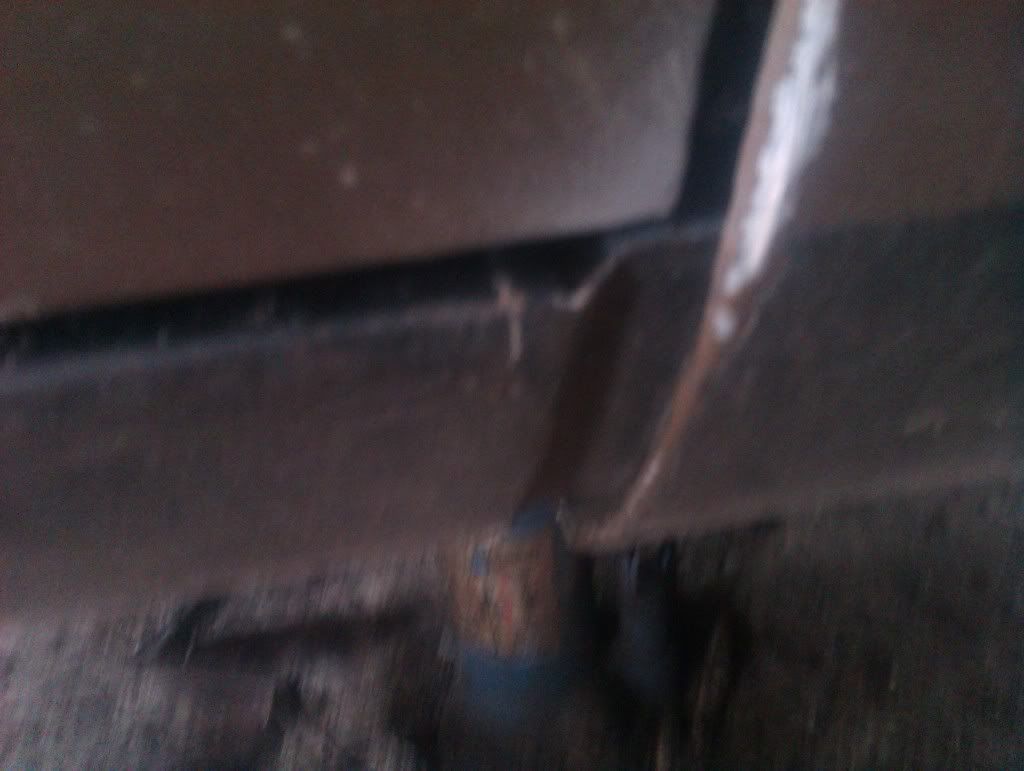

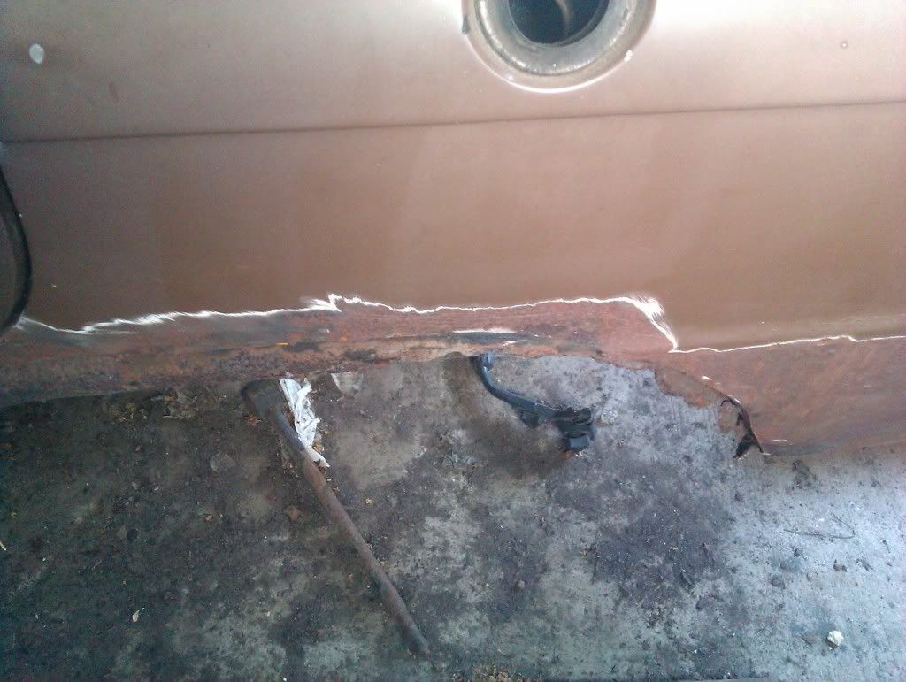

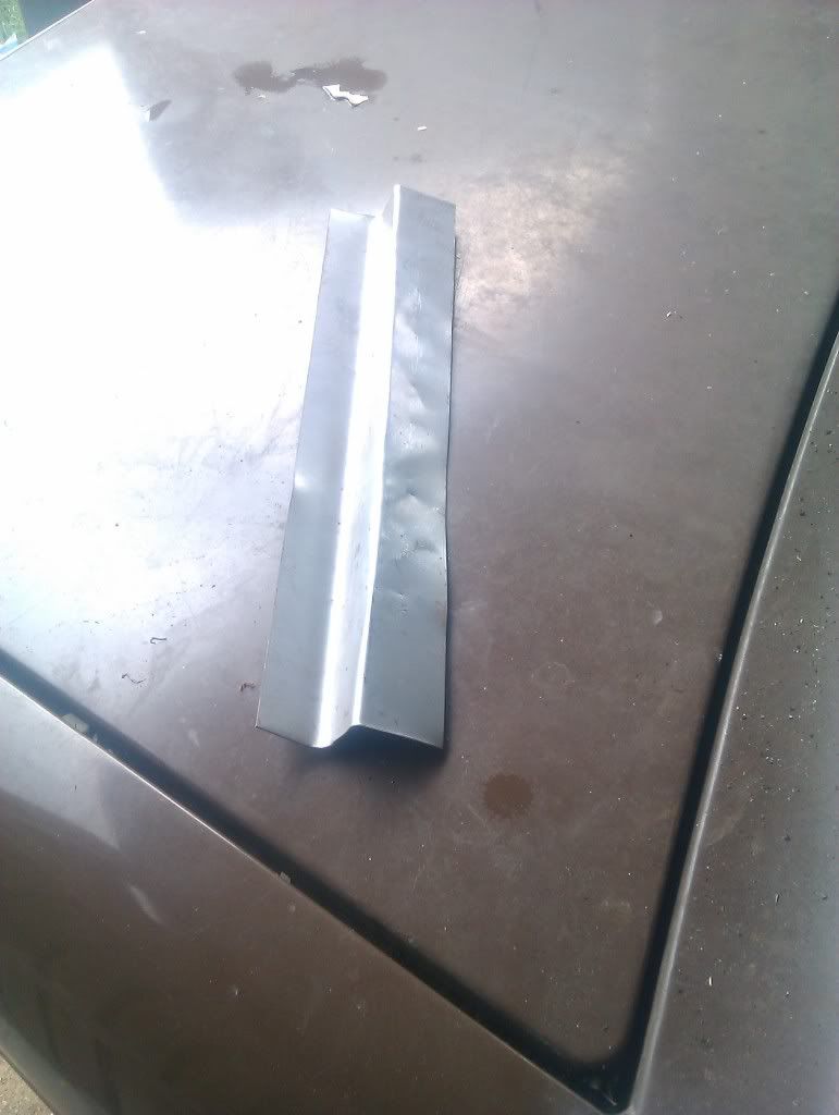

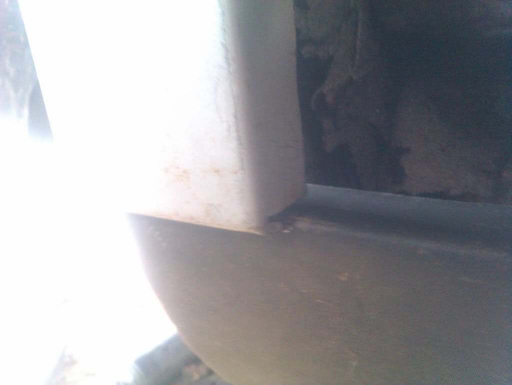

Been welding again yesterday and today. putting some new pieces in to where the top of the sill gets welded too.
I have been using the new sill that was bought over 12 months ago as a guide, but it looks a bit short to me, also the rear arch repair panel that is fitted seem's slightly too long as there isn't much space between the sill and the arch. Also tried putting some new metal in and lining it up is being a right bugger.
I cut some old metal out and then went further, but doesn't show in this pic.
Home made by me repair section made by me tacked in.
This is it finished

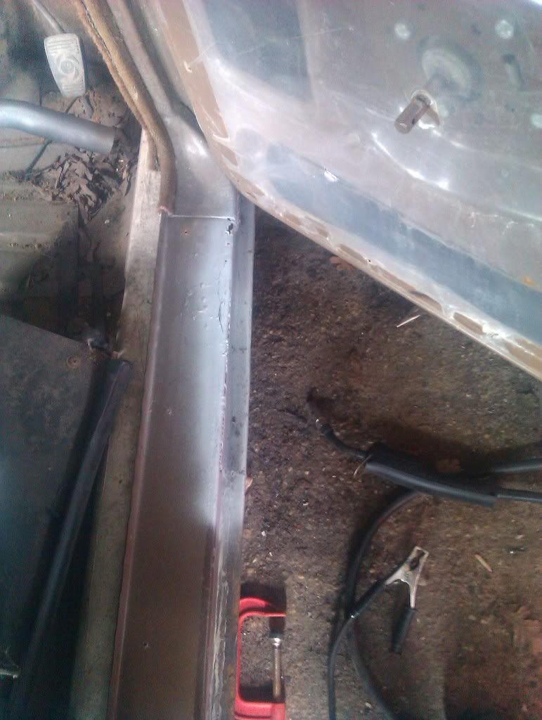

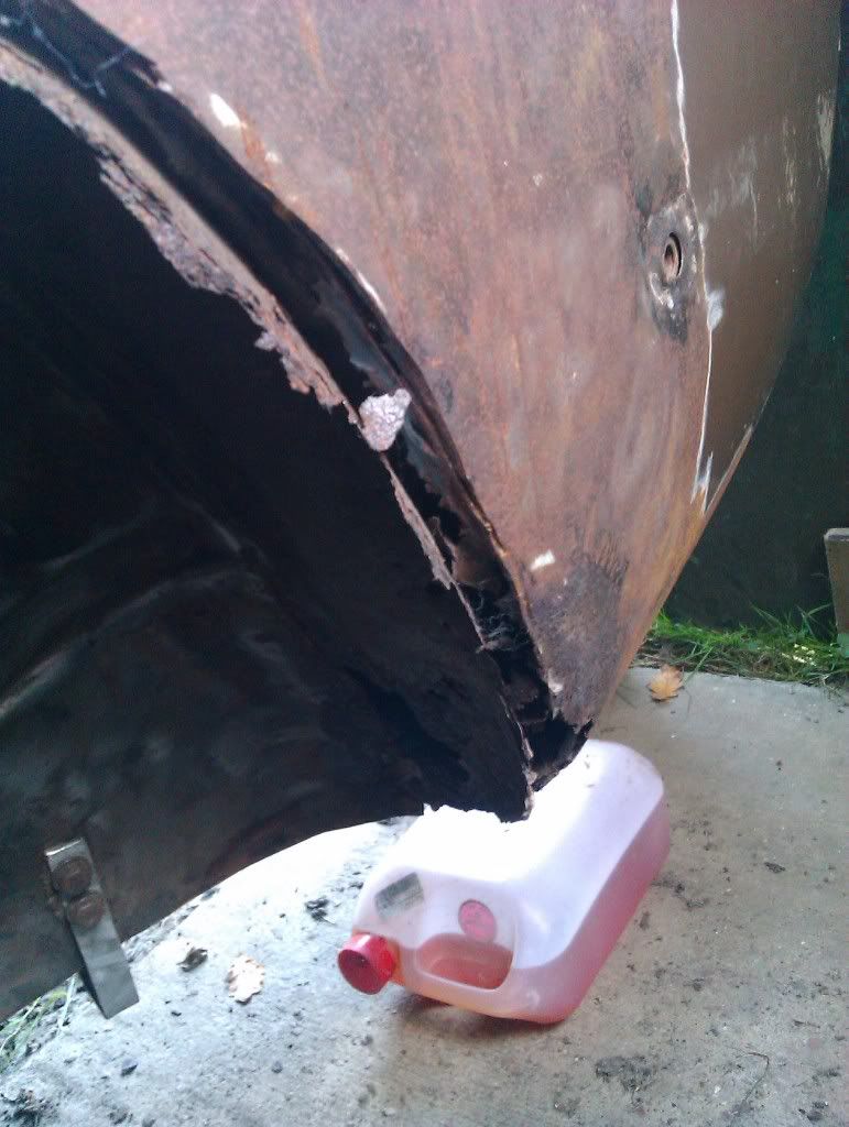

Now to the rear
Home made repair panel ready to go
This is where I have placed sill in correct position but rear arch is in the way
And the same where the sill meets the front wing, seem's about 1/2-1inch too short
