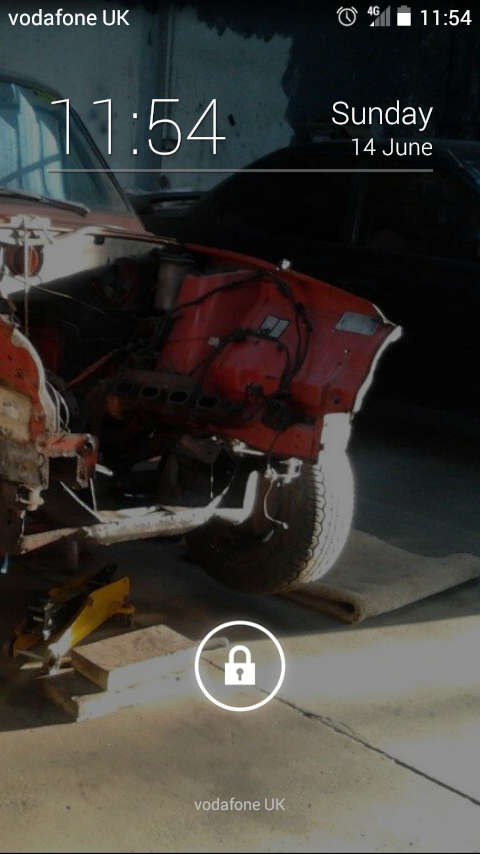

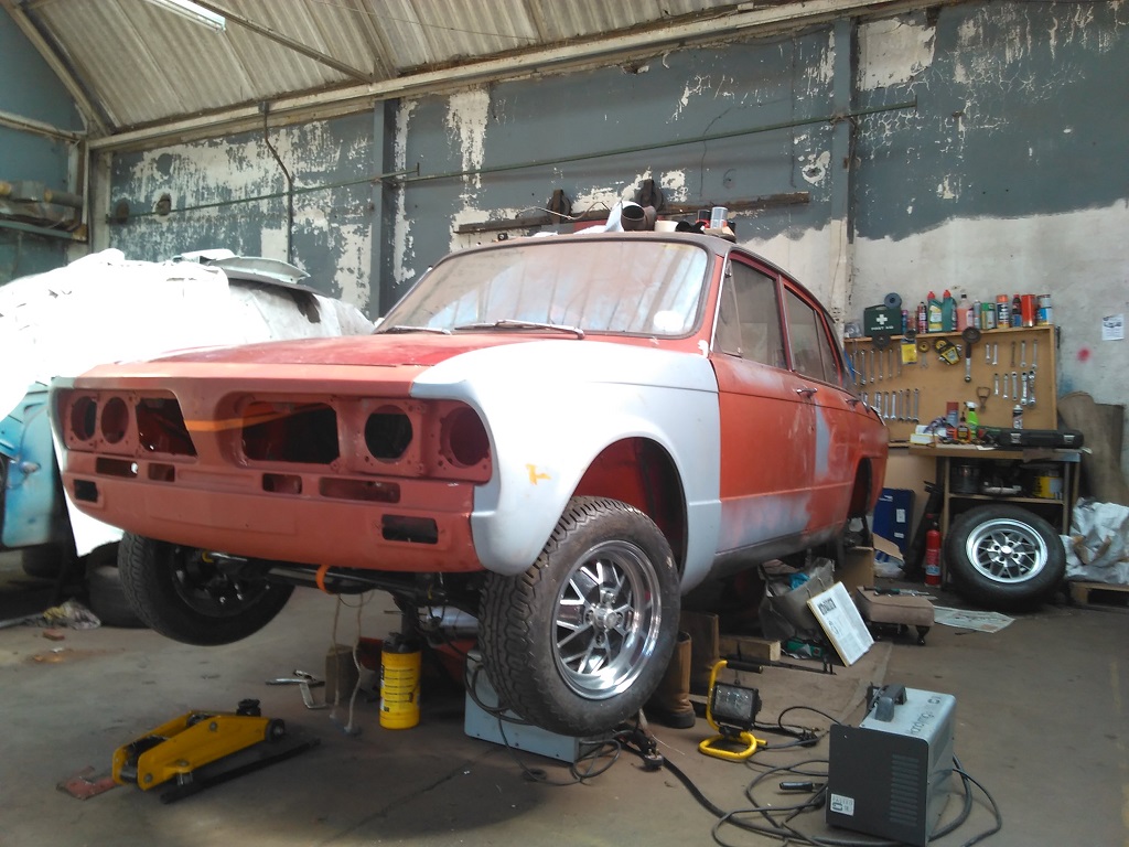

This is the earlier photo and the most recent ones with panels in place
- IMG_20150907_145235.jpg (251.09 KiB) Viewed 53607 times
- IMG_20150907_145405.jpg (141.54 KiB) Viewed 53607 times
- Screenshot_2015-06-14-11-54-53.png (451.91 KiB) Viewed 53618 times

I've resized them for you. Good to see it looking like a car again. I wish my Sprint alloys were as nice as your's. I bet they hold pressure better too!

Thanks Toledo man. As I said way back in the beginning I'm not any good with computers. And I spent hours on just those two alloys,but unfortunately not all the alloys are holding air.
Craig I didn't know you lived so close by. You are certainly more than welcome to come by anytime. It would be great to meet another member and car. PM me your number/email and I'll get in touch.
As I said iv been stressing myself over the figment of these panels for ages but its really beginning to look like a car, for the first time in years!!
