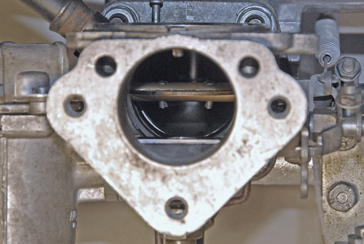

I have had a good look down through the carburettor and this is what you can see.
20130514-4110Pw Rear carburettor.jpg (128.75 KiB) Viewed 4228 times
Both screws where I expected them to be, nothing seems to be missing and since it has affected both #3 and #4 cylinders it is likely to be something that has passed down the manifold itself. Something that is/was in two parts for one part has gone one way and the other the other way.
Odd (and very frustrating) to say the very least.
(Takes a bit to hold that butterfly open against the springs and have a steady enough hand to get it into focus!!)

Needle securing bits then?

Or, if it has them, possibly a poppet valve (round thing on the butterfly at the bottom).

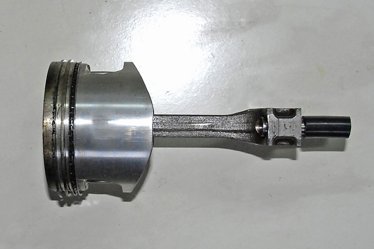

I removed the #3 piston in order to examine the possible damage to the piston top where it whatever the foreign body (bodies) has been touching it and found some other somewhat disquieting evidence that all is not right.
If you have a close look at this photo which shows the side of the piston
20130520-4113Ptw #3 Sprint piston.jpg (117.49 KiB) Viewed 4175 times
you will see evidence of it rubbing on the side of the bore. The rubbing is immediately above the conrod.

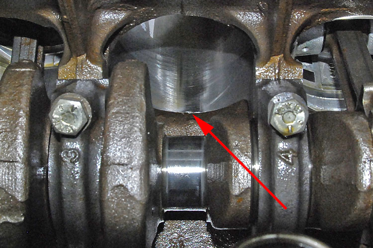

Well that is what it looked like initially but further examination of the bore itself showed quite a nasty little burr just above the red arrow head here.
20130520-4117Ptw #3 Sprint bore.jpg (145.76 KiB) Viewed 4175 times
The question has to be what has caused this? It has obviously occurred after the block was bored and honed. Is it linked to the problem which has caused me to take the head off or is this just yet another problem which I have to resolve?
A final question, do you all fit new conrod nuts every time you take a conrod apart? I am unlikely to find conrod nuts here in this country and if I have to bring in a set, it is another delay of at least two weeks.

I've noticed those marks on a few Slant pistons but obviously they shouldn't be there. However it's probably nothing to worry about. Also the marks in the bore are below the ring area, so it doesn't matter what it looks like.
As for the rod bolts, it's up to you. Some change them, some don't. But whatever you, loctite them.

There isn't a bit of ring missing is there? Sure you would have seen that.
