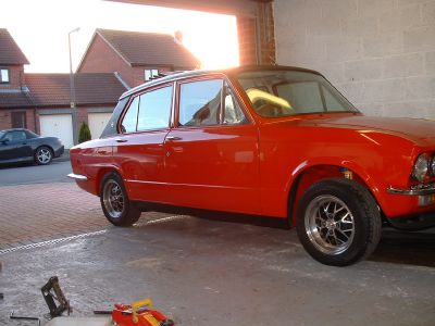

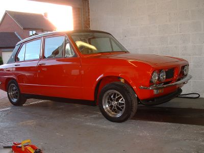

I had a set of spax on a car that I took the engine out of for a while. When I put the engine back in it was way too high. I kind of ignored it and drove it up and down the road (about 3-4 miles I guess) By the time I got back it had settled down nicely.

Seriously good and swift progress Mart, really loooking great, this is going to be a real nice motor. Dunno how you do it, I can't keep up with the pace even just watching via the web.
Jonners made a comment about the ARB. Might be worth slackening off top bj to upper arms and one or two other bolts, let cat settle under own weight then tighten them up with car on ground.

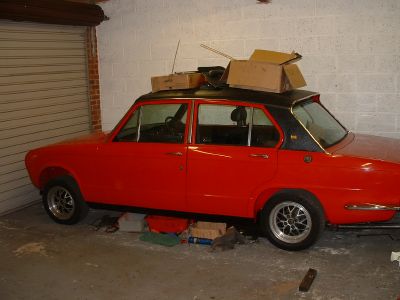

Well another weekend gone & got quite a bit done. All doors now completely reassembled except for a couple of wood cappings & door cards (found one of the quarter light assemblies was NOS
)., boot & bonnet are on. Just need to put the front bumper on & passenger seat in, then just a few odds & ends.
Thanks to James (Knightrider150) who helped me put the last door on on Saturday.

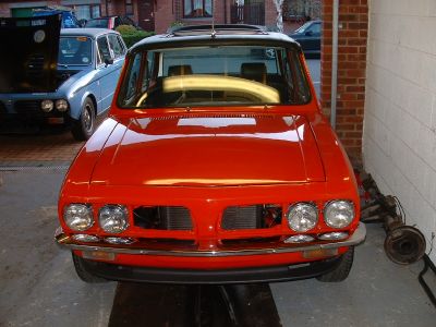

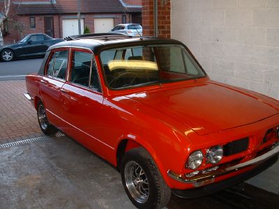

Got a few more things done today. Passenger seat's in, front bumper on, fixed the rear no. plate lights, put the bonnet release in and painted the front of my track Sprint. I also swapped gear sticks as when I went to fit the one in SFB I noticed it had been shortened by about 1½". The sun roof was quite stiff to open but I managed to free it up eventually. Sorted the front lights out (pinched a Lucas 75 off my track Sprint as well).
The front suspension did settle down to it's proper height once I'd manouvered the car in & out of the garage a few times so you guys were right.
