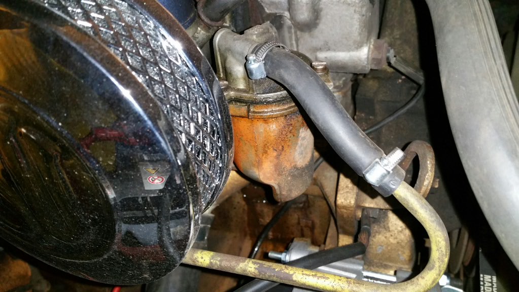

But I did manage to look at the fuel leak.
The fuel is coming out of the front float chamber around the lid gasket.
I was hoping to find some sort of debris inside, but it's as clean as can be.
Took the lid completely out, the float isn't punctured and there is no dimple on the float where it meets the valve.
Cleaned out the valve to be sure, it was clean anyway (soaked in petrol, it would be), refitted the float and then I blew through the fuel inlet toggling the float, the valve was able to stop the airflow, it would have no problem in stopping fuel.
The pin holding the float is not bent, the float is not punctured, the chamber is clean, the valve is functioning, the lid gasket is new (burlens) the float chamber and lid rims clean, so I put the lid back, tightened up the screws and reconnected the fuel line.
Start engine, still leaking through the gasket

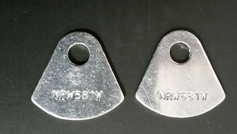

Did you order the right parts? You will need to give them the number that is stamped on the tag on the float chamber (just visible in one of your photos above). I don't know why your new gasket is leaking. Are the mating surfaces clean and even? I can't think of any other reason for it not sealing properly.

The gasket sort of sits around the rim of the chamber lid and the inner part of the lid locates in the bowl. They almost never leak
even if in pretty manky looking condition. I rarely need to change them when I have the lids off...
Even when they break on occasion away from home I've refitted them with no leaks...
So this makes me think you have a hairline crack in lid or bowl...or that your fuel hose is the leak source and it just looks like the gasket.

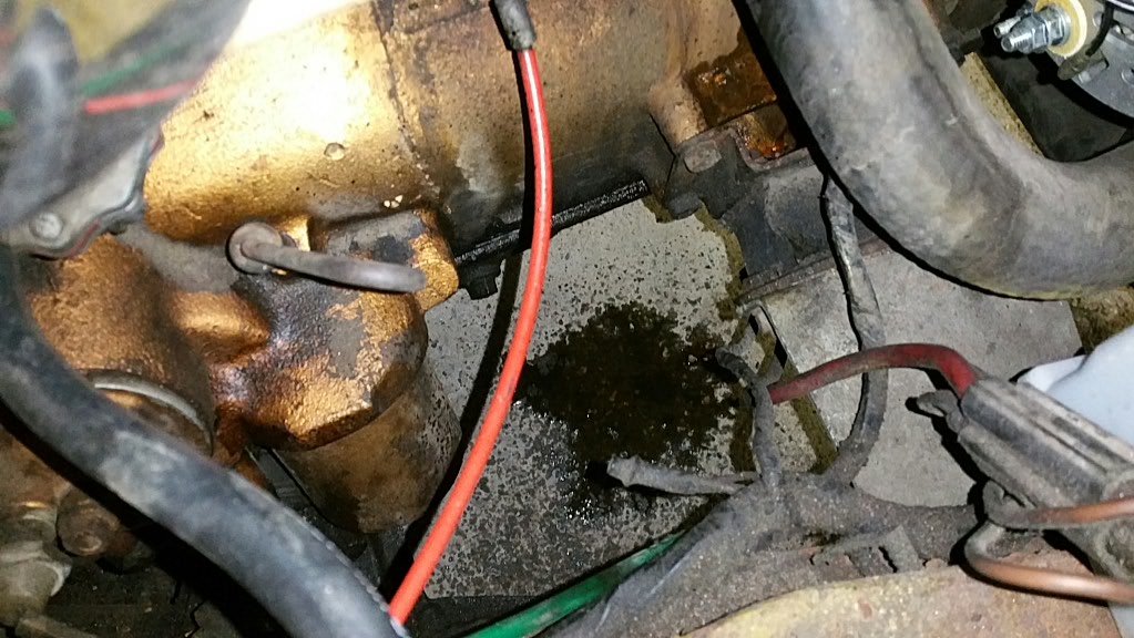

Looks like your water pump is leaking as well, the slot in the block under the pump cover looks very wet.

To echo Jon's comments, I would check that the hose is OK. I had this problem, it looked like the the gaskets but it turned out to be the hose.
Another thing to try is remove the float valve seats, clean them and clean the area on the float bowl lid that they mate to.
When you put them back make sure that they are tight. (I've had problems with fuel getting through there as well !).
Hopefully things will be put right when you get the valve kit.
