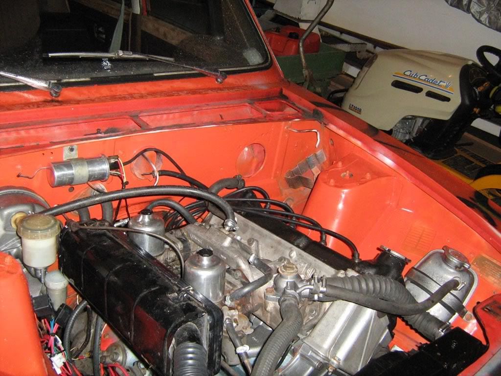

Good news, Stew.newguy wrote:Vrooom so loud with the manifold just on
idled great for the 5 secs it was going, then let it die as i have yet to put water in her but she at least runs!!!!!!!
hooray for humans wrote:sounds great. how much longer til your done?
I thought the approved TDC method for checking head stud tensioning was to observe for mayonaise, and keep tightening until it stops !idled great for the 5 secs it was going, then let it die as i have yet to put water in her but she at least runs!!!!!!!

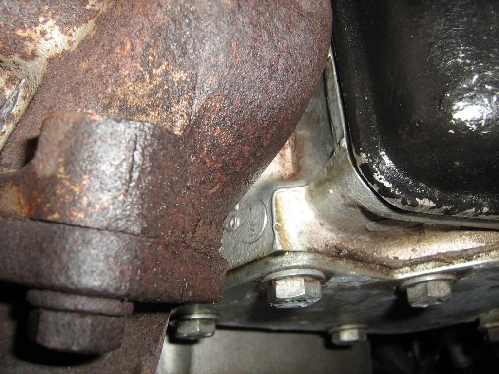

It may be necessary to fit two rocker cover gaskets to form a decent seal. I believed that with one gasket fitted the rocker cover on my Sprint wouldn't seal because it was fouling a head stud. Fitting two gaskets stopped the leak. To get the gaskets to remain in place as you fit the cover I use a little grease.newguy wrote:Still got a oil leak that is quite big coming out of the bottom side of the rocker cover nearest the firewall and exhaust. Dunno what is causing it, when i got the car running it was getting dark etc but it seems to be quite a bit 100% sure thats where it is coming from. Will have a better look tomorrow after work.
