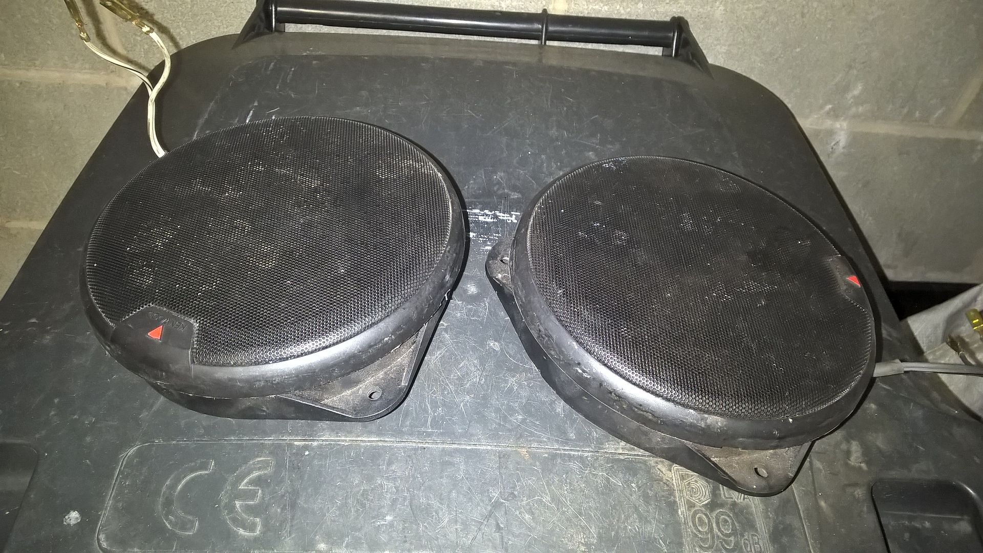

None of the motor factors have the correct ATF in stock so I might have a look on ebay. I didn't lose much fluid so it isn't too critical. I loosened the downpipe bracket and the downpipe nuts on the manifold. Once I'd moved the downpipe away and wedged my crowbar in to stop it from moving, I tightened up the bracket and the manifold nuts. A quick test drive round the block confirmed I'd cured the exhaust knock. I bought some more speaker wire and I've completed the speaker installation. It is so much better tham the other speakers which are now surplus to requirements.
With the rear shelf speakers done I can cross that job off my list.

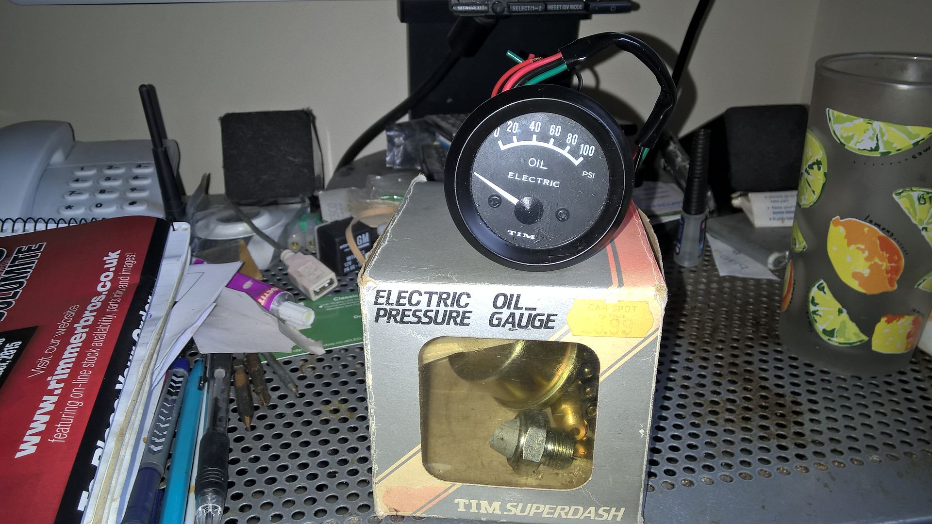

I've just had this given to me.
I had no intention of fitting an oil pressure gauge but being a typical Yorkshireman, I'm not one to pass up a freebie. It is useful to have and I can add it to my job list. Talking of which, I've just revised the list and this is it in no particular order.

I've ordered an under dash bracket for the oil pressure gauge. I just need a T piece then I can get it all fitted.

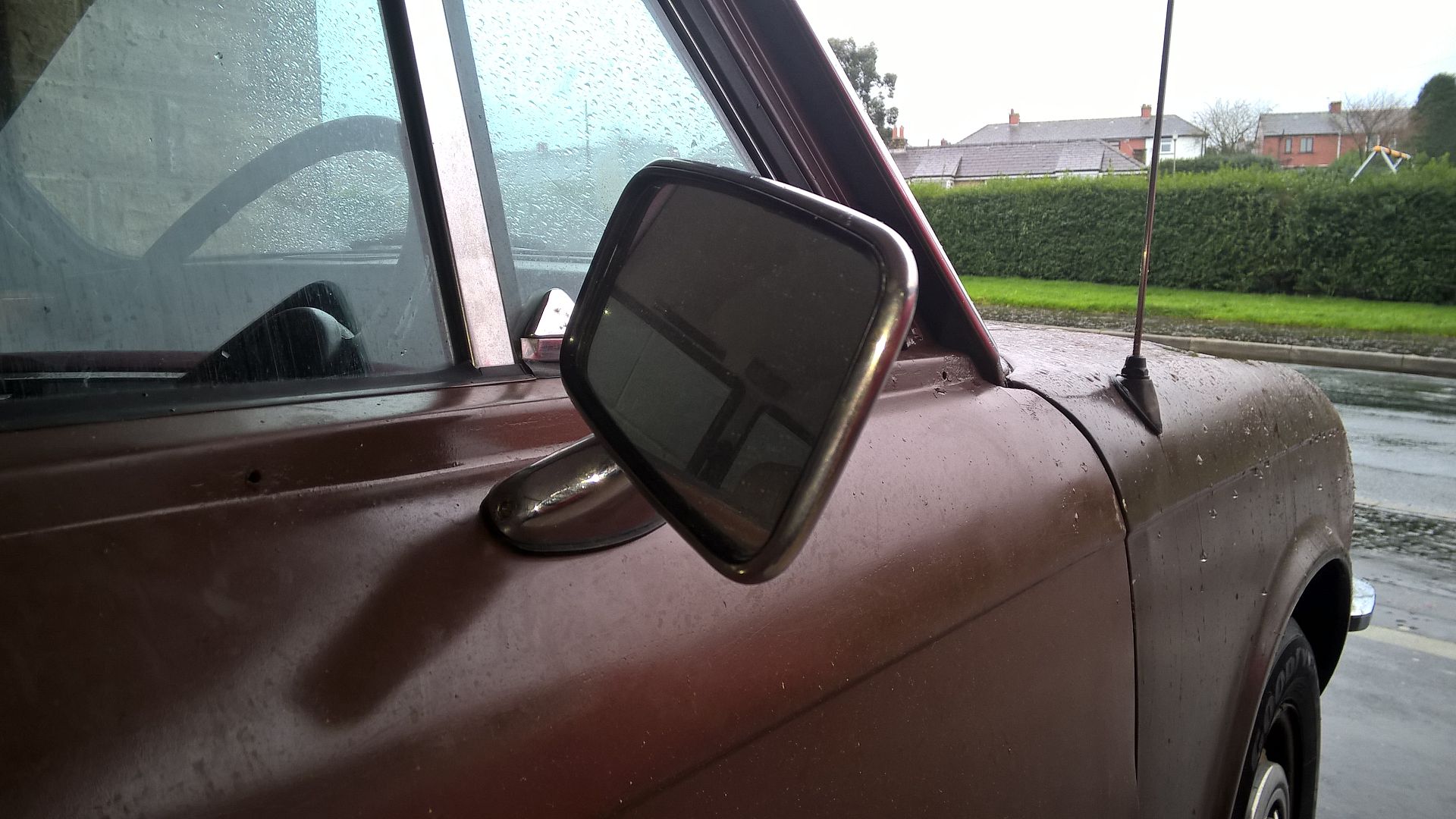

The windy weather his highlighted the loose door mirror. The problem is with the plinth. The holes I'd drilled for the screws are slightly too big so the screws are loose. I was thinking of getting some setscrews and nuts to secure the plinth. I had a look around and I found some screws the right size along with some spire clips. The door card had to come off so I could get behind the door skin to get the screws started on the spire clips. This was a pig of a job but once the screws were started, tightening them up was relatively easy and it has done the trick.
Now some of you may have noticed that the mirror is at a funny angle. I could live with it as it is but it doesn't look quite right. The solution to that problem is a chrome plinth kit.

I've just ordered THIS instead which will do the same job as the chrome plinth.
