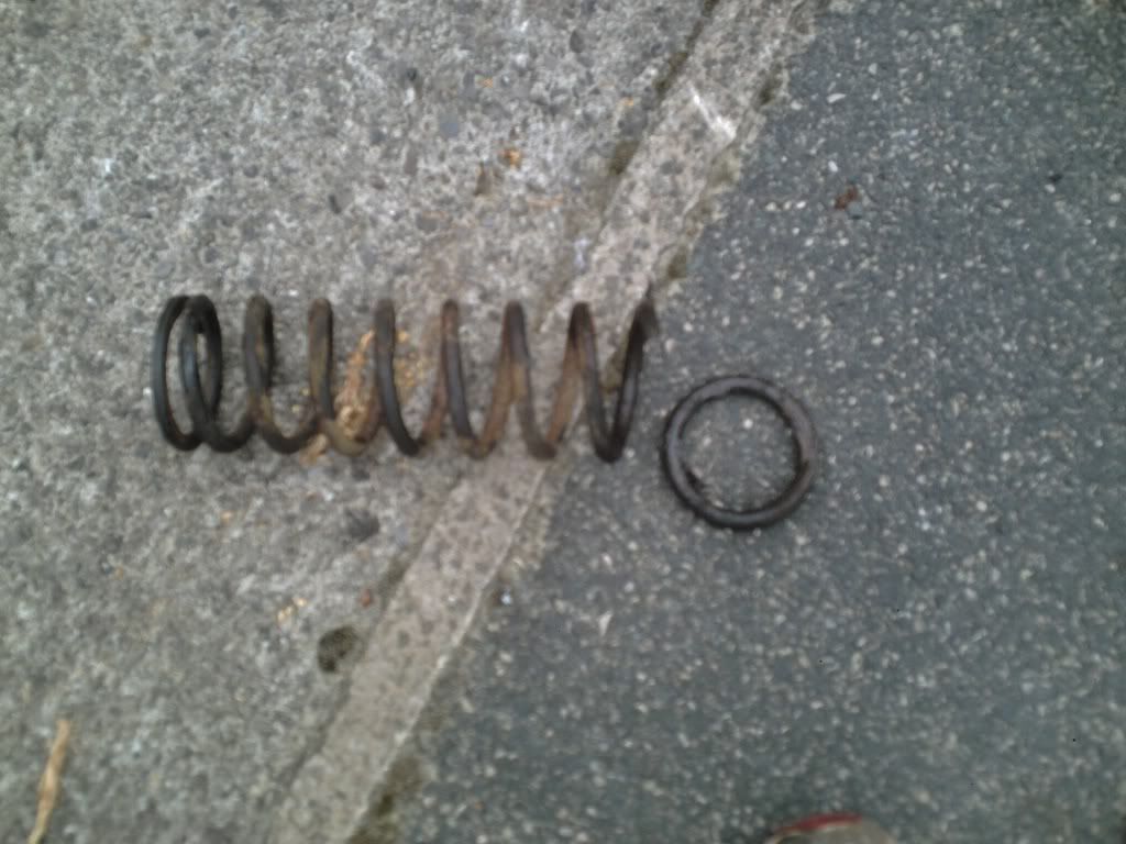

Just out of curiosity, was the break in the broken one right at the point where one end of the coil begins to overlap itself? I.E. almost inside the lip of the retaining plate thing?
One of mine was like that, yet it didn't make noise, only sagged very slightly compared to the opposite one and really only showed itself up when I had a passenger in the left at the back.
How long did that one take you and which end of the lower arm did you disconnect to get the clearance? This I'm asking because one of mine was done with the pivot out, the other with the axle to arm bush disconnected and I can't remember which was the harder to do, but as I'm going to pop them out again for some wedge-shaped plates to go in there, anything that keeps the job time reasonable for a bloke whose stamina is limited.....

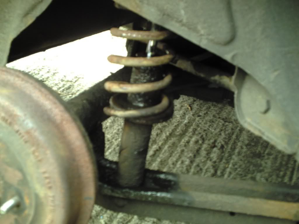

John, the right one took a couple of hours but fitting the left one took nearly twice as long. What I did was to unbolt the shocker at the top (4 7/16" nuts) and the bottom. I disconnected the trailing arm at the axle end. Even with the rear ARB connected I was able to pivot the trailing arm down enough to get it all out. The worst bit was undoing the bolts but with the help of some Plus Gas I got them off. The right hand side spring had broken at the bottom. This is what I saw when I took the wheel off:
Here is the old spring once I'd got it off:
Because Brown has a later shell the top plate is of the angled type. Autonet7's thread about the rear suspension was quite timely for me and was a help in getting it back together correctly. Replacing the springs and shock absorbers has improved the car so now I don't cringe whenever I go over speed bumps or potholes. Even my passengers have notcied the difference.

Best way to d the rear shocks is to undo the body end and pull it down.
I've only rarely found the radius arm bolts to seize and its alwasy the axle end that does it. Lots of copaslip stops it happening again.
