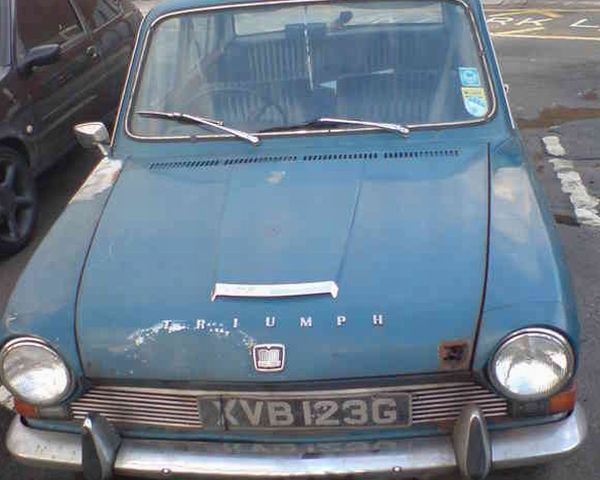

Wot they said on t'other thread. If you get a reasonable one to start with, the steel is a lot thicker than later cars so takes more rusting to go through
As an example (sorry Adam!) here's a picture of Sheila as she was when I got her
This was a year after her previous owner rescued her from lots of years storage and did nothing to the bodywork except for filling the big dent in her drivers wing. He didn't actually finish the filler or paint over it cos he was using the car (hard) as his daily transport in sunny South Wales By The Sea, parked outside.
He also got an advise on the MOT for "heavy surface corrosion on all the underside" which meant that 90% of the underseal had flaked off and it was lightly flaking all over (but no holes). He also did nothing about that but, a year later, all I had to to was brush it off, coat with rust converter, and replace the underseal - no holes involved!
The hole in the bonnet is a known weak point on these cars btw. "Known weak point" in this context means that if you neglect them for 40 years then a hole will appear. The body was covered in scratches (to the metal) which he also did nothing with cos he liked the "shed" effect.
After a year of that treatment, the only MOT welding that was needed was one front jacking point and a small patch on an inner wing. Some may have been prone to rust (steel batches do vary) but the ones that are left are unlikely to have come from those batches.
Get one, avoid ones that are already basket cases, and give it a reasonable amount of loving attention and rust really won't be a big issue. Oh, and learn to weld anyway - it'll come in handy at some point!
