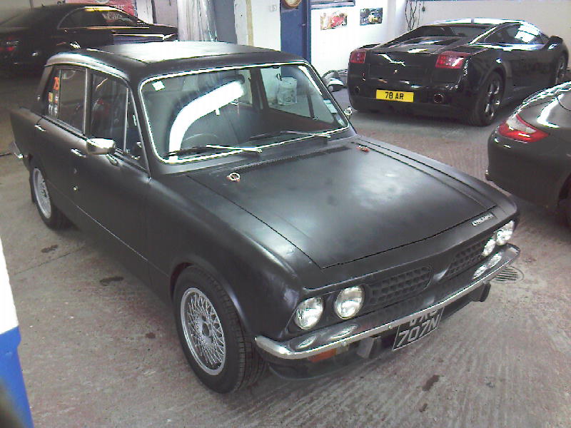

MY SPRINT VXG 707N (W london)
hi all, couldnt get the space in the garage until this monday, so hopefully it will begin then.
Ive found someone who is selling a fast road cam secondhand but i dont know anything about these, apparently i would need to re shim(?) the tappets which is fiddly to do. im wondering is it worth the trouble, i just want to do a few things to give the engine a bit more poke, and when i decide to take engine out it would be the best time to do work on it. Was also thinking about doing some diy work on the cylinder head eg: matching the exhaust/inlet ports to manifold or whatever else i can do that wont compromise performance...decisions decisions...
Cheers...jv

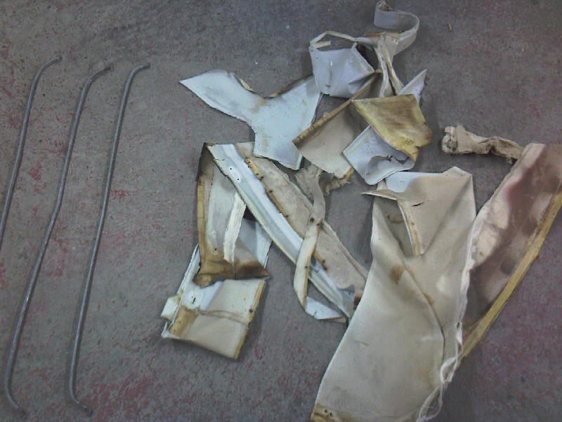

- old rotten roof lining taken out, goodbye old lining...
- Photo-0231.jpg (89.88 KiB) Viewed 3810 times

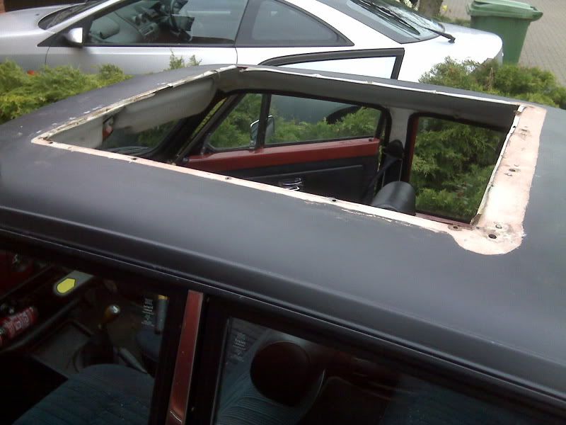

I think if you just drill out the rivets or whatever it is holding that roof panel in you will find the rails for a webatso or britax sunroof.
These do come up on ebay occasionally. I have a manky weathershield and its liner I could donate to use as a pattern. The interior lining bit and its mechansm could be reused at a pinch.

could you rob the webasto from something else?
http://cgi.ebay.co.uk/Rangerover-Classi ... 500wt_1182
Im loving the dolly in gloss black, do it man, and welcome to these crazy forums
Jon Tilson wrote:I think if you just drill out the rivets or whatever it is holding that roof panel in you will find the rails for a webatso or britax sunroof.
Thanks for the help,but i'm thinking to weld and flush it as i would prefer a smooth roof instead of the sunroof. i know it started life as a dolly with a webasto, but i'm happy without one....

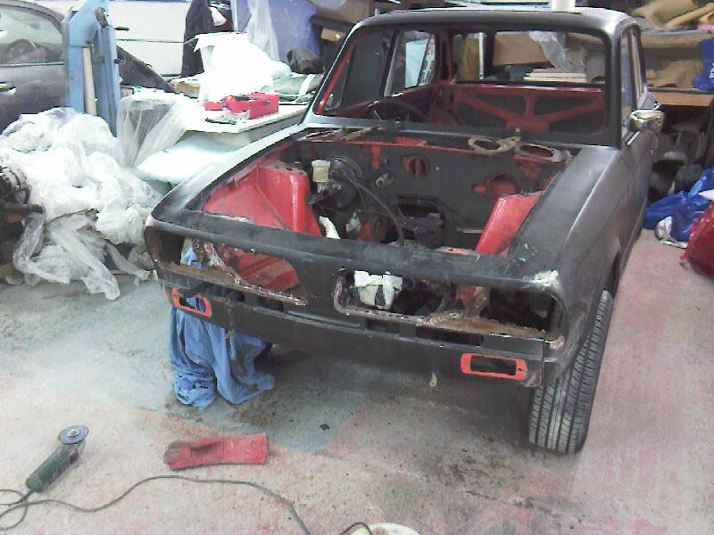

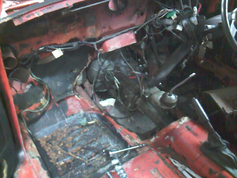

So, today went reasonably ok, I stripped the dash out and gearbox cover, heater matrix, and found various large rust holes under scuttle/behind the dash that needs quite a bit of work.
I also disconnected/removed the radiator,various wires,ignition coil and some hoses to ready the engine for removal.
One thing I've noticed the day I brought the car to the garage I had problems getting it into gear, especially reverse. (I hope its nothing too serious)???
Also found some scary rust behind the front headlight panel including a hole on the chassis. I think iI will have to purchase a new front panel as I going to have to cut the front panel away in order to do a proper job on the welding/repair. Anyone that has a cheap new one I'd be happy to take it off your hands...

- rust behind dash near wiper linkage
- Photo-0248.jpg (91.75 KiB) Viewed 3677 times
- David6214
- Posts: 5154
- Location: South Coast
dash rail rust isn't unusual and its hidden. Weld with confidence.

Is it worth taking a complete roof panel to get the curvature?
Alun (xvivalve) does a grp front panel
I agree it might be better and easier to replace the whole roof section. Shame about not keeping the webasto, I think they look cool, just my opinion though

Let me guess, the hole you have found is in the inner front panel at the end of the inner wing box section? You DO NOT have to take the front panel off to repair this. The rust will undoubtedly have spread from that box section, usually the side with the battery/without the exhaust. Using the kit of parts we have developed, four plates and the subframe mount tube, allow you to repair from within the engine bay and wheel arch doing the inner front panel first with a plate from within. It would be a shame to ruin an otherwise good front panel as Ken says, they aren't cheap. There is a GRP option, they fit well, but are GRP at the end of the day and they are readily available at £120 plus postage.

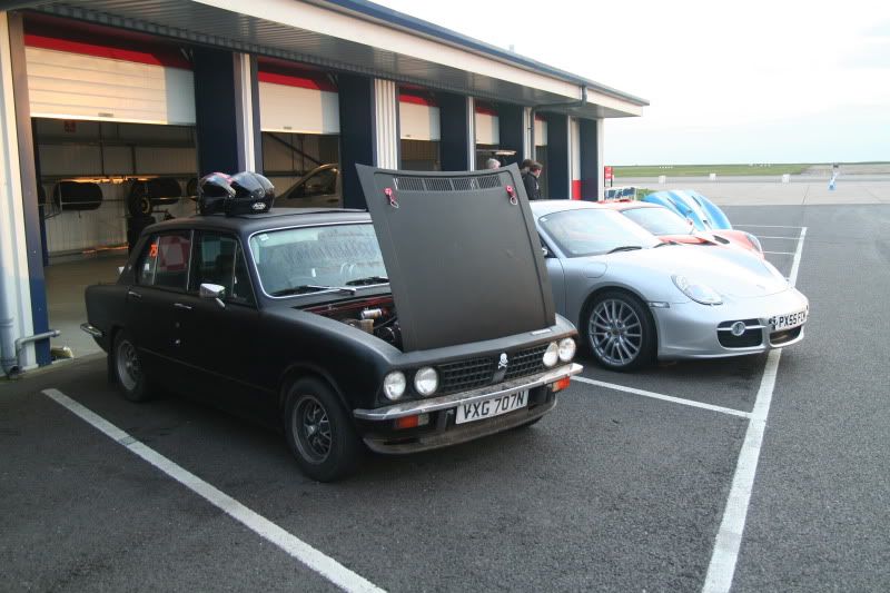

It was a mate of mine who saw your car at Ikea and sent me a picture of it.
Hi, finally managed to check your resto thread out, seems like you're cracking on with it.
I also see your giving it the kind of stable mates it's used to
Regarding getting more poke, make sure you're flooring the throttle as I found the last few percent of travel travel seemed to give a disproportionate increase in grunt. Certainly enough to scare an Exige:
This is what you'll find under the plate after the trackday pulled the webasto off. Vinyl roof would be a good period touch.
Did you get the window winder through?
