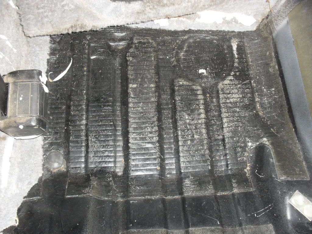

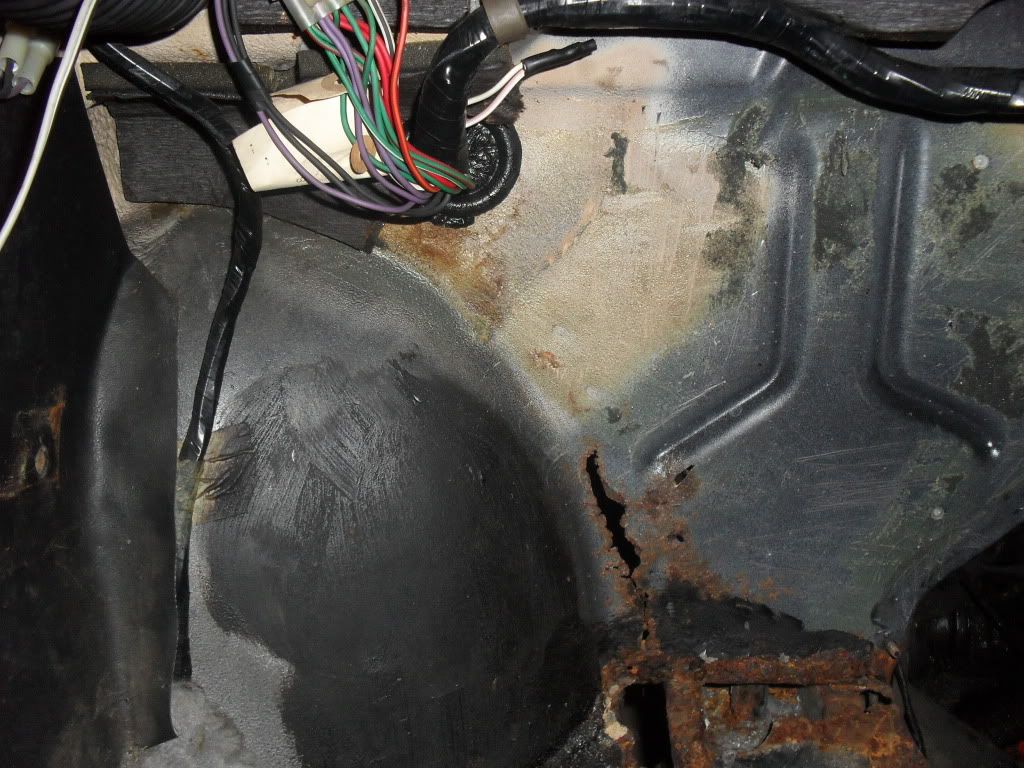

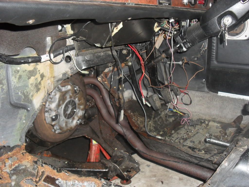

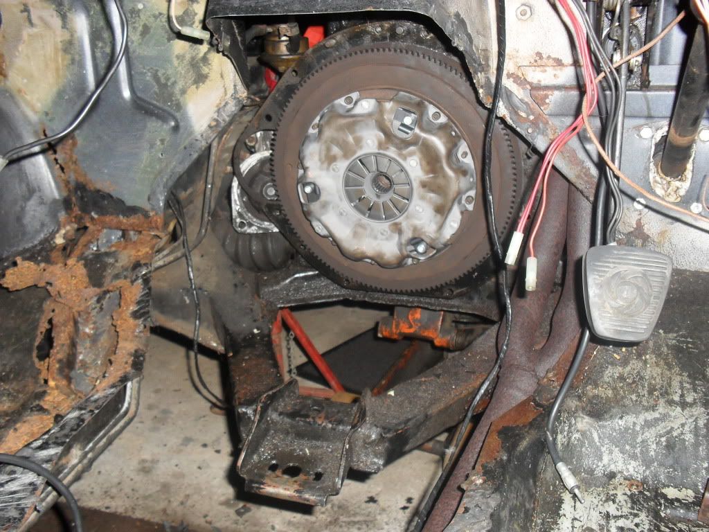

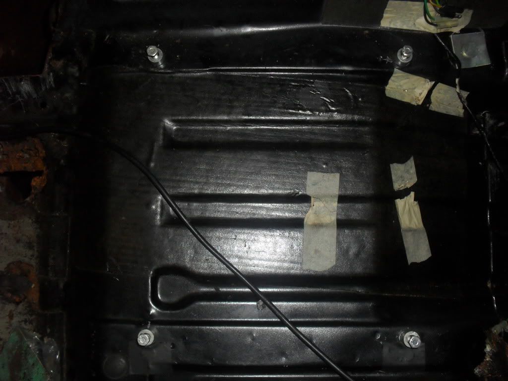

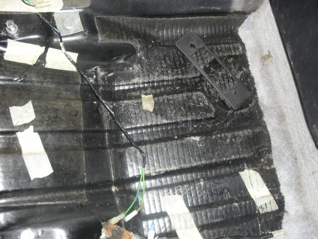

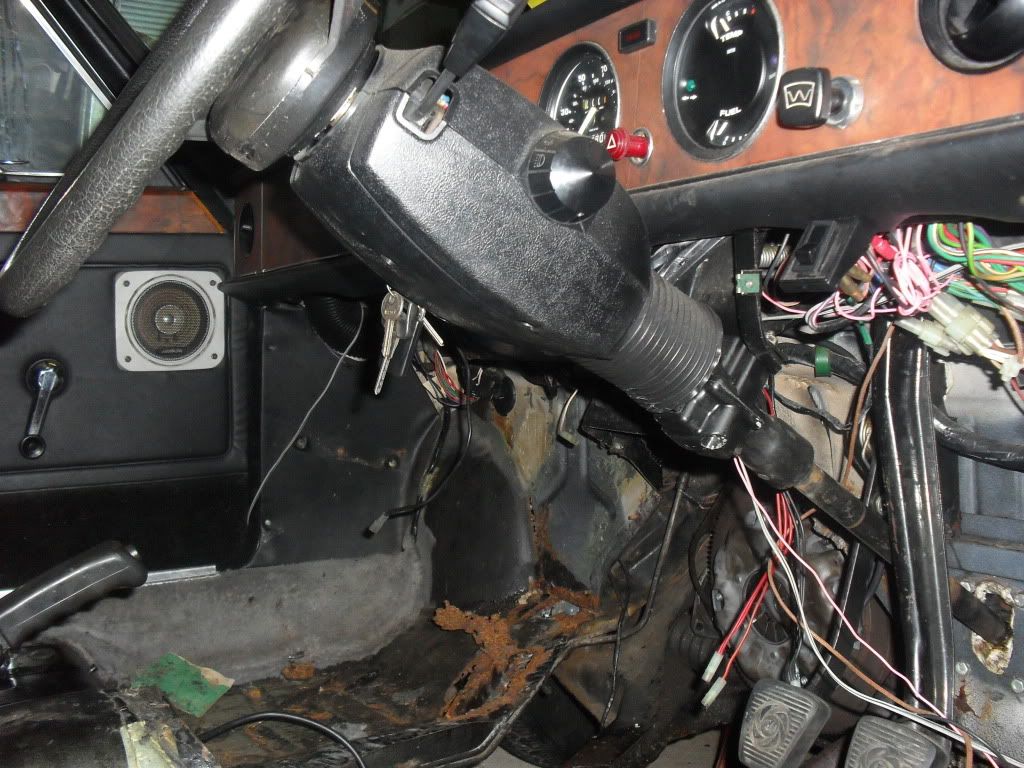

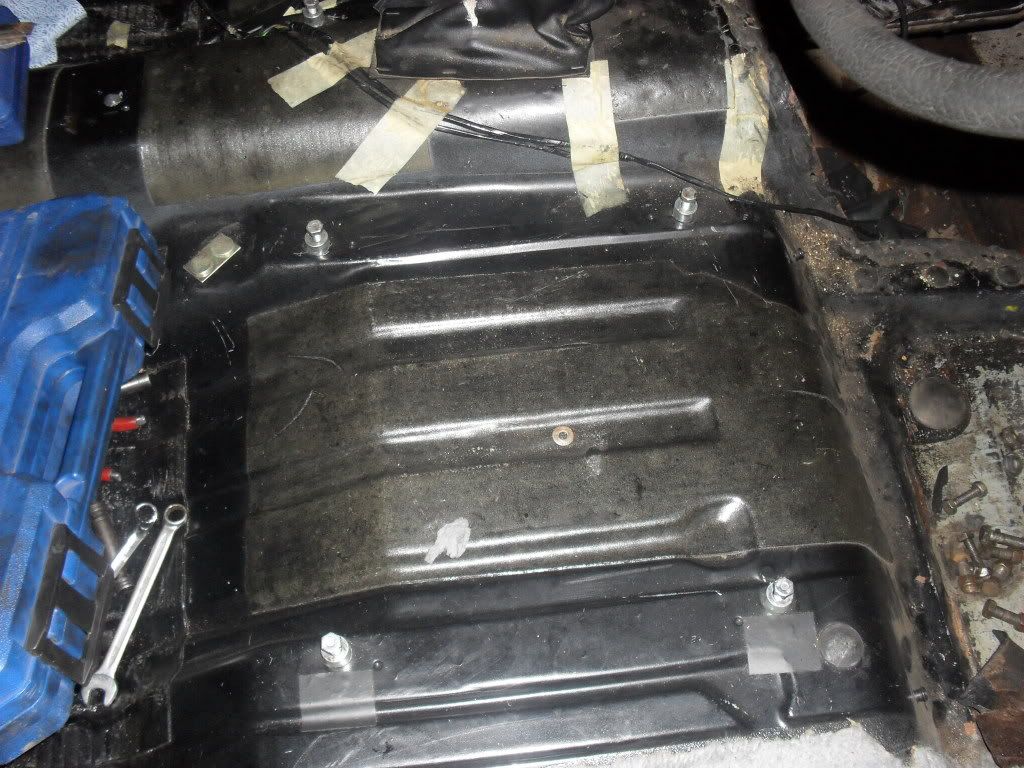

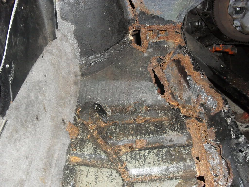

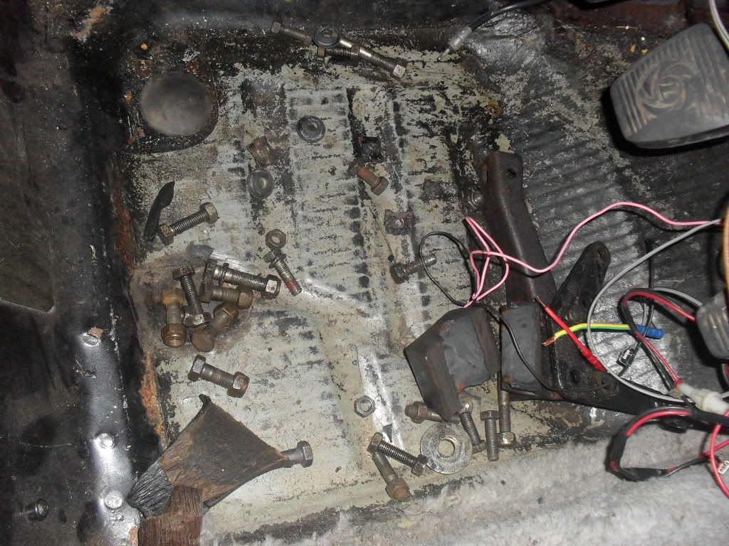

Lost a bit of time on this one due to the weather. Unfortunately due to the day job and the distances involved, every day was a long one so the Se had to wait until the weekend.
I crossed my fingers that the initial once over that appeared to show no required welding would be correct but as probably to be expected, a little surprise awaited me after I had removed the seats and carpets. As previously mentioned, I thought that the passenger footwell may previously have had some water laying on it and it would appear that this was correct. I prodded the soft area and was left with a few holes and a handful of fibreglass from an old repair. As the problem is in a localised area I will check where possible for the cause. As the car was garaged for so long, it may be that the problem was sorted when the floor was previously repaired but without knowing for sure I will investigate as best as I can. Besides leaky screen or heater plumbing is there anything else I should look at?.
Floor under the drivers seat.
Drivers footwell
Drivers side rear footwell
Passenger footwell
Floor under passenger seat
Passenger side rear footwell
Passenger footwell
Gearbox removed and clutch ready to come out
If all goes well tomorrow, the clutch should be swapped and new (secondhand) gearbox should be in. I need to get a footwell repair panel so that will have to wait until the panel arrives.
Whilst the dash is out, I will tidy up the radio wiring and get everything in place for a new radio. One thing I don't like is messy wiring.
Has anybody got any good door panels without speaker holes in?
Other job for the next couple of days will be to get on with cleaning the carpets and seats. I will do the seats first while they are out of the car. The carpets will be done once they are back in the car to make sure they don't lose their shape. If the carpets don't clean up very well then they will suffice while I wat for a new set. rimmers advise 4 week wait for delivery. There is a seller on ebay who has a 10-14 day wait but without a reccommendation I am unsure whether to give them ago.
I have also located a NOS centre exhaust for the bargain price of £15. Collecting this on Monday so hopefully may only need to find a rear section to complete.
Hopefully more updates in the next few days.
Stewart
Drivers footwell
Passenger footwell

I can find you a rear section I think - NOS
You will be able to get carpets and seats from people on here.
That chassis leg is a surprise. Have you asked XVIvalve for the part?
Re where to check...Leaky screen, hole under the wing or in the dash rail (I reckon dash rail, caused by leaky screen), hole in seam / gap between wings, holes in bulkhead or the bulkhead filling up and grommets being missing. Check both sides of the dashrail / screen in case the car had previously not been parked on level ground.
- mbellinger
- Posts: 2403
- Location: Bromley, Kent
Re: Recommissioning of 1500 SE - NGC 797V
It will definitely be leaky screen rubber. The water always flows to the nearside (usually because of road camber) and sits in the back of the parcel shelf saturating it - hence the rot on that bit of the bulkhead too.
Alun can supply floor pan panels in zintec, and the bulkhead and associated areas can be made good with small plates cut to shape and welded in.
