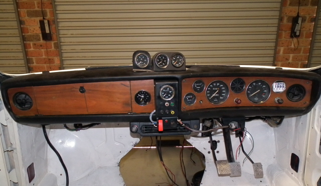

Finally some progress on the rebuild, wiring loom in, dash board, pedals, brake pipes, etc. Currently doing some wiring change/upgrades and will update photos when completed the dash area.

The wiring loom, dash etc are finally in and finished. The original loom was in poor condition (been modified to many times) so a standard loom was fitted along with new wiring for electric fuel pump, OD wiring, cooling fan, tacho, etc. The heater must remain in the car, (not connected) so the switch/circuit breaker panel fits over the controls. The car used the original ignition switch, but over the years we have found them very unreliable, so it is bypassed and a separate ignition "on" and push button starter is now mounted under the switch panel, which looks the part. A Smiths tacho will be fitted on top of the steering column shroud.

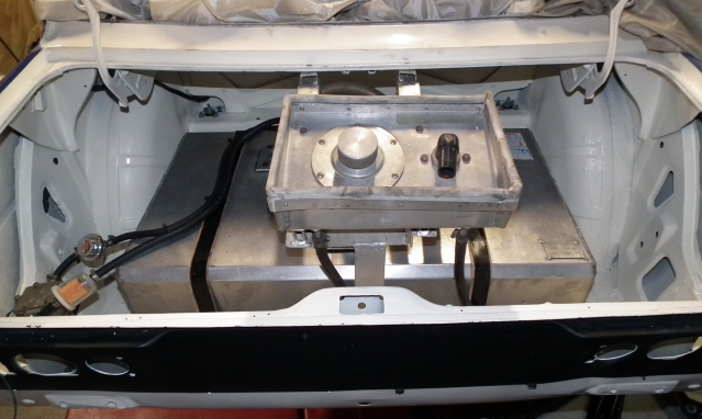

The alloy foam filled tank (100 litre capacity) , Holley fuel pump, pressure regulator now fitted. I have a Dry break refueling valve for the car (and fuel churn) but it is a pain in the a**e to use, so a screw cap was fitted 20 years ago to make it easier if filling from a drum or bowser.
Rear shocks and springs fitted.
Engine bay build up progressing. After sitting for 4 years, brake and clutch M/C overhauled and clutch slave replaced.
