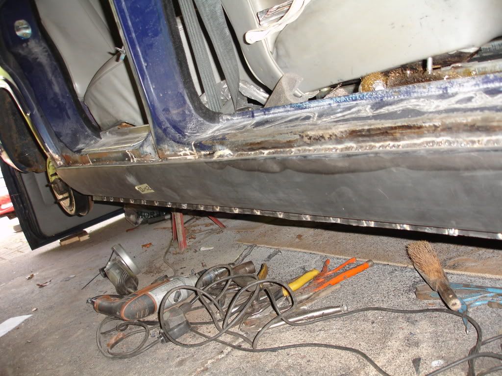

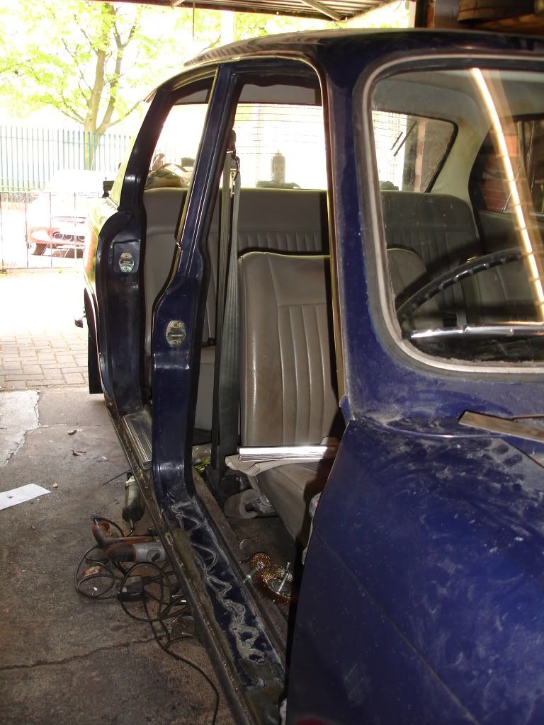

Doors off now so the new sill can be properley welded on all the way along the top..
Heres the sill partially welded on (ran out of gas halfway!)

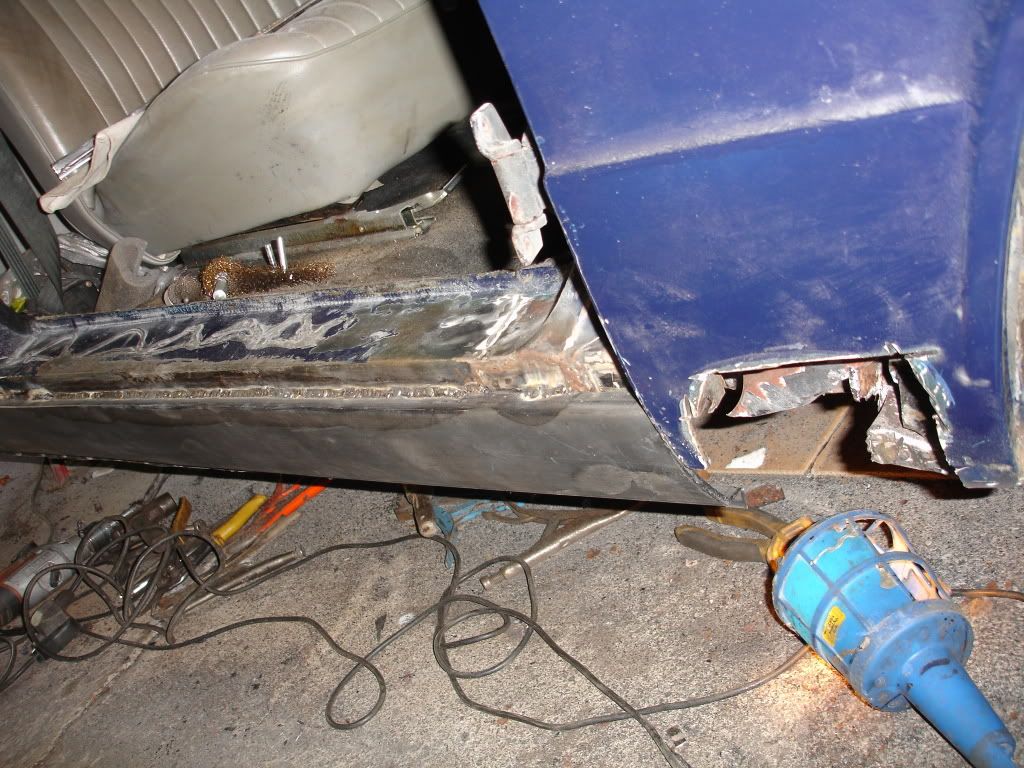

A seperate repair needs to be done where the bottom of the wing had to be removed for access to get out all of the rotten metal inside

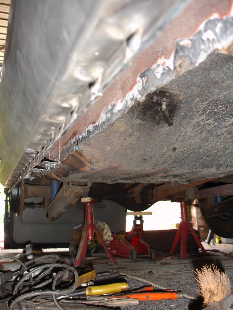

And here's a view from the bottom, the bottom of the outer sill is spot welded at the moment to the bottom of the sill reinforcer while new metal for the back section is made to fit so far so good
