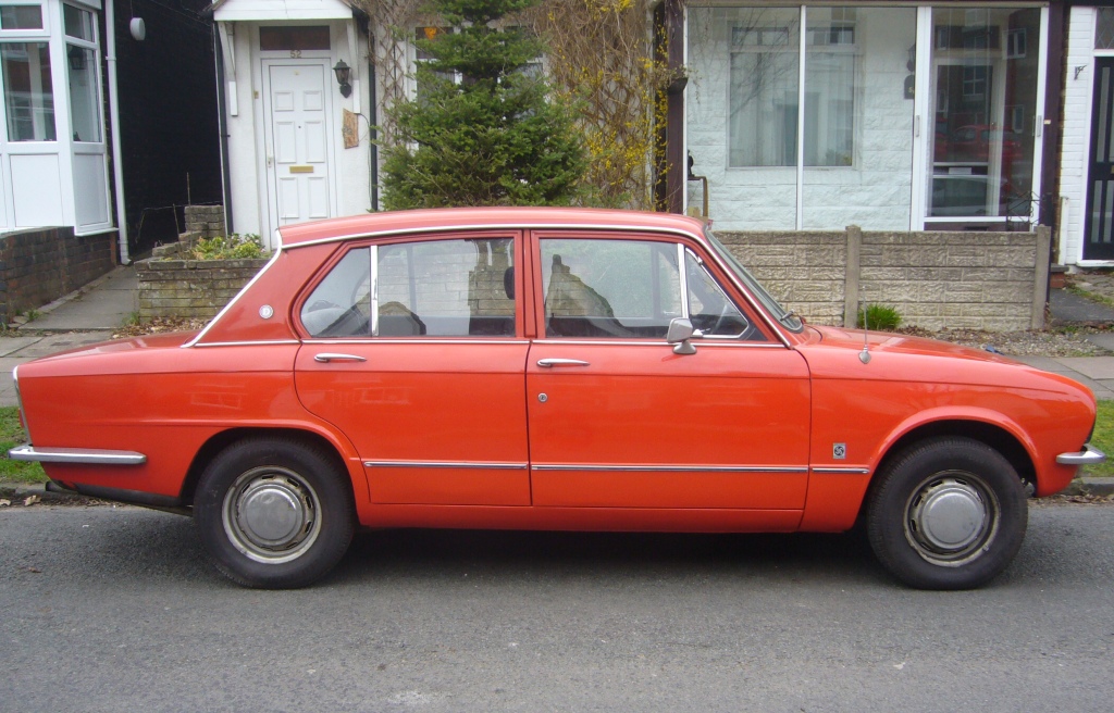

Ken - I see your point about the wheels :oops: (see pic below taken yesterday)!

Purplebargeken
Re: My 1500 Dolly is back from the Welders!
#20 Post by Purplebargeken »
Not drastic to sort out Angie, especially compared to what you have had done already.
Get them blasted as it is quicker, easier and gives a better finish. This should be around a tenner or so per wheel. Rust kill them and then coat in etch primer. Then a good couple of coats of a suitable colour and some laquer. Job done and the car will really stand out then. You should be able to get some shinier hubcaps at Stoneleigh (as well as all of the required paints, etc). Shame it ain't the resto show :lol:
