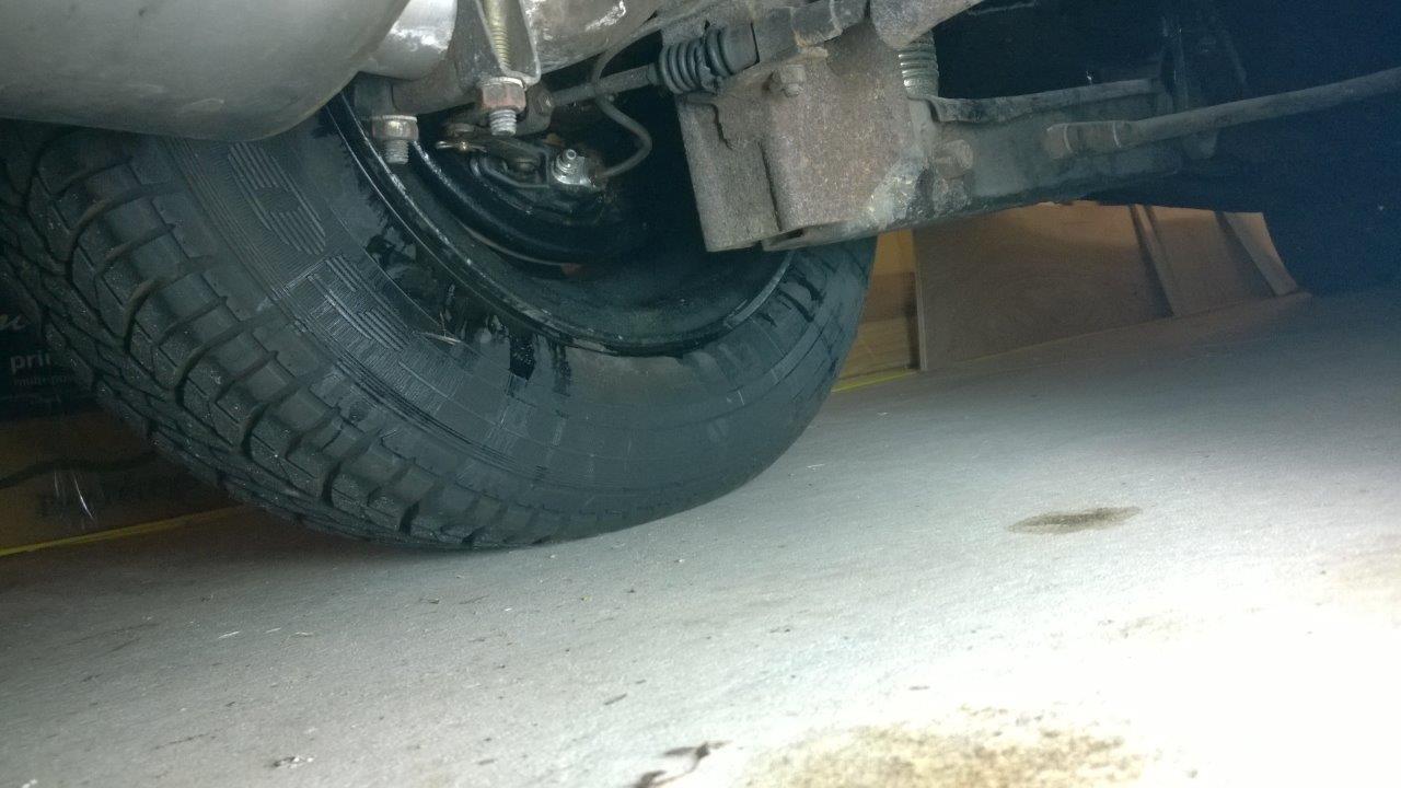

I'm still keeping an eye on the rear axle. I'll get the wheels off and check inside the drums soon.
However, see this :
This is the NS rear problem corner. The other rear wheel looks normal on it's inner face.
Given location of tyre run marks I'm thinking this might be brake fluid not axle oil.
m
However, see this :
m

Simplest test is (don't laugh) taste it! Just the merest smear will tell you what it is, brake fluid tastes absolutely awful whereas gear oil just tastes - oily! Because brake fluid is somewhat poisonous, the manufacturers put something in it by law to make it undrinkable! But a tiny bit won't hurt you, I've been doing it for 45 years and i'm still here.

I'll be taking a look at this tomorrow morning. I may try the taste test. I'm more hoping a visual confirms things before.
I have tried rolling the fluid between my fingers and you know how hydraulic fluid feels different. I'm not sure but suspicious. I'll report back
Re: Sprint rear axle seals leaking
Well I just took a look.
Brake fluid tastes bitter right. I just found out...... I even double confirmed by trying some right out of the bottle. It's ok, I didn't inhale.
So I think there is a weepy brake fluid union. It explains the residue on the back of the backplate and the marks on the tyres.

There is no doubt that the leak as pictured was a small brake fluid leak.

Another way to tell if its brake fluid without tasting it which as you now know is pretty vile is that rubbing between thumb and finger it has a grippy type feeling to it whereas oil doesnt
Yeah I'd done the grippy finger thing before which is why I already had suspicions. It was old pipe into new brake cylinder and I guess not quite sealing. I think it's ok now.
