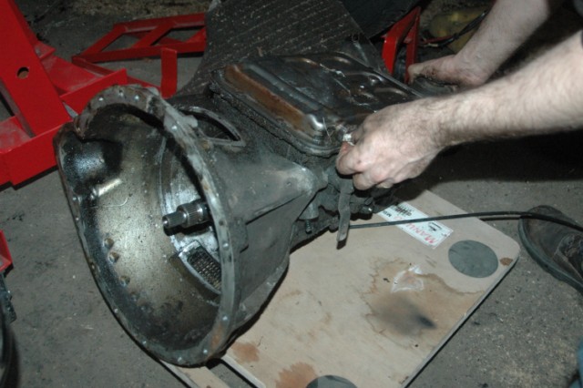

Re: Froggy Dolly
Hello,
some news today
i put the gearbox off , no doubt now , it is a BW65
the breather pipe was OK
there is a lot of mud/grease inside the carter , under the converter
one strange thing concerning the oil level
i possess the two workshop manuals for sprint and 1850
For the same gearbox , the sprint one says that level must be checked while engine running , and the 1850 says it has to be checked just after switching off
some news today

Re: Froggy Dolly
Both Sprint and 1850 manuals (Just had a look) say the box must be dipped with the engine running and after selecting each position and pausing while the drive takes up, putting it into park and dipping it then is the way to do this.
