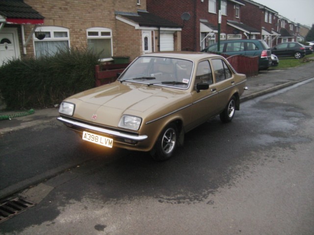

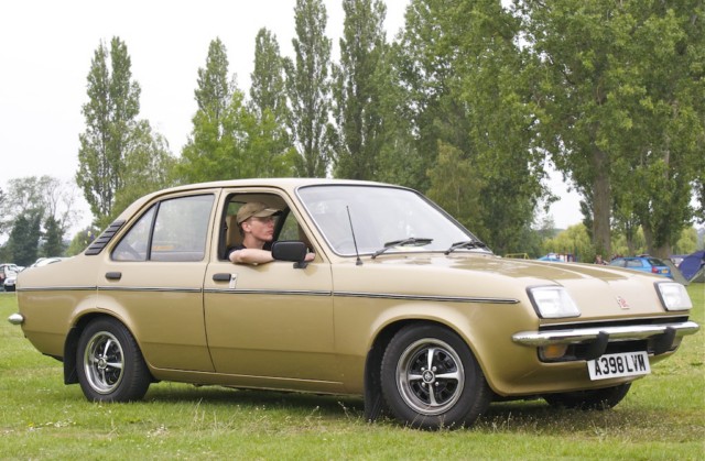

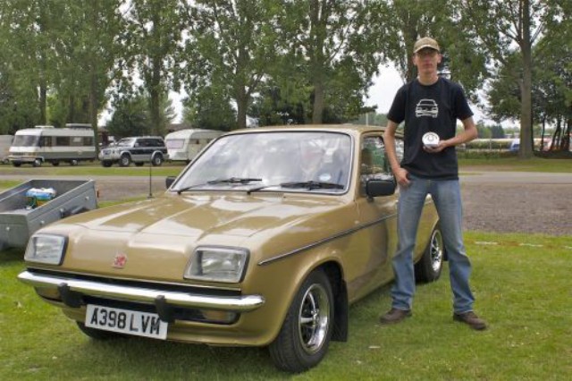

And finally here's a few of the Chevette.
The Chevette was restored between May last year and February this year. its and 'L' auto and it one of about 12 still registered with the DVLA and only about half of them are still taxed. It has been restored to GL spec so now has rostyle wheels, side moldings, back panel finisher, headrests 2 door pockets etc. Its the trusty 1256 lump and has about 63K on the clock. and im owner 10. I actually met one of the previous owners at the VBOA rally at Billing in July who hadn't seen the car for about 5 years and was pleased to see it had been restored.

Its just had new springs fitted on the front, so its sitting at the right height now, the old ones had sagged very badly, but at 27yrs old it is to be expected.

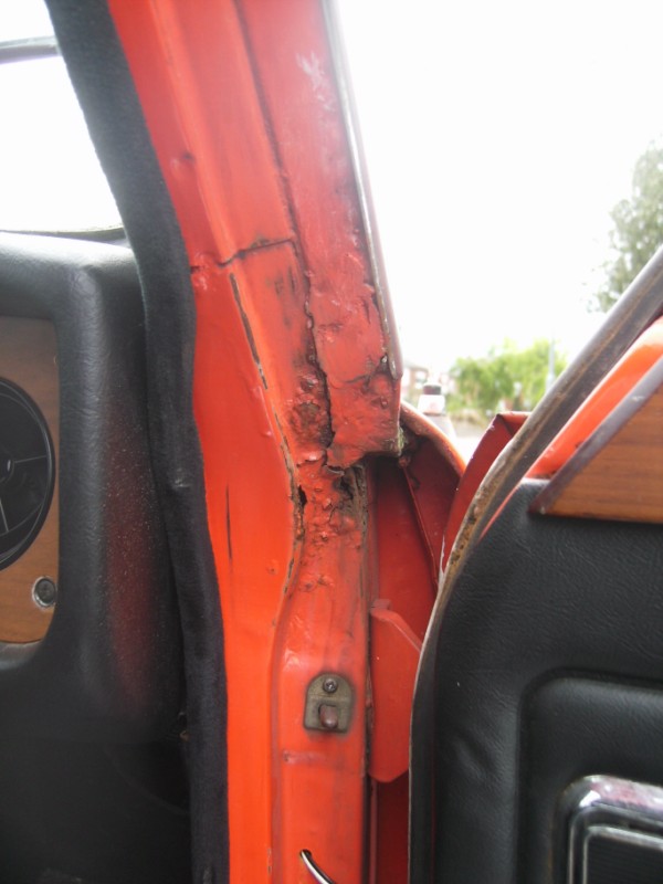

Don't throw those doors away the damage is only at the bottom and we do part skin repairs (£22 each including delivery to members for one) that replace everything below the lower swage, you'd need to reconstruct that passenger frame though. If you replace the doors you will be playing with shut gaps for ever and a day!

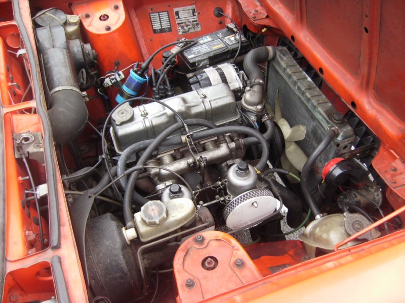

I've noticed that it has pancake filters. If it has standard needles then the mixture might be too weak hence the poor performance.
Re: Newbie
That had been suggested to me, but just havent got round round to doing anything about it yet. It came with the original air box and new paper filter, so i've always got the option to change back to that too.

The rust issues with the 1500 look significant. If you are up to doing the work yourself and have the time (and money) to fix them, it will be a great project. Are you considering going the whole hog and fixing the car entirely ?

The original plan for the car was to do a full job on it as I did with the Chevette. However currently Im considerring selling it once the welding is done and its MOT'd. But time will tell
