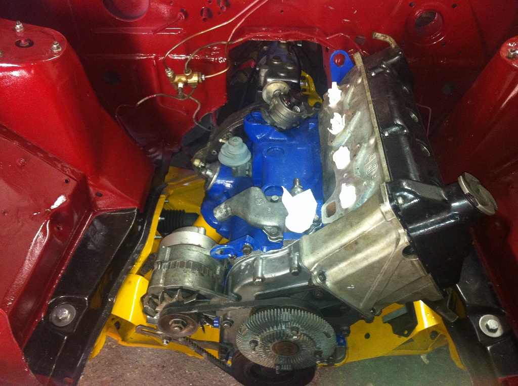

Hi everybody, it is time to put some update on the forum about the restoration of a Dolomite Sprint. The Dolomite 1850HL is not being restored but actually in full service ! It has been used for vacations and work and of course it broke down several times but as many times repaired. It is tomorrow December 5th and that day makes our Dolomite 1850HL a 40 year old car, which means cheap in tax !
The reason that I did not update this forum is that I was (and still am) very very busy studying at the University of Eindhoven and really that's taking my time entirely. I couldn't work on cars either because there was just no time. But my father (he's also involved in this project) has done some work on the Sprint and he will update this he said with some pictures.
Greeting

Wow! What a colourful engine bay!
