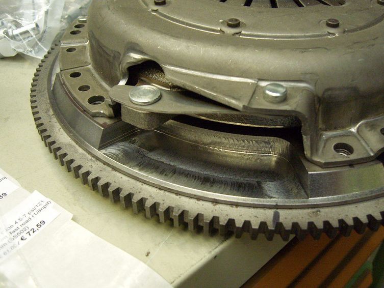

There's quite a bit more you can take off.Std flywheel weighs 9.6 kgs whereas my lightened one weighs 7.8 kgs.
You can see on the front that just a large chamfer has been removed around the edge...
...and on the rear a large scallop has been removed from the middle...

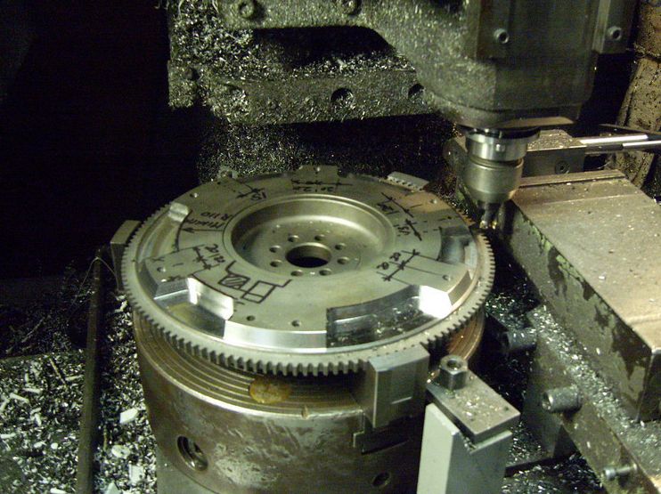

As it happens, my flywheel is having some more taken off it as we speak, along with some balancing of the crank, rods etc.soe8m wrote:Be patience. There's not such a thing as a too light flywheel on a dolomite.

A friend made a program for a dolomite flywheel. Mine are machined from the back like Martin's one and at the front big recesses are machined out. These areas do not add anything to the strenght and have the maximum effect as it is at the outer side where the acceleration and deceleration of the rotating weight is the highest.
