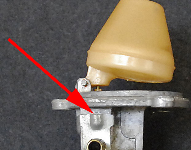

Here is a photo of two float chamber covers each fitted with the same float and float valve assembly.
20130909-4352Ptw Carburettor cap assemblies.jpg (119.39 KiB) Viewed 1627 times
Perhaps I thought, the left hand cover would be machined differently to allow the float to sit higher, that is when inverted back into its correct position it would sit closer to the float chamber cover. (Which would overcome the issues raised by Jeroen)? This photo is somewhat distorted for it shows the float sitting closer to the cover in the left hand picture however when I measure the float height from the body the left hand float sits 5.00mm or 0.1969” away from the cover. The right hand float measures 4.76mm or 0.1805”. The reverse to what I had expected but which tells me that when the holes for the float valves were machined and tapped that there is possibly something like a 0.010” – 0.25mm tolerance in the allowable height on both.
Note!! No vent pipe on the left hand cover.
Jeroen has also provided a very handy link to an earlier thread in which VanIsleSprint quoted some figures from an SU manual. The figures quoted, if I read them correctly, suggest that the floats on these two covers should sit somewhere between 0.062” 1.57mm and 0.187” - 4.87mm. It is clear I have the right needle valve assembly but that on the rear carburettor cover I should remove a washer under it if I want it to sit within the band nominated.
It should in theory be possible to swap the two covers and the carbs should run satisfactorily. I am loathe to try this and risk having fuel spill above the alternator!!

#18 Post by Robert 352 »
I am feeling a bit daft now for I have located the vent on the left hand float chamber cover.
20130909-4352Ptw LH Carburettor cap assembly.jpg (145.93 KiB) Viewed 1626 times
It simply vents onto the top of the float chamber cover.
Clearly my problem is the float needle valve assembly which is not closing off from time to time. And when it is not closing, it is spilling fuel. So I shall now try different needle valve sets to find a set that seats.
Perhaps I need to go back and check the filter on the top of the fuel pump. However on my initial check there is nothing in the bottom of the float chamber which might suggest that there is some sediment coming through from the tank or the fuel lines or the pump itself.
It is odd though that it does not vent via a spill pipe down below the engine, as does the front carburettor.
