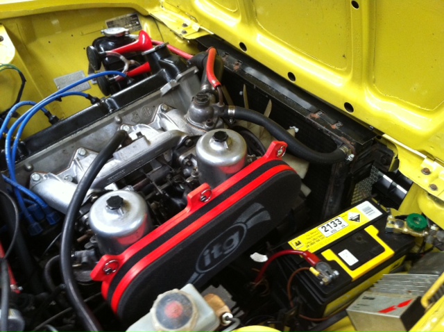

This gives you an overall view of the carbs installed. Needed a narrow air filter to fit the reduced space so the trumpets could not be fitted. I renewed the engine mounts recently and now the front carb hits the bonnet at idle. I can't tell you much about the setup as the carbs came set up on a modified manifold and attached to a modified head - I haven't done anything other than install and run them as is. I can tell you that the fuel consumption is around mid 20 mpg whereas my standard car does 33 routinely. The engine with the 2" carbs is attached to an auto though. Drives well, no hestitation or hiccups so was obviously setup well at some stage. It is lumpy at idle but I suspect that is due to the cam rather than carbs. It really flies at speeds above the legal limit.
I have never really got around to sorting out the choke. It is only connected on the rear carb and often needs 'engine start' spray to fire up after a couple of days standing. There was a thread on this with some good advice:
viewtopic.php?f=4&t=19042

Thanks guys, some pictures always help me to understand better. Keep them coming.
