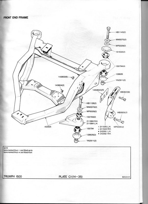

Bodgetastic for sure. I don't have a 1300FWD parts book but I would expect it to be something similar to this.
The subframe is different to ours though so it can't be the same.
Actually, I've a Heritage DVD here somewhere, that should have the right book on it....

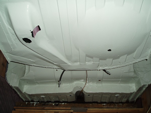

Hi Jeff, I brush painted the underside and really chuffed with the finish. It took 3 coats but has smoothed over the number of welded joints and rust pitted original metal. Have attached another photo.
Appreciate all the comments posted.
Pete
Finished underside before subfame and suspension installation.

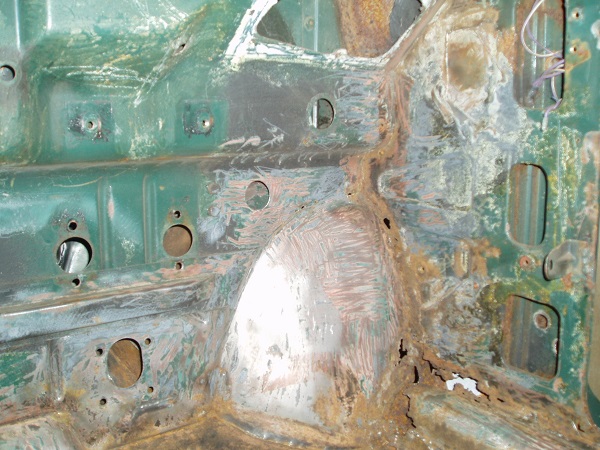

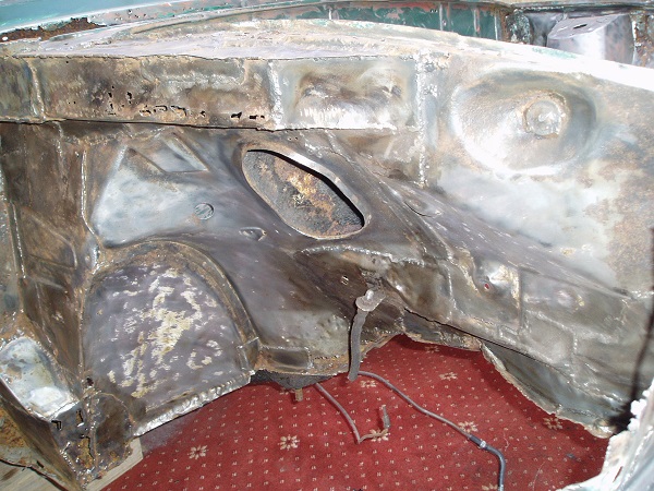

Have now turned the car around in the garage so I can access the front end. Spent 2 whole dirty days scrapping and angle grinder brushing years of crap, mastic and underseal from the wheel arches, inner and out, engine bay, front end in and out, footwell and under dash area. It is now obvious that GiLberT has been repaired many times before as patches are abound, the disappointing thing is that after repair they have just covered the area with mastic and underseal to make it look nice. But all it did was to seal in the rust and it continued to rot so now I have lots of welding to do! At least by the time I have finished, the body will not need attention for many many years. So for the next few weeks I will be cutting the rust out, treating the area and then welding the areas as strong as I can make them. Paint with Zinc and top coat, then plaster the box sections and inner areas with waxoyl, will post more piccy's then.
O/S footwell
O/S footwell

Inner O/S engine bay
P1010011 (3).JPG (139.73 KiB) Viewed 4687 times
Inner N/S engine bay
P1010010 (3).JPG (100.45 KiB) Viewed 4687 times

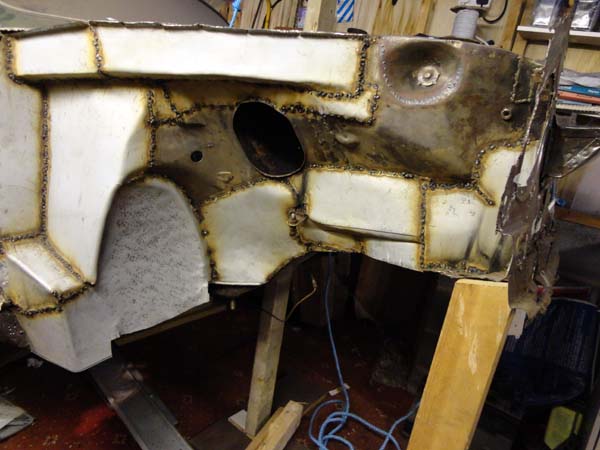

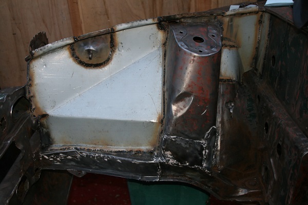

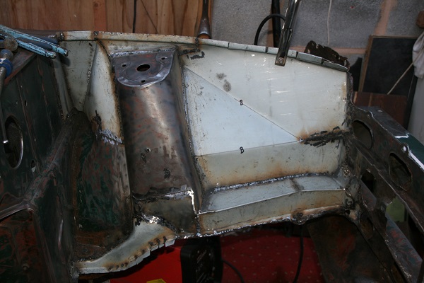

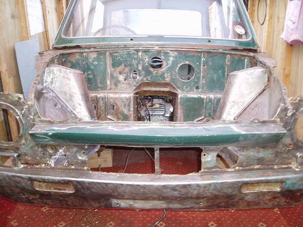

Work on Gilbert has been put on hold for a bit due to building a new conservatory base. The conservatory will be delivered early April, so will have a few days before then to catch up. Managed to do quite a bit over the weekend and have attached some photo's. The whole front has been patched up over the years either through front end bump or rust, so have decided to line the inner bulkhead with as much zintec steel as possible and patch up under wing areas. Then when finished with lead and chassis paint, to drill into cavity and inject with waxoyl, this should then last the life of the car. The passenger side is finished, just tidying up of welds to do. The drivers side needs plates making for top of suspension strut and lower box section, then onto inner wings!!! The sills are not too clever so have bought new outer ones and door bottoms so lots still to do....
Passengers inner wing, which is finished, just needing tidying up of my welding.
Drivers side inner wing to be finished.

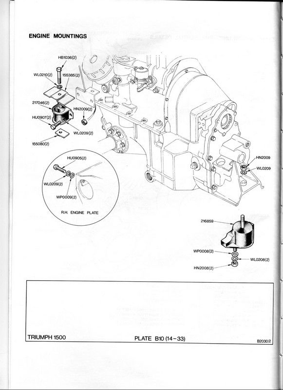

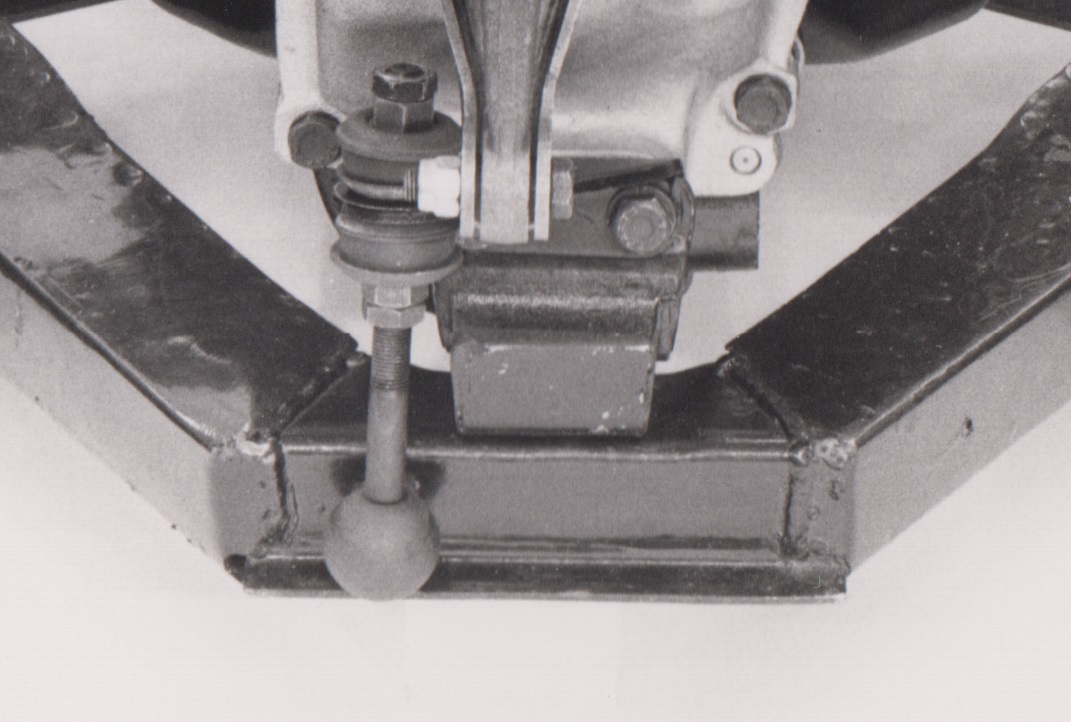

I have to say you're doing a smashing job there, these cars always seem to go in the same places but i must admit I've never seen a trailing arm fail like that ( and some of us try quite hard to break things ;) ) I do believe rimmers may have new rh trailing arms in stock, but i doubt they'll be cheep. Also Tinweevil has led you astray with the rear engine mount, the diagram he posted is for a 1500fwd which is slightly different, the 1300 one is shown below.
Gordon
Rear subframe engine mount.jpg (179.2 KiB) Viewed 4565 times

Many Thanks for photo, Gordon. That certainly helps. The trailing arm was totally my fault. I wanted to take out all bolts on the car and de-rust so in future any repairs would be simple...... The bolt was really seized in and I did consider to leave it as I could still take off the other side plate to get to the shock. I did have the trailing arm supported, or as I thought when I gave it one last hit with large hammer........ We learn something every day often by mistakes - must use smaller hammer next time!
I think my repair should be good enough to support the shock as on the other end of the shock there is only a 5/16 nut and locknut holding the shock through the bulkhead, fingers crossed.
