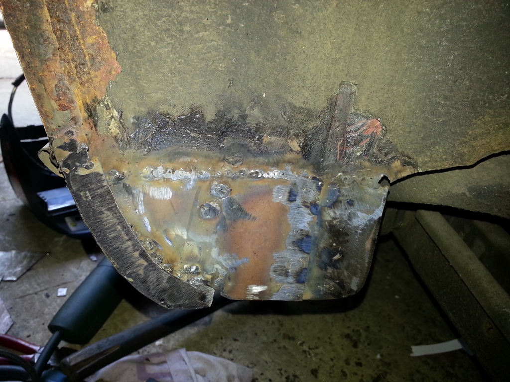

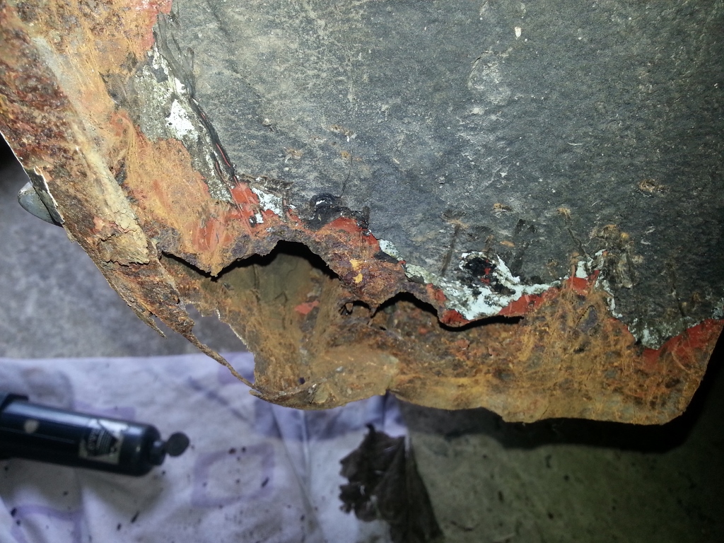

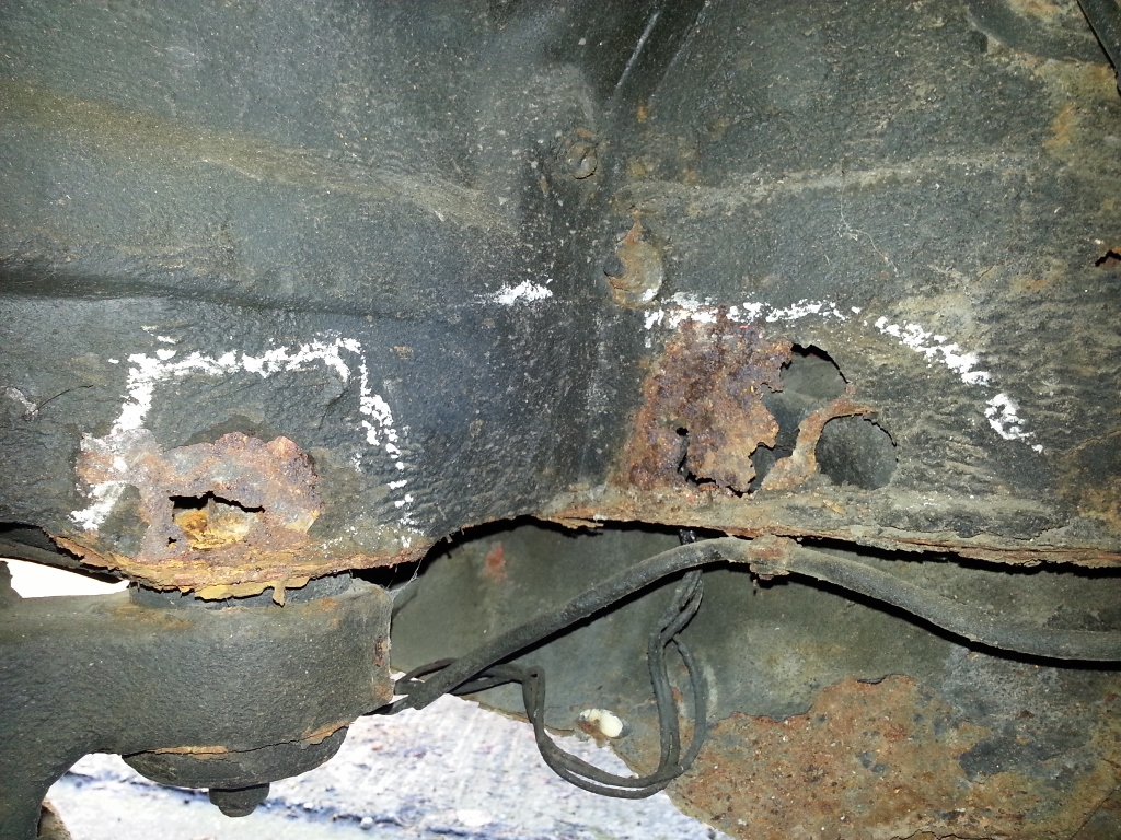

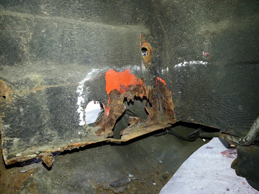

Got a little more work done on the dolly this weekend, this time on the n/s/r arch, here's some pics...
Re: Ice Blue Dolomite 1850 auto
Ive still got the back half of the n/s/r arch to do ...

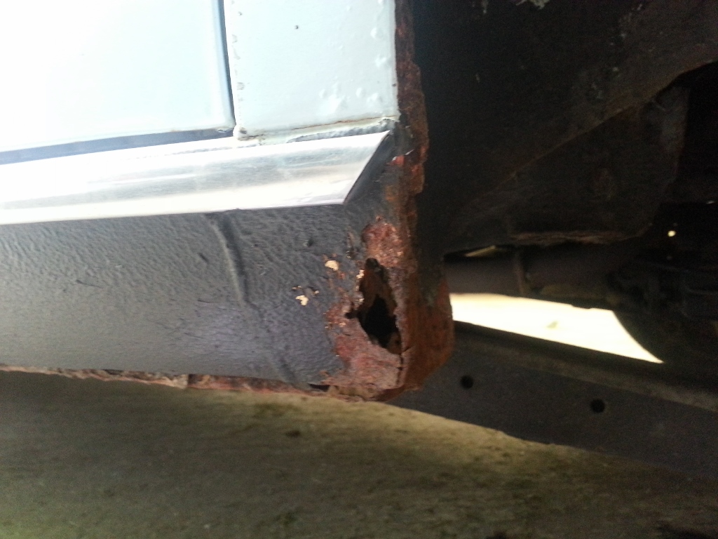

well that didn't go to plan... big fat fail due to more welding needed under both front wheel arches, one of the rear tyres is a different profile to all the others, one of the front tyres has a deep cut down to the cords, the front and rear brakes are imbalanced and the handbrake is only working at 23%, nothing major but bloody annoying as i was due to take it to a car show on Sunday

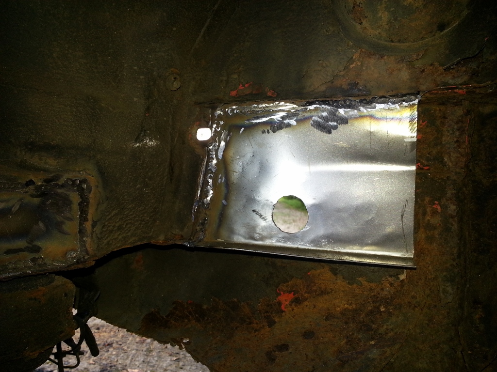

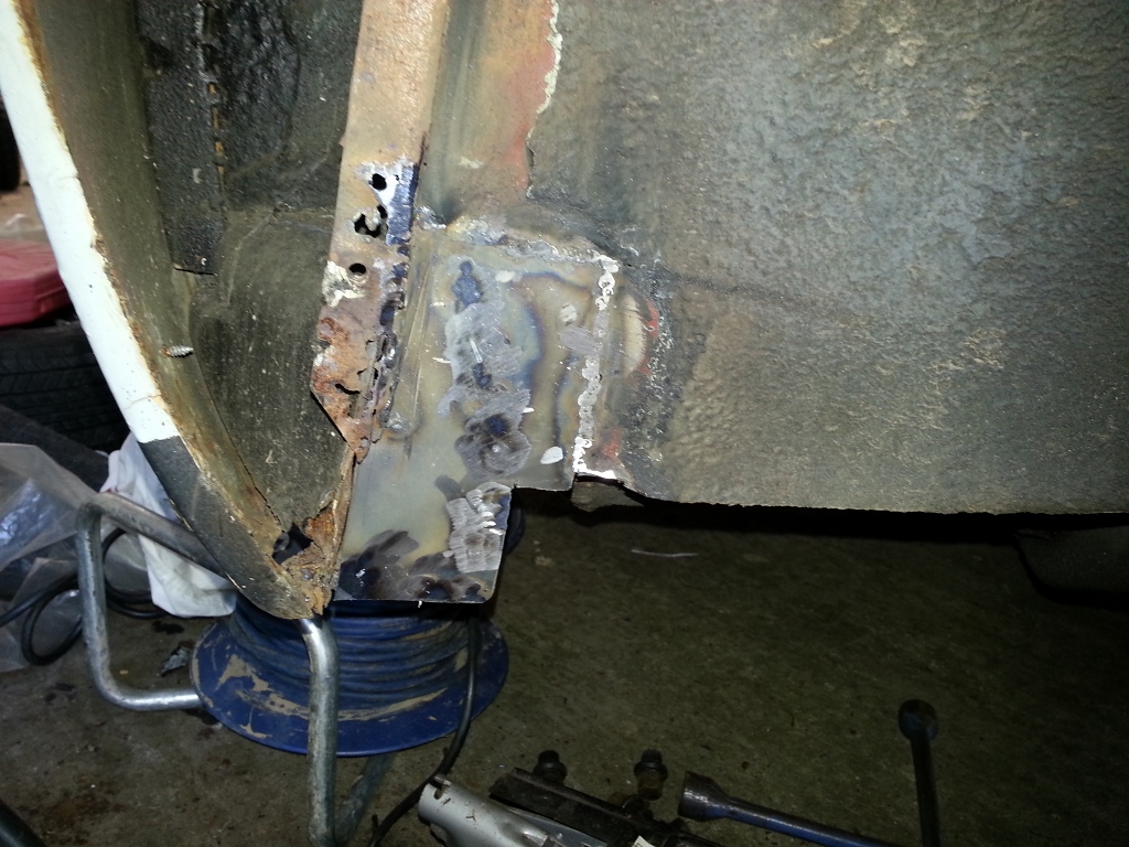

yes got a bit more progress done today, all the welding is done now an rear brakes, just need a front brake caliper for the n/s, heres some pics, i forgot to take pics of the finshed article painted and sealed etc but heres some progress pics...
n/s/f arch is all now welded but didnt take anymore pics after this one ...

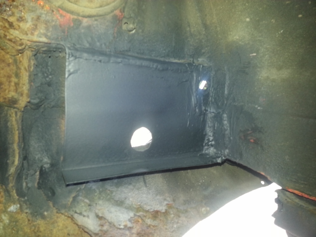

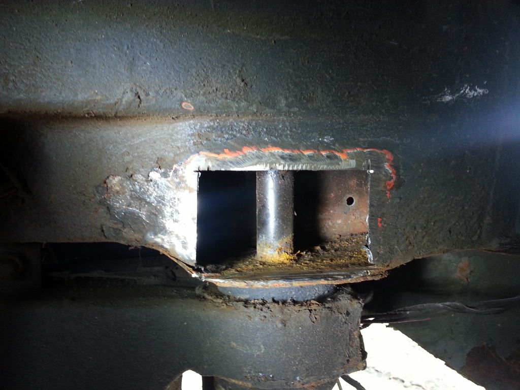

Heres the finished pics of the welding:
Also have now fitted the replacement N/S/F brake calliper and finished off all the little bits and bobs, my dad took the car for a retest today which it failed due to other things they didn't even mention before !
