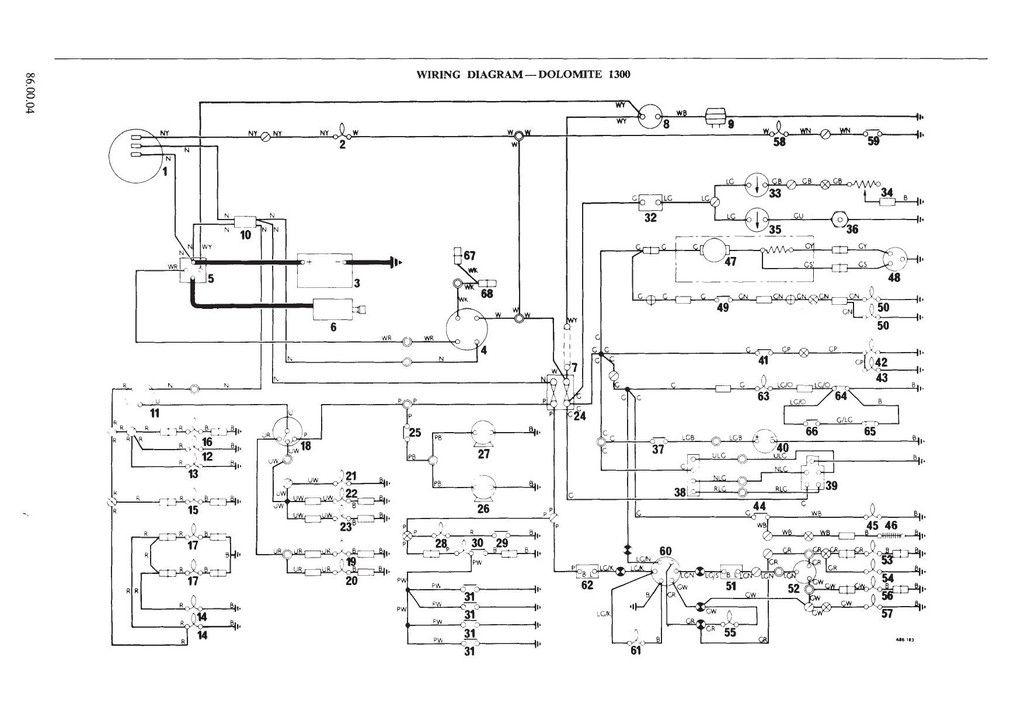

It is a late Dolomite 1300. Hopefully, the wiring diagram from the factory workshop manual should help.
