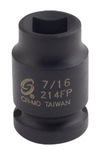

The gearbox bung. I would be very wary about using a standard socket on the bung for unless it is a four or an eight sided socket then at best the socket if it is a six or twelve sided socket will only grab on one of the four corners of the bung. And if it slips you will finish up burring the bung corner and so make it more difficult to remove in the future. The correct socket can be bought for not a great deal of money, I found mine on eBay in the USA. It’s called a female pipe bung socket and looks like this.
20131224 Sunex 214fp pipe plug socket.jpg (7.71 KiB) Viewed 423 times
Works a treat on, in my case, both the sump and diff bungs too.
