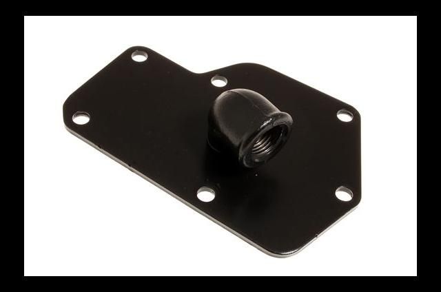

Any ideas on this jobby.....http://www.rimmerbros.co.uk/Item--i-TKC1242U ?

shaunroche wrote:Good - is that this one from off a TR7 that Rimmer's are alluding to? http://www.rimmerbros.co.uk/Item--i-TKC1242U It will fit a Sprint head then?
No it does not fit.

The only solution for the back of the head then is to drill a hole in the plate and put a bulkhead connector/elbow in then?

The TKC1242U plate is (I think) the one you want, Ian says it doesn't fit an 1850 and I believe him, but I'm reasonably sure it fits a Sprint head, I'll do some checking and get back to you, it has just occurred to me that it may be a special one needed for TR7 Sprint (a much rarer car) There is still a removeable plate on the back of the head which is thick enough to be drilled and tapped and an elbow fitted anyway and this would solve it.

I'm not sure about this top hose business, but I'm ok with the idea of putting a fitting in the head plate providing I know where abouts on the plate to put it!

Have just been trawling through Tony Burds restoration thread (MSO 662P in the resto section) On page 10 is a picture of the plate he used and its from a TR7 Sprint so may be hard to find. But it gives you an idea of what to do and where to put it! Later on, page 14 and later are several shots of hose runs you may find useful, his car is very like yours, except he has kept the stock water pump which only alters the position of the heater return, but he has the Saab rad and Weber/Dellortos. He hasn't bothered with the third pipe on the stat housing and the car has been fine, on the road for nearly 2 years now.

Tony sent me some of those pics so I should have remembered about the third, blanked port....at least now I know where about's to weld the elbow into!
Edit
Look what I've found!
http://www.rimmerbros.co.uk/Item--i-RB7240
Think I can probably make one cheaper....£37 + £25 surcharge + vat + postage.....

Ouch! Rimmers certainly know how to bear down on the pen! And the surcharge, which I assume is refundable means they want yours back so someone can spend an hour and about 20p converting that to sell for umpteen quid! Do it yourself mate!!!!
