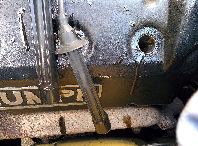

Had some Sprint time allocated this Saturday to tackle the annoyances first, steering wheel shake and the oil leak.
To rule out the obvious with the bad steering shake, I had the wheels balanced, which was an interesting experience. Though a helpful crew, their computer refused to show them the torque settings for the wheels (steel bolts so we guessed at 75nm), and the tyre pressures when set properly, well, the car handled as if Chivers made tyres and wallowed more than a hippopotamus on a David Attenborough show. Clearly 1970's tyres had very different construction to that of modern tyres, an extra 6 psi all around seemed to sort that out. Sadly though helping a little with vibration, it has made no obvious difference with the shaking and steering column rattle, which is still there but moved now to mostly around the 50 to 60 mph mark. Because it sometimes smooths out and changes on sweeping bends, I strongly suspect some front suspension component is at fault, more investigation needed.
Had a good look underneath too, all seemed to be in very good condition, the entire underside is painted in a smooth but rough paint, which is solid and not flaking anywhere.
Started to tackle the oil leak by intending to fit the replacement gasket kindly supplied by Alun, removal was fine, once I managed to find some imperial allen keys in an old tool box. Plug leads out and oh dear, they looked a bit oily. And the spark plugs appeared to be doing the backstroke. Cam cover off and the obvious cause, spark plug tubes mostly constructed from instant gasket by the looks of things. Still, cover off and the valve train looked in reasonable condition. Though puzzled as to why number 3 cylinders cam lobes are black and slightly porous looking, but it does feel smooth, the rest are all shiny and silver. Poor picture as camera struggled to focus. Oil has stopped play at this stage, whilst I decide to either 'borrow' the spark plug tubes from my spare engine arriving on Monday, or bite the bullet and spend £114 from Rimmer, £52 from ebay or £60 from TDC on new ones. I'm going to guess the TDC route would be my best option as you lot wouldn't fit them to your own otherwise!

I'm afraid the sights you have displayed there are pretty typical of the standard fit tubes after several years....
Its funny how the plugs dont seem to mind too much being immersed in oil like that. Mine never has. Be careful what goes round the tubes in the way of temporary sealant. You don't want to block up any of those oil ways in the rockers. I have had to replace a few cams in my time because of that. A blocked finger will soon knacker a cam load so keep an ear out...not saying yours is on the way but it does need monitoring.

You know Jonners, I keep looking at the old tube in front of me on the desk and thinking that I could easily clean off the remains of the old rubber bits and slip on a couple of O rings held in place with PTFE, encouraged by that £60 cost... But, in the same way I shook my head and thought what a bodge job, what else have they bodged on this car? I don't really want to be that person myself!
I did wonder about the presence of oil doing any harm, I mean it it's not conductive so wouldn't cause an arc, and might even stop the connector corroding. Mind you, as a wild thought, oil is a good conductor of heat, and that might upset the heat balance of the plug perhaps?

Not that much to report this week. Confirmation that the oil leak was purely down to the rocker cover gasket, quantity of oil and difficulty of spotting a leak location was purely down to the fact it was leaking along the full length of the bottom cover edge.
