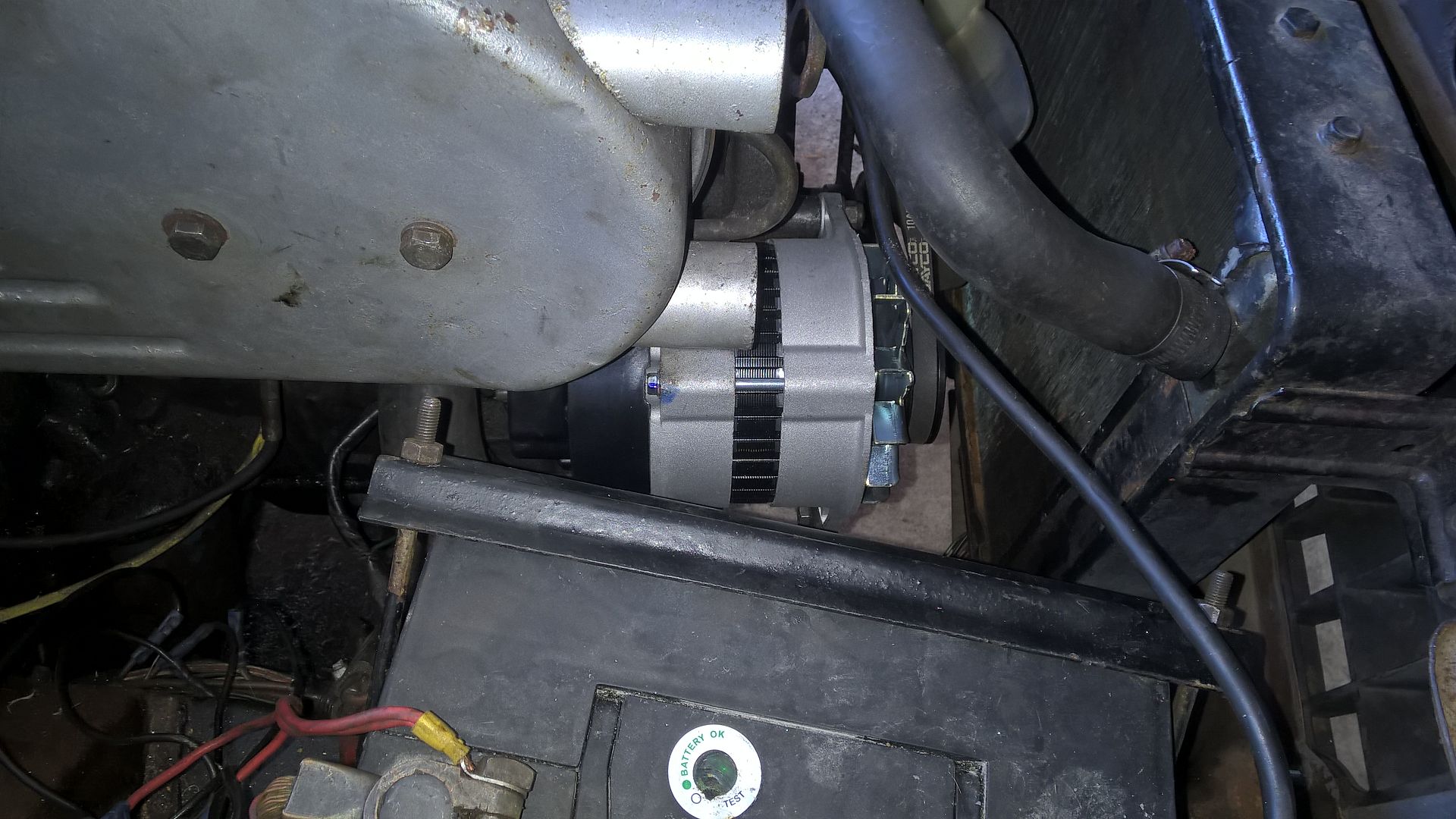

It was pretty much a straight swap and the pulley on the new alternator is a bit smaller than the old one. I'm getting 14.5v when driving which goes down when I switch the headlights on but the ignition light doesn't come on no matter what the voltmeter is reading.

All this talk of alternators, has everybody uprated the wiring to suit?
The original alternators were what? 30A and now we are sticking 50/75 or even more amp alternators on.
That means if the alternator is charging at max current, you are shoving at least double or getting towards triple the current down the loom. It is potentially rather hazardous.
Best bet when upgrading an alternator is to add an extra wire from it (ACR types have a spare terminal, very handy) direct to the battery. 40-50A wire is ideal.
Of course, there will be many who are running oblivious to all this, and you may be OK as long as the alternator doesn't have to work hard. But there is no downside to the extra wire.
Me, I am running one of the Brise motorsport Denso 40A jobbies. Actually sold as a kuboto digger alternator. They are small, light and will easily outlast the car. (this is after I had several bad experiences with genuine Lucas recon alternators a few years ago. Won't touch one again)
Well, that extra current only flows to the battery to charge it quicker, and, perhaps more importantly, keep the charging voltage over 13.8 (ish) at lower rpms and with more stuff on. The rest of the loom, even the cable to the starter, is carrying the same current as before. That is, unless you've added more stuff or increased the power of what's there.
Looking at the feed and return to the battery, that looks well up to carrying the 65 amps this new alternator is claimed to give.

Indeed, normally it won't be booting out the full current. However, it may only need to do it once and for a shortish time (few minutes) to cause an issue. Besides, an extra cable direct to battery can only improve matters.
And I very much doubt the original cable is rated at anything much over 30A continuous. Cable was expensive even back then!
As a precaution I would only change the positive and negative battery leads, if they are the originals on the car. They do corrode down the ends.
Shouldn't need to really as, the battery once even patially charged won't draw that much, and the whole car only can draw up to the max amperage of the fuses installed.

I know I'm putting in a large stereo and lots of electrical in my car, so for me it's a must as I'll have a running 60 amp draw, 10 in idle.

While an alternator can in theory put out 65 amps you have to work out if it ever will.....
Max load is all your headlights, side lights wipers, heater fan, heated rear window and one set of indicators plus your ICE.
You could add some peaks for brake lights too, but you shouldnt have them on all the time, plus overdrive and fog lights..
I'll let you do the maths....see what you come up with...
The very most extra current a charging battery could ever possibly draw would be about one third of the extra capacity of the alternator - if the alternator has an open circuit output of 15 volts and the lowest voltage for a chargeable battery is a very, very pessimistic (probably ridiculous) 10 volts. So in going from a 45 to a 65 amp alternator, the extra current flow into the battery is not 20 amps, but definitely (much) less than 6.7 amps. And that, as a fraction of the maximum current the system and charging battery could draw, isn't much at all.
