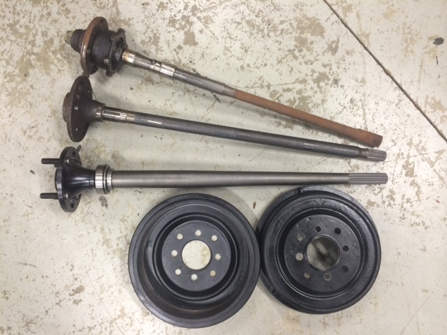

- Posts: 402
Re: Axle power rating
It was just as I thought I had one laying around, turns out I didn't. Is it possible to use jag independent in conjunction with triumph Drop links so I can claim I have standard suspension with an additional support for the different axlepaulsprint wrote:Why use an English (unless it has a lsd in it and proper half shafts) as standard It's not that strong. Not compared to an atlas or a sprint axle. Also a sprint has semi floating half shafts so be wheel bearings are much stronger
