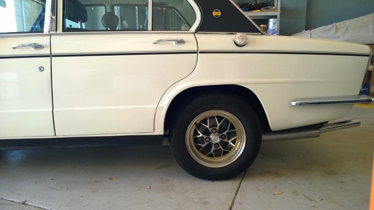

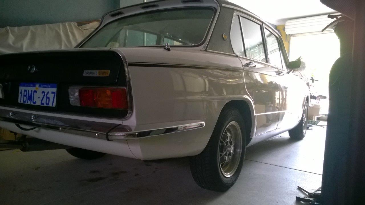

Thanks everyone.

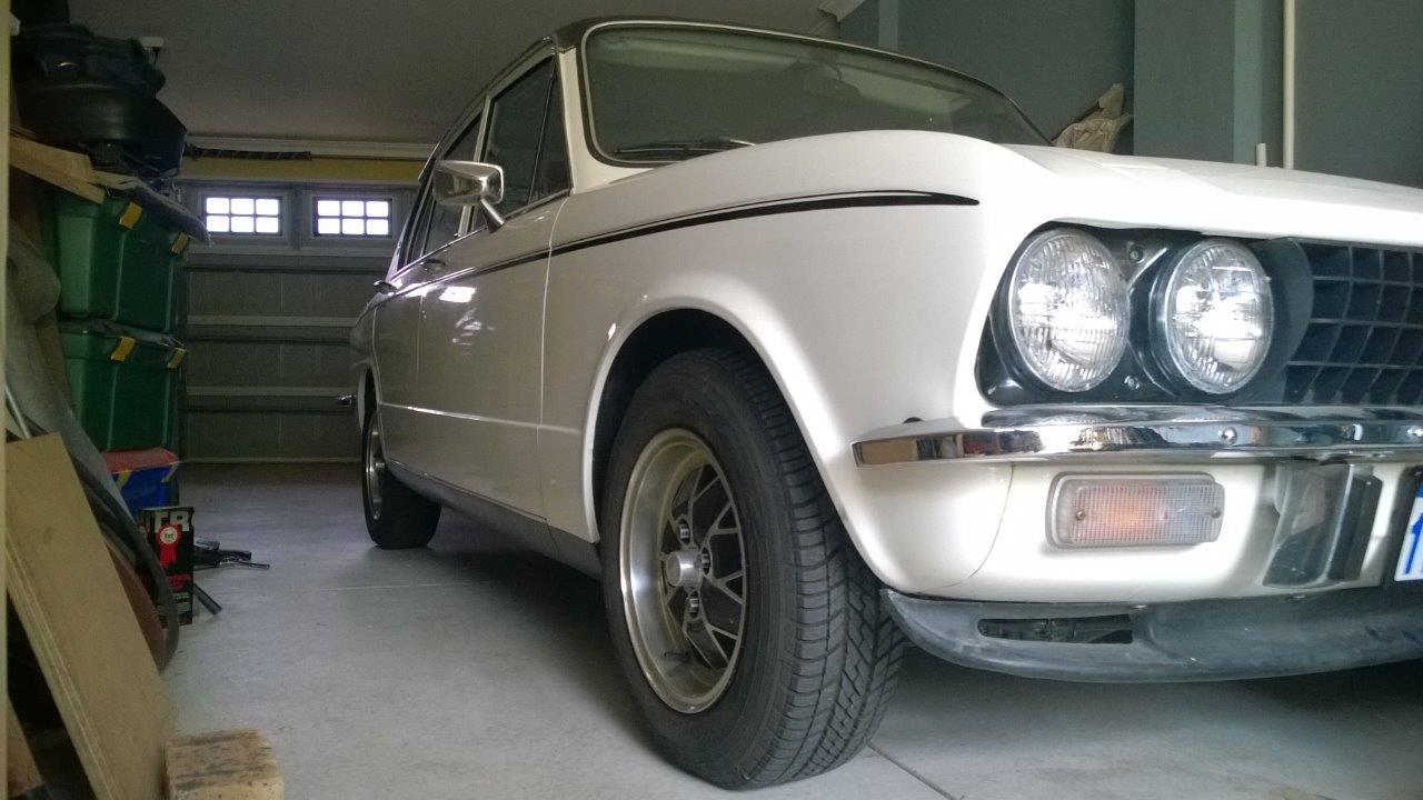

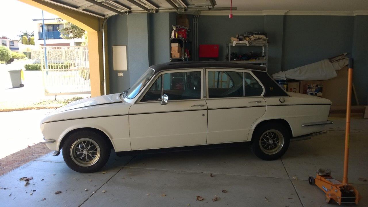

Here's what it looks like right now.
ride height1.jpg (104.94 KiB) Viewed 1676 times
ride height2.jpg (94.08 KiB) Viewed 1676 times
ride height3.jpg (100.1 KiB) Viewed 1676 times
I'm happy with the back. The front might get a raise :-). I'll wait for it to re-settle a bit first

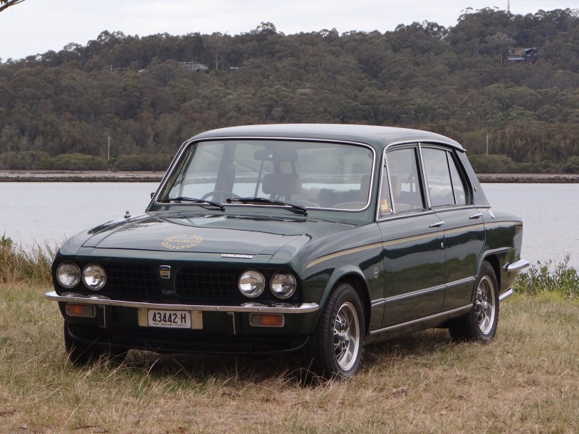

Measured on flat and level concrete, the ride height from the wheel centres to the top of each wheel arch is 335mm, all 'round.
The pic attached shows the car, but obviously not on level ground.
I like the way it sits, (& rides) but after reading this and other threads, I suspect that the springs have sagged over the 40 years.

Re: Ride height
#20 Post by tony g »
The stance on sundowners looks good to me. Ol if youre happy with the rear height adjust the fronts to get level sills and job done.
Remember though that front ride height is going to change the tracking quite a bit so recheck after any height adjustments :)

Re: Ride height
#21 Post by olr159w »
Thanks.
My intention is to raise the front a bit more so that it is more or less level. I think the rears on mine look higher than sundowners and yet they sit at 325 to his 335 so its deceptive. But whatever, I think they are going to stay where they are and the fronts can come up to meet them.

Re: Ride height
#22 Post by Jon Tilson »
Yep fronts are at least an inch too low....
Its a labour of love. You will get there. Happy to tune it for you...PM me re when and where.

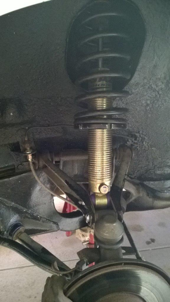

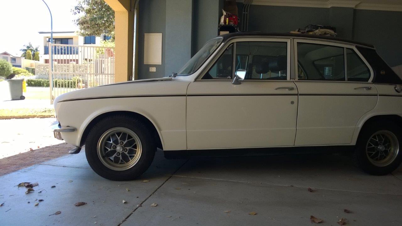

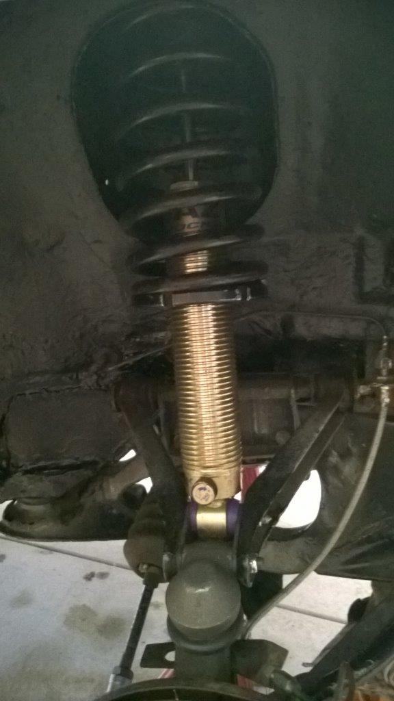

Well its done. Not the best angles but here's some pics :
But here's a shot of each shock. They are wound fairly high I guess although I read somewhere that Gaz shocks have short bodies. However, one side is still different from the other. From bottom of shock tube to adjuster seat the NS is 125mm whereas the OS is 151mm
I can't fix that. It is what it is.
I think it's odd though. To me it suggests a twisted chassis or something but I'm not even going to think about it.
Also I feel I should bare my soul about driving it with the tie rod ends only finger tight. I could have sworn I tightened everything. Very very very luckily, having gone round the block etc, one steering arm only popped out when getting into reverse to back into the drive again.
Could have killed myself. Humbling experience. My daughter was in the car at the time also.

Another thing you have missed - the locknut, your picture only shows one - you should have two fitted and they lock together
