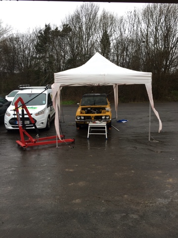

My hand has finally healed enough to use, so started to get the engine ready to take out.
It was all going well until I got to the bottom bolt on the exhaust to manifold joint. Whoever designed that should be shot!!
So after getting soaked and nearly blown away finally called it a day. I did some research online and removing the engine and sub frame from below now looks like a better option.
Any advice would be appreciated, at least I can do all the bushes whilst it's all out and refurb and painting of all the suspension.

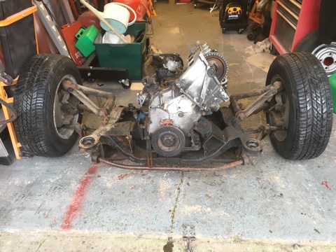

Re: VGK Sprint Restoration
Just lift the engine out with the downpipe in situ. It will be easier to remove with the engine out of the car. If you're going to renew the subframe bushes get the Super Flex ones. I fitted them last year when I had to have a couple of my subframe mounts repaired. While the subframe is off you can check the condition of the chassis legs. The Club do these for £80 per side. I had an offside one fitted in 2014.
Thanks for the advice, got the bushes you recommended.
All the sub frame, engine etc all out and in bits now. Now got to clean it all before painting. I might get the sub frame blasted and might even get it powder coated to.

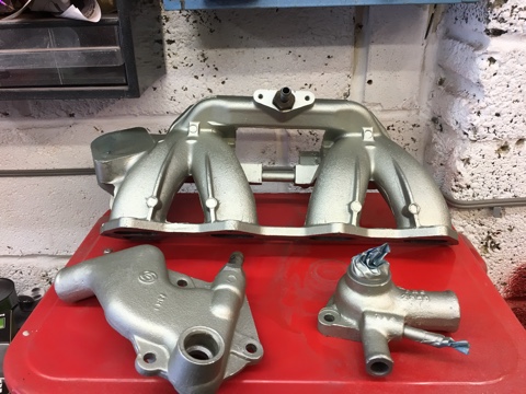

Yum those ally bits are really clean and shiney.
How did you do that?
Looks like silver spray paint, as some of the masking hasn't been removed yet.Jon Tilson wrote:Yum those ally bits are really clean and shiney.
