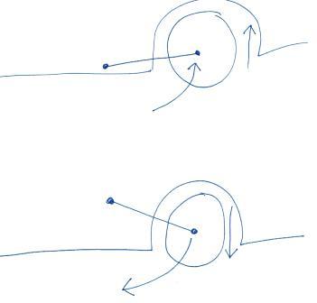

The next drawing is my theory. The front wheel are locked for simulating maximum resistance (accelerating)
The upper drawing the wheel when turning pushes the link to above, the same as lowering the backend. The lower picture the wheel wants to roll under the car so pushing the rear up. Pushing the rear up will put the same force on the road so more grip. So make the car not lowering the backend or less lowering by suspension geometry would give more grip thus a higher cornering speed. Lowering a std dolomite would make it more sliding at the rear.

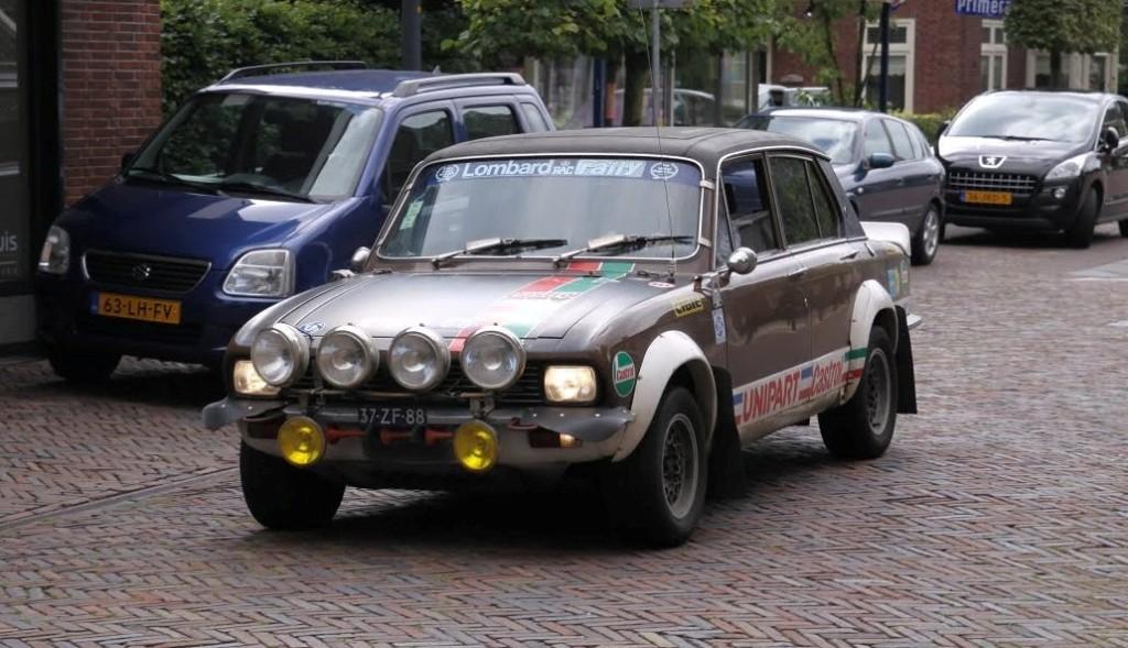

This was the actual highered dolomite for comparison.

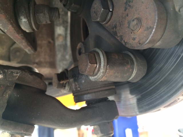

You asked about camber adjustment.
It is possible by inserting washers both between the subframe and the lower suspension arm, as well as between the vertical link and lower ball joint. See photos. In both cases bolt sizes need to be longer. You then need an adjustable end to the drag strut so that you have enough adjustment to get suitable suspension settings. Only really necessary in a track car, not a road car. Harder suspension bushes are also essential. A race setting can be used to keep more rubber on the raod when cornering, increase turn in, but also lose much of the self centering.
The main reason for not lowering the rear suspension more than one inch is that this would raise the rear roll centre to a point where the rear end is prone to break away - suddenly! The cure is to raise the rear tie bar chassis mounting which means it needs to go from below the floor to above, inside the car. Obviously there is the issue of cutting the floor below the rear seat and sealing this area from the exterior. I've seen it done successfully, but it is generally not permitted to change any suspension location in classic racing. Nothing that you would consider doing to a road car!
between lower ball joint and vertcal link.  Extra washer to compensate for longer bolt
Subframe to lower suspension arm

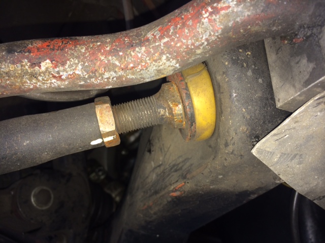

adjustable drag link end (plus thicker sway bar). Paint marks help as a quick check to something coming undone.
