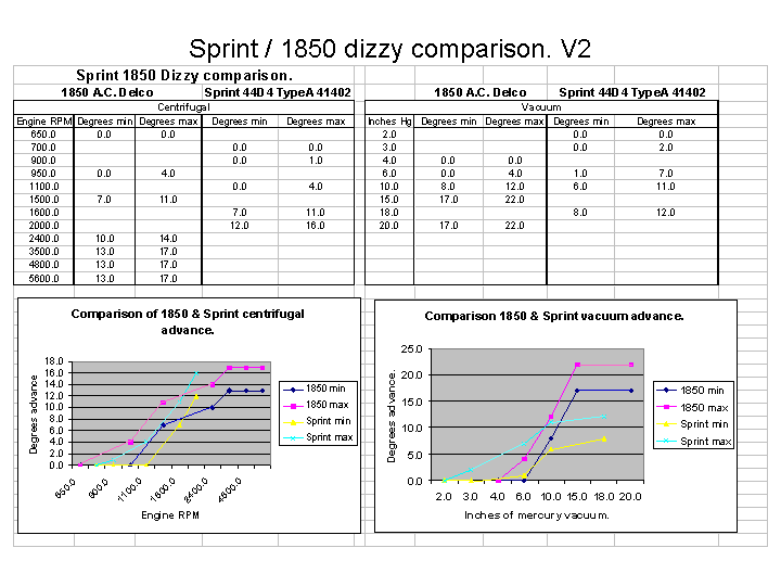

- Posts: 2338
... but is it a good idea ...?
I had another look at this swapping-the1850-A.C.-Delco-distributor- for-the-Lucas-44D4 unit today.
I'm not convinced it's a good idea looking at the data in the workshop manuals.
Yes; It'll fit.
Yes; It'll "work" ; but it won't be optimum for the engine.
The 1850 8 valve and the Sprint 16 valve units are very different.
The A.C. Delco dizzy is much better specified than the Lucas unit for a start..
And there are 3 different types of Lucas 44D4 Sprint distributors.
Type A 313177
Type B RKC 0695
Type C RKC 3034
I took as "typical" the Type A unit.
From the data below you can see the following.....
The centrifugal advance is on average less on the Sprint than the 1850 Delco Unit.
The A.C. Delco unit has a limit on maximum centrifugal advance.
This isn't specified on the Lucas Sprint unit.
The vacuum advance is a lot higher on the 1850 A.C. Delco unit cruising at 70mph or ~ 3000 rpm compared with the Sprint Lucas unit. This is to do with 70mph fuel economy on the 1850.
Given the choice of a well worn A.C. Delco unit or a new Lucas unit, it might be better to use the Lucas unit with the select-on-test advance springs that Moss do. What you do with the vacuum bit I'm not sure.
Yes; It'll fit.
Type A 313177
Type B RKC 0695
Type C RKC 3034
Edit: 2/06/20 updated graphs and corrected table for A spec dizzy.
- Sprint 1850 compV2.png (11.26 KiB) Viewed 711 times

Very interesting Tony, thanks for that. I didn't realise it was such a significant change as that? How is it that the 1850's run so well with the Lucas dizzy I wonder?!? I still have the slight missing at low revs occasionally at the moment with the 1850 dizzy, beginning to wonder if I should look to the carbs instead though! Thanks for the info

Tony, I didn't know there was such a big difference in the advance curve between the Delco and the Lucas 44D4 dizzy. I knew that there was a difference and mine is running fine. The main benefits in my eyes are the improved reliability and the easier access to the points (should I wish to run them).

Are you sure the oil light goes out if its working?
I'm not convinced they actually do run better.
Dave's car is an auto and doesnt by his own admission do a lot of motorway stuff.
My car is TR7'ed and I run it more advanced to cope with the lack of advance over the delco unit.
I may well stick a Delco with accuspark back in in due course...
