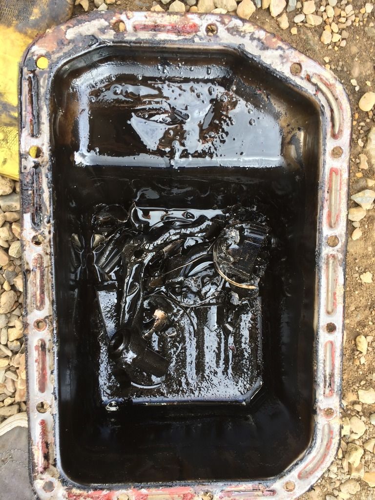

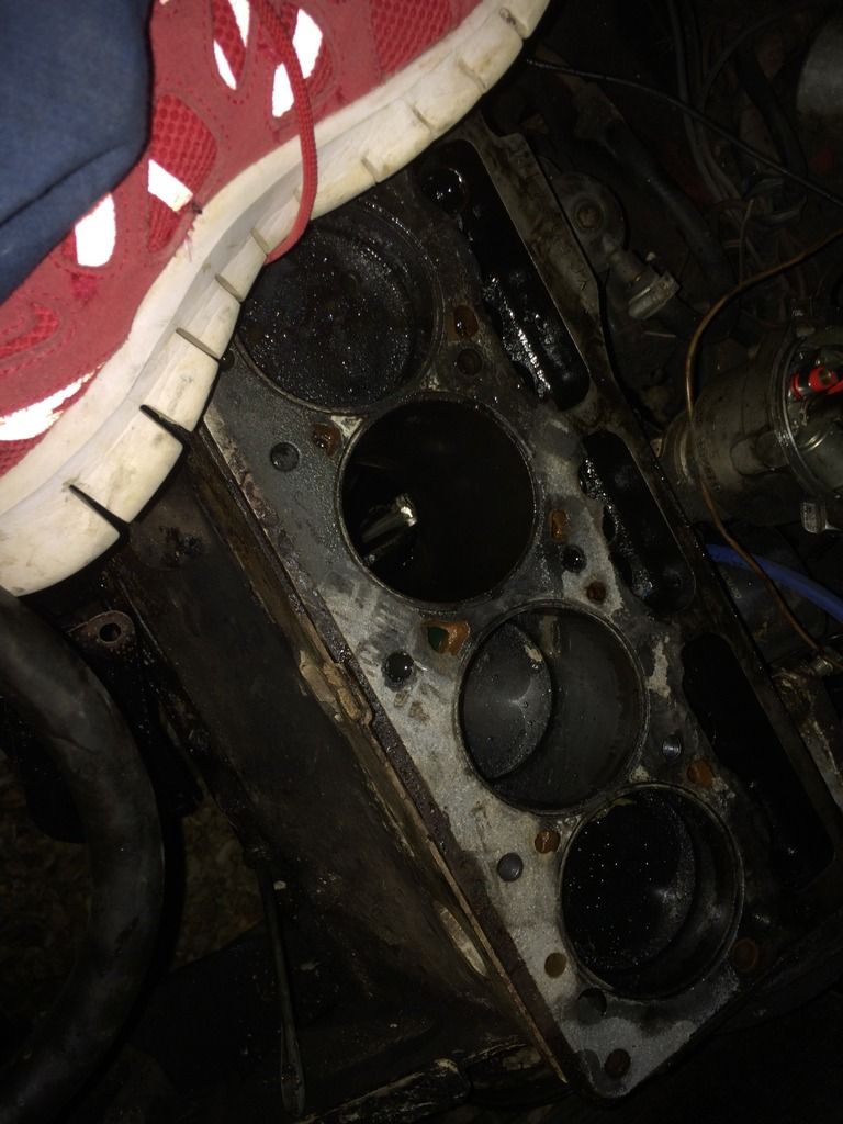

WOW !@!. The sump will hold the parts youre missing. Im surprised it hasnt seized up by now.

Re: Dolomite 1500HL SDT655S
Well, now it really IS only good for a boat anchor!
I've seen more comprehensive destruction from a piston failure, but that one is quite outstanding for NOT penetrating the crankcase!
There is no point in even thinking of trying to resuscitate that corpse, you need another engine!
Bad luck sir!
Bad luck sir!
You won't need a complete engine. If you can find a block with pistons & crankshaft you can clean up and reuse your cylinder head. If a complete engine is available you should grab it anyway. At least you know what the problem is.

It will get you out of trouble for a bit. I would say that could be resleeved and reused with a new piston.
Reminds me of a Daimler V8 I once had in with a mild mis and a slight blue haze from one exhaust. But in that one the gudgeon pin and con rod were still going up and down in the bore. The piston had come to bits and done a fare job of decarbonising the head on that one pot.
One can only guess at the cause of that....maybe the big end cap wasnt done up properly which lead to the piston gettiong smashed and falling to bits in the sum. As Steve says its a minor miracle the stray rod didn't punch a hole through the crankcase.

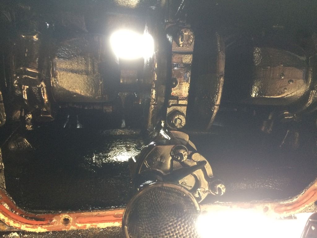

Hi everyone,
I took the sump off today, as suspected the piston and connecting rod was siting in the sump horribly mangled.
I'm not sure but I was going to try taking the crankshaft out to check for damage, it doesn't seem to have any major dents or cracks so I wondered weather if this is the case a new piston and connecting rod would suffice (maybe with a relining of the cylinder as well).
I wouldn't trust that crank as far as I could throw it! And anyway, sleeving the bore is not really cost effective on a 1500. And you'll need a new rod and piston(s) There are much better starting points out there. I'm sure if you put a wanted ad on here you'll get a result. It might also be worth checking ebay for a donor CAR, there have been a few roughish 1500s on recently for not a lot of money. And you get a whole car full of spare parts. But be warned, this is a slippery slope that leads to total Dolomite addiction.
