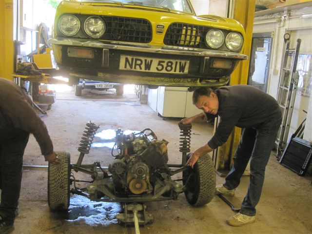

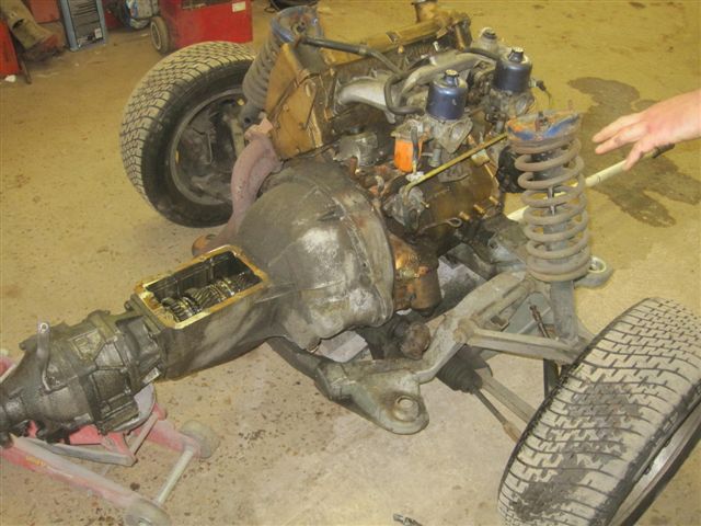

ST done mine last year, but they do have access to a lifting ramp,
Re: Oh %%%$ - Sprint engine broken?
#24 Post by Jon Tilson »
You can take it out the top but jack the back up so car is very nose down...which compensates for engine rising at the front.
Or drop it out on the frame...Robert does this all the time.
Disconnect the exhaust at the downpipe by the gearbox...not the manifold flange. Completely remove the g-box cross member and mounting
and support the box on suitable jack. Disconnect propshaft at the gearbox flange.
Other bits as has been pointed out. I take the hole clutch slave off with bracket to avoid bleeding.
