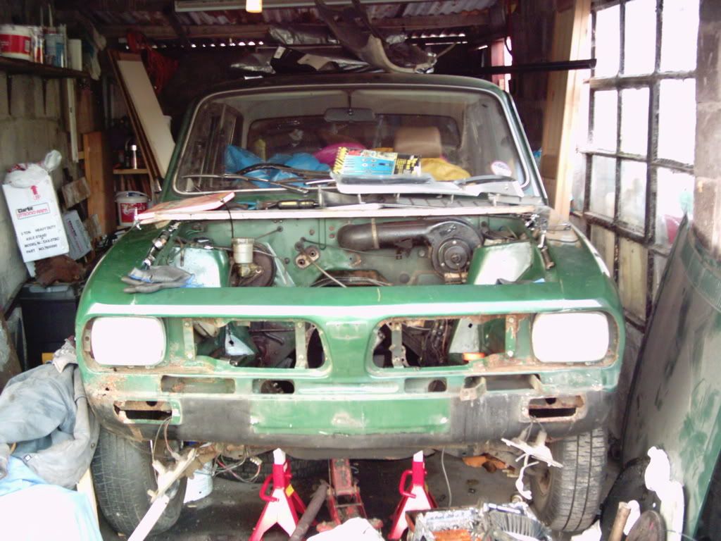

well feb08 is here and you will all be glad to know that porject zetec is still in the garage awaiting its new engine!!! time is a major problem at the minute. but i have been busyish. engine is ready to be dropped in. i'm using a escort 1.8 sump and pick up pipe on the motor and it just so happen that the sump fits perfectly in between the subframe. so motor will sit just where the 1300 did. i give up on making my own engine mounts plr did them for £55 so saved time. still having problem with gearbox tho.. hand brake will have to be moved and the floor will need some panel beating, the reversing light switch hits the tunnel!!! apart form that its all go. engine will be in next weekend promise.. anyone else thinking about a zetec then let me know and i'll try and help ya out..

engine is now in the dolly...sort off.. the engine fits like a glove between the subframe. just needs a tap here and there to line everything up.. as for the gearbox thats touching the tunnel so need to move that up to get the engine to sit levelish. i will be welding the tunnel back in for added strength as tunnel is gonna need a fair bit of work. apart from that very happy with the fit off the motor. all most looks like it came from triumph.

hi there guys.. yes project zetec is still in the garage!!!! its taken me way to long now.. so after going to stoneleigh i decided to get on with it.. had pay rise(5.25%) from ford's back dated from nov 08. so have a few pounds to spend. so i now have a starter fitted. i needed so it cant work out where the engine was going to seat. i've now had one engine mount up and all welded in. and i have had the other side ready to weld up tomorrow. the gearbox mount should be done by the weekend as well.
i've now changed my mind on the motorbike carbs and hoping to run just one dgas carbon a rs2000 manifold via a adaptor plate..should make thinking a bit easier and quicker to sort ie all parts are bolt ons. i've done shed loads off research online and it looks like i can run a early mondeo ecu to get it running.
apart from that it all systems go again. photos to follow..

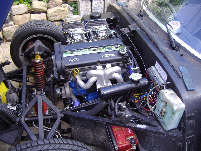

Sounds like you're doing a good job.
I initially scratched my head a lot over the exhaust manifold - most of the aftermarket ones gather the pipes together so that it can pass underneath the engine for a FWD installation.
It wasn't much use trying to shorten one of these, because the pipes didn't gather together into a single until it was already very low down.
An Ashley system designed for a Zetec installation into Mk2 Escort looked promising, but seemed to go too far back and was quite expensive.
One from a Ford Focus 115ps fitted nicely, and looks like a nicely crafted tubular bunch of bananas. They're quite common on ebay.
(I've moved the coilpack to the front of the engine and fitted a pukka Megajolt since this pic was taken, the wiring is a bit tidier now).
