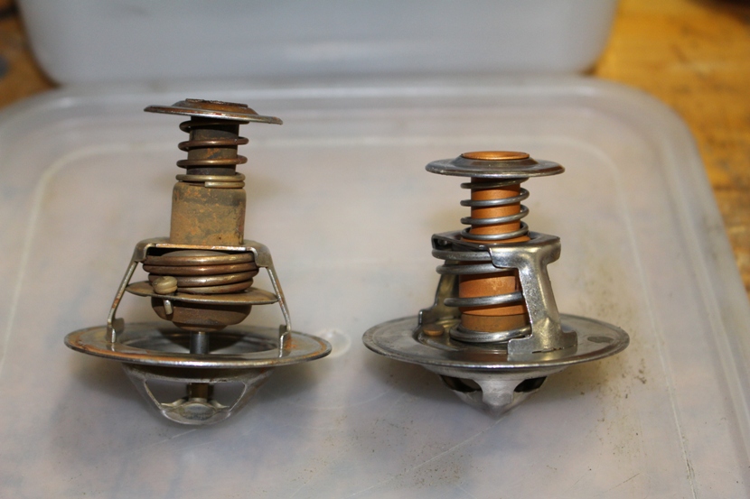

Maybe I've misunderstood but are you really running a Sprint engine with the thermostat removed? This will result in a lot of coolant being recirculated around the engine and only some passing through the radiator and the engine getting too hot as a result. No fan will compensate for that. The reading on the original gauge will also give an inaccurate reflection of what is going on. Leaving the thermostat out for an extended period (or using the incorrect type without the 'foot') will cause damage to the engine. The issues you mention about running rough may be a result of high internal engine temperatures. If you trying to determine temperatures, the IR temp reader is the only reliable source.
I stick to an 82 degree thermostat (check it if it is an old one). The theory is then that whatever sensor you are using to control the fan should come on at around 92-97 and go off at about 87. You should then be able to drive normally on the open road without the fan on, but it will come on quite soon after stopping or slowing right down in heavy traffic. Depending on ambient temperature it may stay on a while whilst stationary or cycle on and off until you get going and resume a natural flow of air through the radiator. As far as the fan is concerned, open the bonnet and put your hand between the fan and the engine. If you feel the flow of hot air, the fan is doing what it should.
On both my road cars, I now use a full flow fan controller that is infinitely adjustable and works extremely well. Maybe not the cheapest, but very good.
http://www.revotec.com/acatalog/Electro ... tting.html
I also have this and my fan wired through a NON ignition circuit so that the fan will continue to cool after the ignition is switched off.
The Sprint radiator is I believe a 3 core, whereas the 1850 and others are two core. I suspect over time some Sprints have been fitted with incorrectly re-cored radiators. On mine the Sprint core is as thick as the radiator frame, whereas a 'Dolomite' one I have is noticeably thinner. Otherwise there are various Saab, Porsche and other radiators that have successfully been used as substitutes and a search on this forum should bring those up for you.
Geoff
PS Photo of the correct thermostat, cold on the right and hot on the left - showing how the foot extends blocking off the re-circulation of the water in the engine

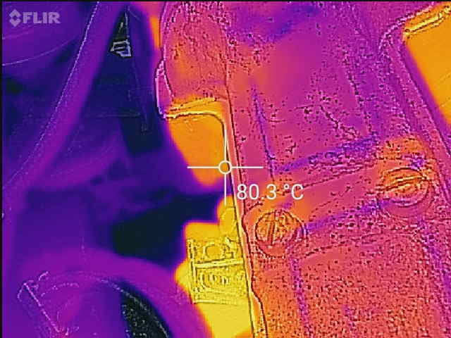

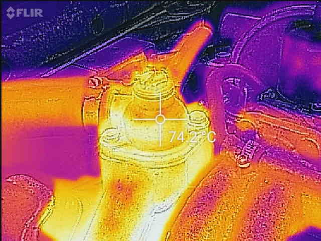

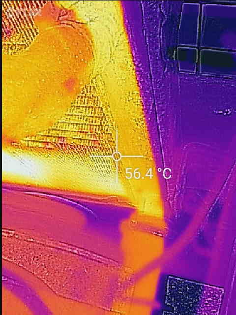

I have done some I.R. temp; measurements on my 1850 on the temperatures on the LHS, the RHS of the radiator and at the thermostat housing. There is a fair old drop in temperature across the rad; One difference though is that I'm using Evan's Waterless Coolant so I would expect the temperature drop with standard anti-freeze to be rather higher.GrahamFountain wrote:No restrictor plate. The point of taking the thermostat out was to maximize flow and reduce the higher temperatures, though I acknowledge it does that mostly by evening them out. That may account for the relatively small drop across the rad. I agree that the eveidence suggests its the rad that limiting the system.
On the basis that you reckon these temperatures a bit high, as do I, how have you measured them yourself?
Graham
This is with the outside temp; at 15 deg C., the temp; gauge reading 1/2 = 82 deg C at idle with the engine running.
L.H.S. rad = 80.3 Deg C
R.H.S rad; = 56.4 degC
Thermostat housing = 74.2 deg C. The reason that this indicated lower than the gauge is due to the emissivity of the housing being bright aluminium rather than the black of the rad; side tanks.
