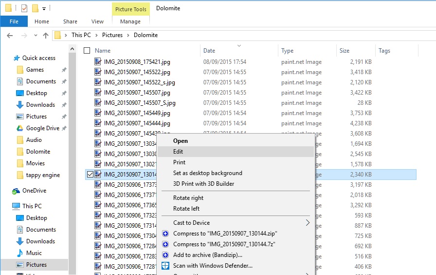

Re: Those flaking door cappings again

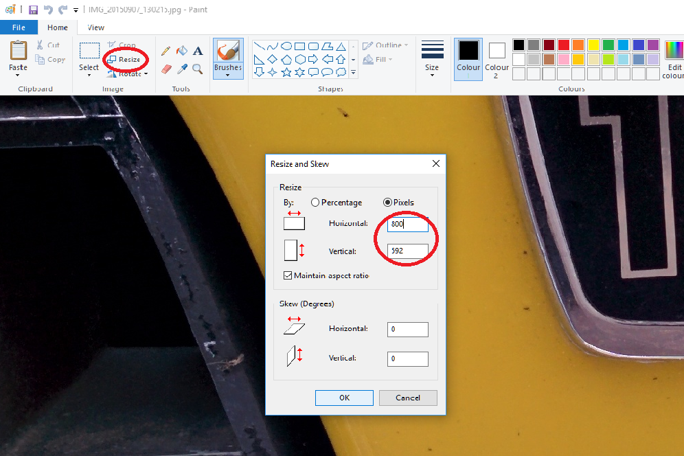

If you want to email me the photos (I'll send the address in a private message) then I will make them smaller for you and upload them, alternatively here is a quick guide:
This may help, but I only have access to Windows 10 right now, it will look a little different with older versions.
Go into Windows Explorer - Shortcut is press the Windows Key and 'E' together.
Find your file, right click and in the menu select 'Edit' or if that is not an option select 'Open With' and then select 'Paint'
When in paint, select 'Resize' and change the figures to those shown (a reasonable size), ensure that 'Maintain aspect ratio' box is checked.
Then most importantly do not click on save, instead click on "File" > "Save As" and save it with a new name ie. 'img35345_s.jpg' or 'Door capping small.jpg', you do not want to overwrite your original file!

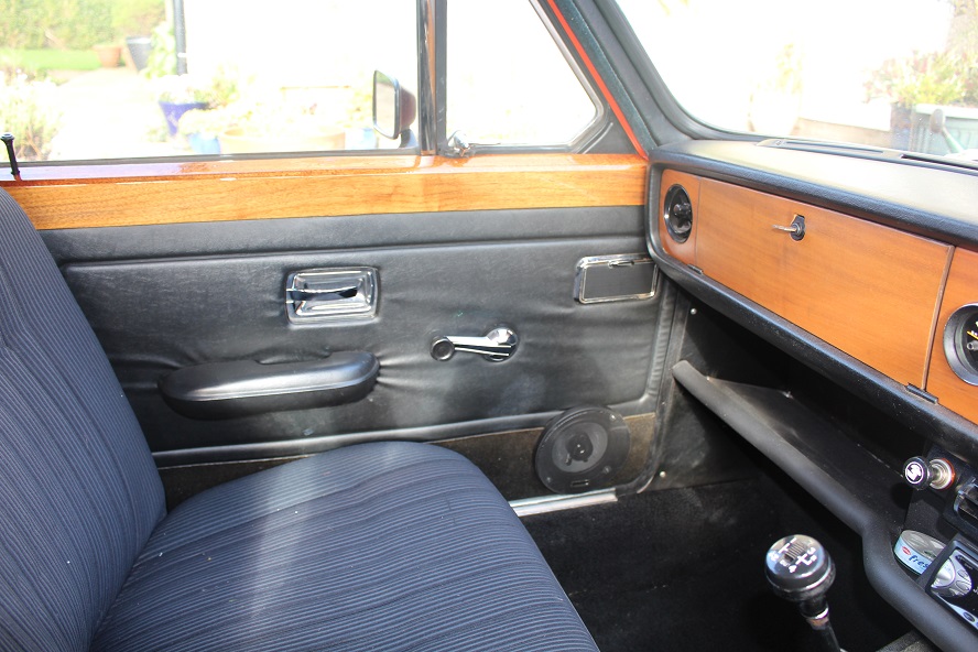

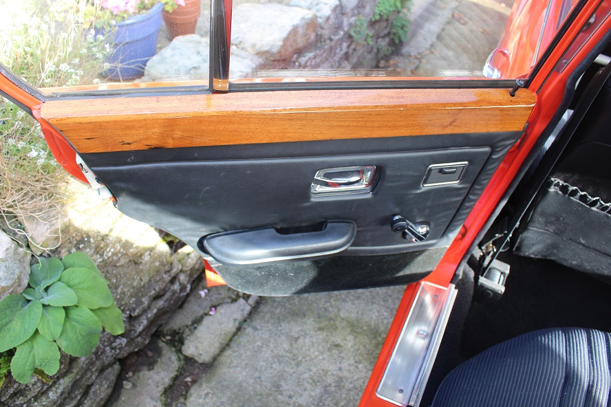

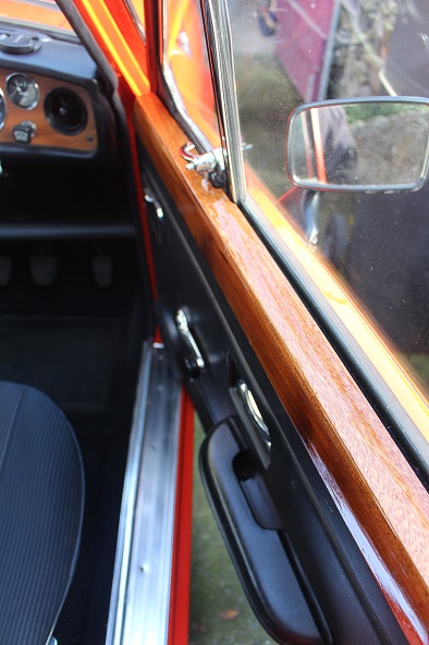

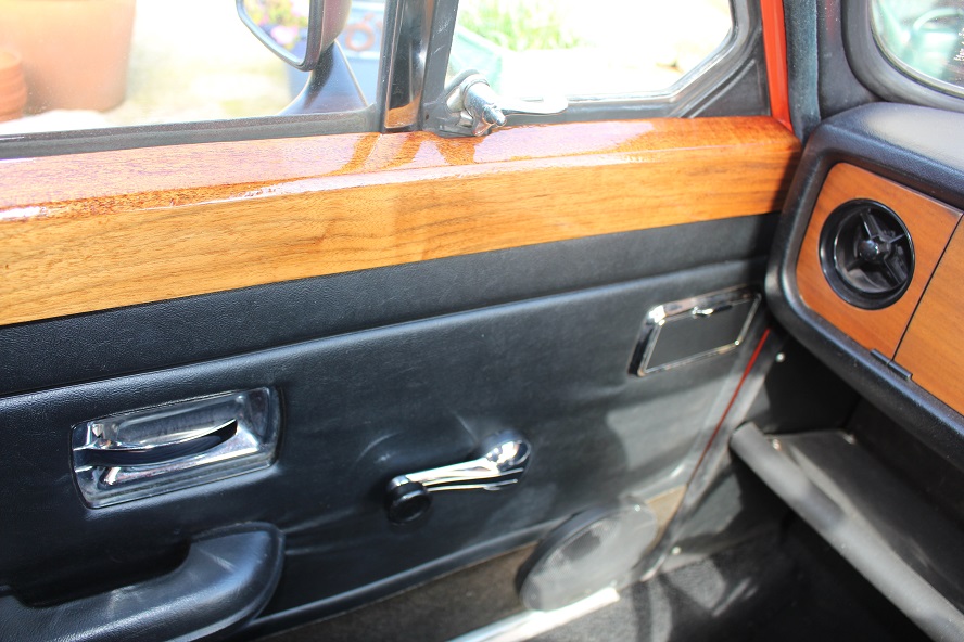

I am so grateful for the help I've been given. As Windows 10 had installed itself on my computer by itself, I was able to follow the instructions perfectly. So here goes.
You might even see on my door cappings where the heat gun has scorched one - however everyone thinks it's a natural feature of the grain so I got away with it.

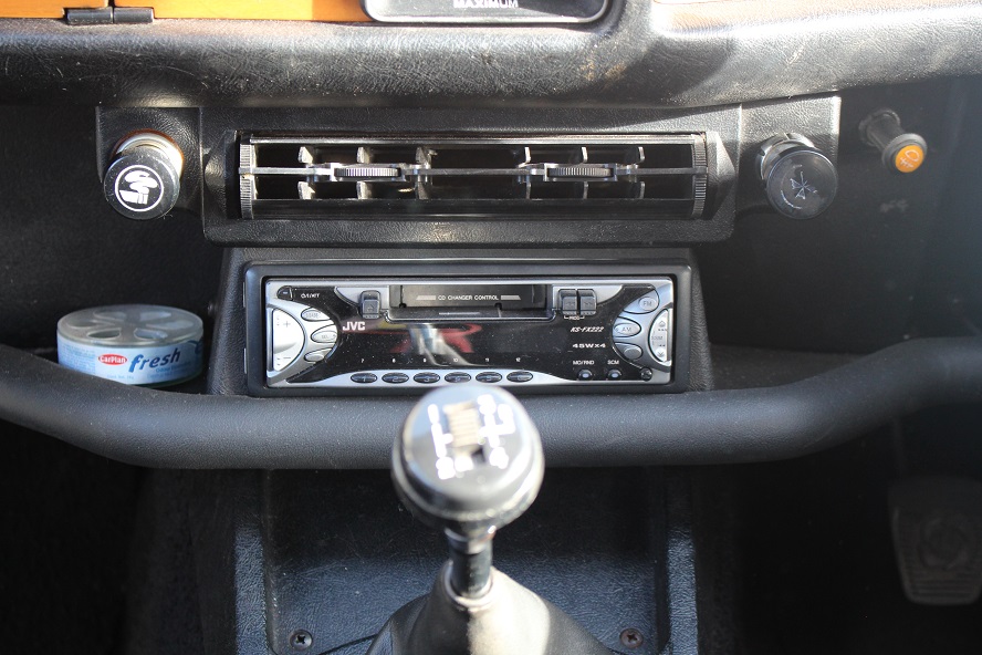

I've also enclosed 2 pictures of my ancient JVC music system (the changer is in a box supported under the parcel shelf; speakers are above and in doors. It handles cassettes, CDs and radio.
Also 2 pictures of my finished 1500 which was featured in the magazine 2 issues ago - it took 10 years (and £13k) to take from a scrap car to be finished.

Beautiful car and a great job, Sir!
Thank you for sharing your efforts with us. Is the wood stain as good a match for the original timber in real life as it appears in the photos? If so, I shall be using some of that on the cappings I'm going to re-veneer.
