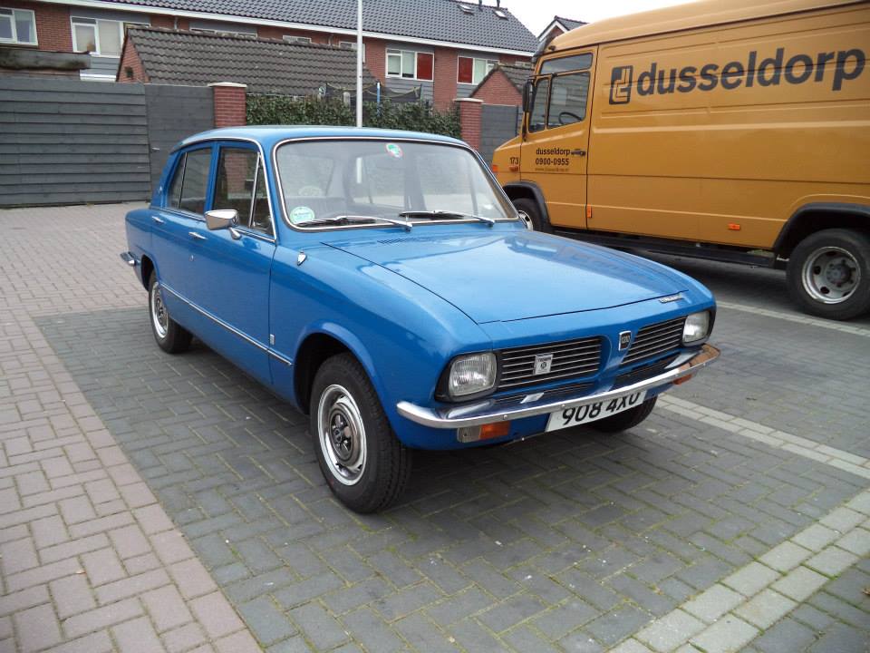

#22 Post by soe8m »
This nice 1300 is it. First paint.

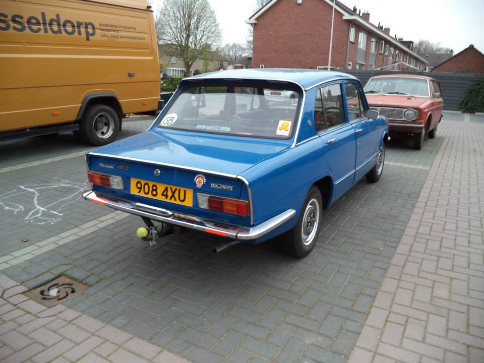

Do you not get into trouble with the Dutch police for incorrect spacing of the letters and numbers of your licence plate? A similar misdemeanor over here would likely have you in court, your reg number suspended and a new age related one issued.
Nice looking car by the way, are you intending to keep it looking stock?
Re: 1500 to 1850 conversion
#25 Post by soe8m »
It is illigal but once a reg is on a car it can't be altered. It is just a non approved plate like an old blue plate what does not belong on the car's age or letter combination. I can receive a fine that's all. But it's RHD and has GB on it and i was never put aside yet. With my ginger hair i just start talking in English first i suppose when im pulled over. 8)
It is the right reg number but a different spacing.

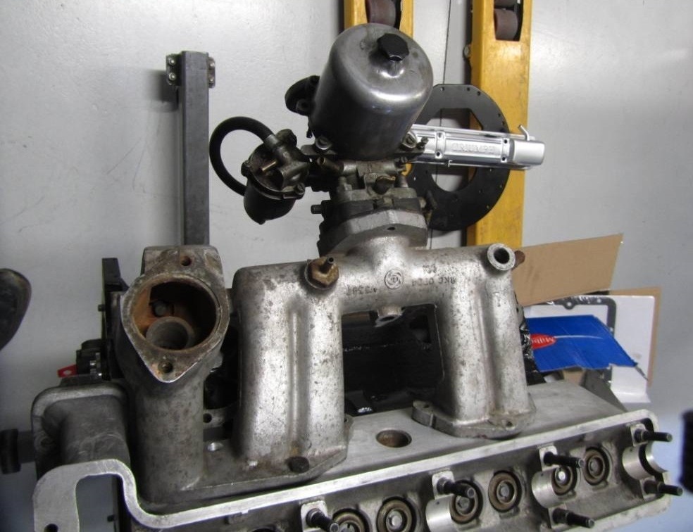

It will stay stock on the outside and for the underbonnet looks i also use one carb on the slant, a big HS8.
