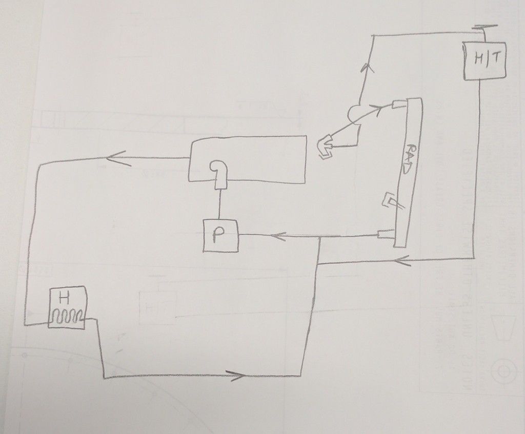

sprint95m wrote: Your heater plumbing is fine Shaun.
I don't see a radiator bypass in your diagram though.
There's no thermostat fitted Ian....Just an orifice plate to restrict the flow a little...

Why do you wish to restrict the flow Shaun?

There is a longstanding (laws of physics defying) myth that restricting the flow through the radiator helps with cooling...

sprint95m wrote:Why do you wish to restrict the flow Shaun?
To hold up the flow around the back of the head as there would normally be a restriction caused by the thermostat.
Now, if i put a line from the top rad spout to the thermostat housing, will the system work? Yes or no?
Alternatively, If that won't work, I'll need to do this....(just added a line from the bottom rad to the bottom of the header tank)...Yes or no?

You need an inline thermostat parallel to the rad. There is a topic with drawings about it. The overall conclusion was bin the electric waterpump and go conventional.
shaunroche wrote:To hold up the flow around the back of the head as there would normally be a restriction caused by the thermostat.
Surely that is illogical…..you are slowing the flow down and increasing the load on the pump :shock: .
shaunroche wrote:Now, if i put a line from the top rad spout to the thermostat housing, will the system work? Yes or no?
No.
shaunroche wrote:Alternatively, If that won't work, I'll need to do this....(just added a line from the bottom rad to the bottom of the header tank)...Yes or no?
No.
The answer is no because as Jeroen has already said, you need a thermostat.

Cheers for taking the time to answer Ian, I really appreciate it!
I understand, finally what you've done now with the remote thermostat.
However, completely ignoring the over cooling issue, from a flow and air lock point of view, will my last layout diagram work, because if I remember correctly, your layout worked, it just over cooled, correct?

shaunroche wrote:if I remember correctly, your layout worked, it just over cooled, correct?
That is correct.
