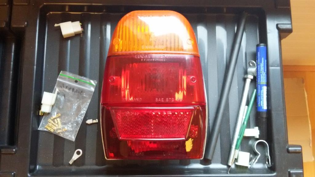

Re: PFX 37W Dolomite 1500 restoration
#18 Post by Richard the old one »
If you move the rear fog light from the near side to the off side you will meet the MoT requirements as I believe the requirement is to have at least one on the off side for cars of the that age. The wiring should be there as when new the car will have been fitted with two, one each side. The fog lights are fed via a short bit of loom from the main rear loom. Just a singe cable feed connector and an earth.
Russetauto
Posts: 65
Joined: Sat Sep 23, 2017 9:57 pm
Location: Camborne Cornwall
#19 Post by Russetauto »
Mandatory fog light needs to be from center of vehicle or to the offside. Just the one anywhere from centre line is acceptable. Check my MOT tester bs!! Lol

Looking really good, apart from the missing rear fog lights :lol: You will remember that drive for a long time :D
#22 Post by soe8m »
One of my customers wanted an extra fog lamp and i did spray one reverse lamp red with translucent red paint. Fitting a red bulb behind a clear glass will have a pinkish glare, not the bright red of a foglamp.
