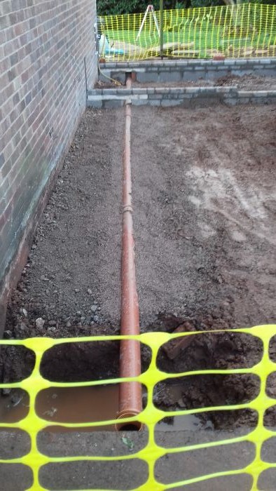

I will have an Aco drain along the front of the garage. This is the pipe to take the rain water to the rear of the house to meet up with the existing drain.

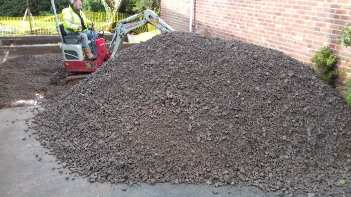

18 tonnes of type 1 stone arrived this morning...

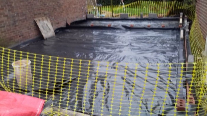

Yep, just concrete. I don't know if this is standard prep or not, I guess it is.
Thanks Nick.NickMorgan wrote: ↑Thu Oct 10, 2019 1:42 pm Excellent! One of my favourite restorations on here at the moment!
The sand is to blind the top of the aggregate, so that it doesn't puncture the polythene damp proof membrane that will go on top before the concrete. As you say, 150mm/6" is standard for a garage floor. A142 reinforcing mesh is always worth adding in the concrete of a garage floor (it's in stock at most builders merchants), ideally about 50mm up in the concrete, for which you can buy plastic feet. Type 1 is quite expensive to use as a base material for concrete, well compacted hardcore is acceptable, and we often use crushed material which can be bought quite reasonably.RSi wrote: ↑Fri Oct 11, 2019 12:50 pm It's exactly what I had to do for my garage 9 years ago - 'Type 1' compacted solid but no sand, don't understand that part. My concrete is 8" deep and 2 layers of reinforcing but that was only for fitting a 2 poster ramp at a later date if I wanted, without the ramp thingy it would have been 6 inches of concrete on top of the type one.

I stand correctedGlenM wrote: ↑Fri Oct 11, 2019 9:20 pmThe sand is to blind the top of the aggregate, so that it doesn't puncture the polythene damp proof membrane that will go on top before the concrete. As you say, 150mm/6" is standard for a garage floor. A142 reinforcing mesh is always worth adding in the concrete of a garage floor (it's in stock at most builders merchants), ideally about 50mm up in the concrete, for which you can buy plastic feet. Type 1 is quite expensive to use as a base material for concrete, well compacted hardcore is acceptable, and we often use crushed material which can be bought quite reasonably.RSi wrote: ↑Fri Oct 11, 2019 12:50 pm It's exactly what I had to do for my garage 9 years ago - 'Type 1' compacted solid but no sand, don't understand that part. My concrete is 8" deep and 2 layers of reinforcing but that was only for fitting a 2 poster ramp at a later date if I wanted, without the ramp thingy it would have been 6 inches of concrete on top of the type one.
