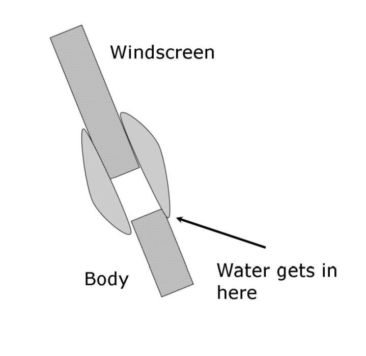

As the original poster I thought I ought to let you know what I found. No corrosion I'm pleased to say, but a problem with a new windscreen. Have a look at my drawing.
The new glass is a tiny bit too small for the opening. As a result the rubber is sealed well around the glass at the bottom of the screen, but is only just overlapping the body surround. The rain creeps up and under where my arrow shows and drips inside from the lower edge of the rubber seal. I have got some Arbomast screen sealant and have injected as much as I can into the offending area and hopefully that will stop it. I haven't had a chance to try it yet.
- Rain leak.jpg (27.02 KiB) Viewed 1717 times

Though not ideal you could go along the bottom of the rubber with a block of wood and rubber mallet and tap the rubber down very slightly to centralise is a bit better and get more overlap on the body, go very gradually otherwise you risk going too far and exposing the bottom edge of the glass. If you run the sealer up under the rubber first then when you tap the rubber down a little it should squeeze the sealant ensuring a better seal.
I have found over the years that windscreens of all cars vary quite a lot in their overall size - presumably due to tolerances in the manufacturing process and also variations between manufacturer, - they can vary more than enough to cause this sort of issue. When fitting screens and rear windows I always go round and check that the rubber overlap on the glass and the body is centralised - especially on screens that are "undersized". The worst screens are the ones that are tight, they cause much buttock clenching as you see the glass flexing before it finally slips into the aperture. Best fun are 1950's Standard Vanguards, split screen, single moulded rubber, fitted from inside the car, sit centrally on the bench seat and place feet firmly against the two halves of the glass, then push hard and pray!

Of course I didn't fit the screen myself. The original was cracked so the insurer arranged for a new one to be made by Pilkingtons in the correct tint of glass and it was fitted by National Windscreens in just about half an hour. It would have taken me hours and then I probably would have cracked the new one knowing my luck. Cost to me just £70. I think I will just leave it for the moment. My drawing exaggerates the problem somewhat. Squidging the Arbomast up and under seems to have stopped the leak. It hasn't seen any serious rain yet, although I have poured buckets of water over it this afternoon.

I wouldn't leave it at that, the screen has either been incorrectly fitted or the rubber/sealing strip is defective.Bumpa wrote: ↑Sun Dec 15, 2019 4:21 pm Of course I didn't fit the screen myself. The original was cracked so the insurer arranged for a new one to be made by Pilkingtons in the correct tint of glass and it was fitted by National Windscreens in just about half an hour. It would have taken me hours and then I probably would have cracked the new one knowing my luck. Cost to me just £70. I think I will just leave it for the moment. My drawing exaggerates the problem somewhat. Squidging the Arbomast up and under seems to have stopped the leak. It hasn't seen any serious rain yet, although I have poured buckets of water over it this afternoon.
So the fitters should either rectify their mistake or the company that supplied the defective parts should.
I had mine done by a local firm and used a new rubber and sealing strip and it is sealed perfectly. You shouldn't be having these problems and since they are the professionals, they should rectify their error.

Ah, but it was fitted in my garage nearly two years ago, before the car was ready for the road. They didn't supply the rubber, I did. And their depot is up in Glasgow, not very handy for me. So I don't think I have much grounds for complaint, nor the will to try.cleverusername wrote: ↑Mon Dec 16, 2019 5:36 pm I wouldn't leave it at that, the screen has either been incorrectly fitted or the rubber/sealing strip is defective.
