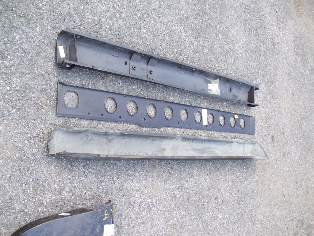

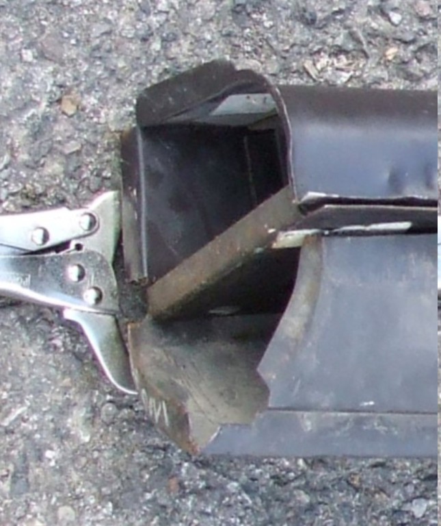

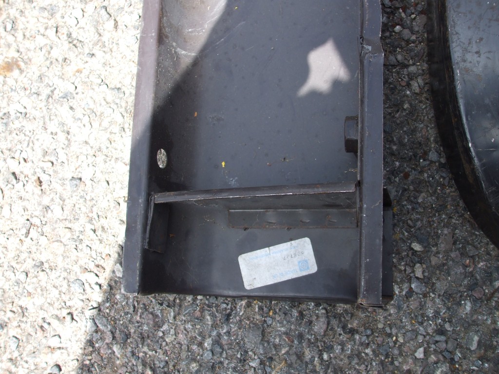

Further to James explanation of the jacking points structure these photos may help visualise the structure:
The sills are made up of three main parts, inner, centre diaphragm (referred to as the sill reinforcement in the parts books) and the outer sill (top photo):
Each end of the inner sill as shown in James drawing has additional reinforcement (middle photo) which when fitted together with the remaining sill panels form a box (bottom photo), shown here without the wheel arch panels.

- DOLOMITE 135
- Posts: 122
Re: JGU - 'Nina' 1975 Primrose Dolomite (Pre 1850)
James,
One query regarding the way you have welded in the inner sill repair panel, I can only see plug welds and short weld runs attaching it to the original structure in your photos, I assume this has been fully seam welded later on and this has not been shown.
The reason I bring this up is for clarity not as a criticism, so please do not take it as such. If people use your posts to guide their own repairs they may or may not realise that plug welds are only acceptable on seams that were originally spot welded, and any non original joints should be continuously seam welded along their entire lenght in order return the panel (as near as possible) to it's original design strength.
